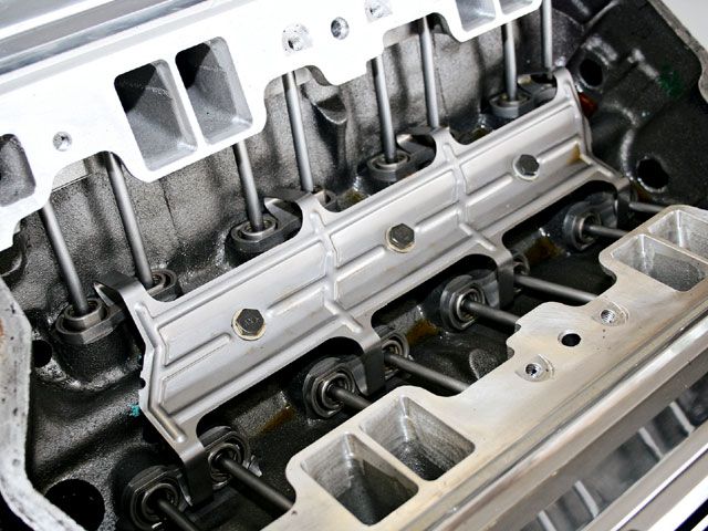

Did block have the bosses for the tin lifter alignment AKA spider? Engine look like this by any chance? If not, there is a big part of the problem. Lifters could be spinning in lifter bore causing the tick and not so slowly killing the cam.

The block was roller ready, I saw the lifters and cam in there when the engine was built. It takes some little kit to keep them in track or something, it definitely wasn't a slap in and play setup.
I don't know about the rocker nuts, I wasn't the one who installed everything, they did leave the covers, intake and oil pan off for me to inspect, they always did this for new engines as they had a lot of guys that wanted to recheck the torque specs before final assembly.
The block didn't have that tin plate, but whatever kit was purchased to use the roller lifters utilizes those bolt holes.
