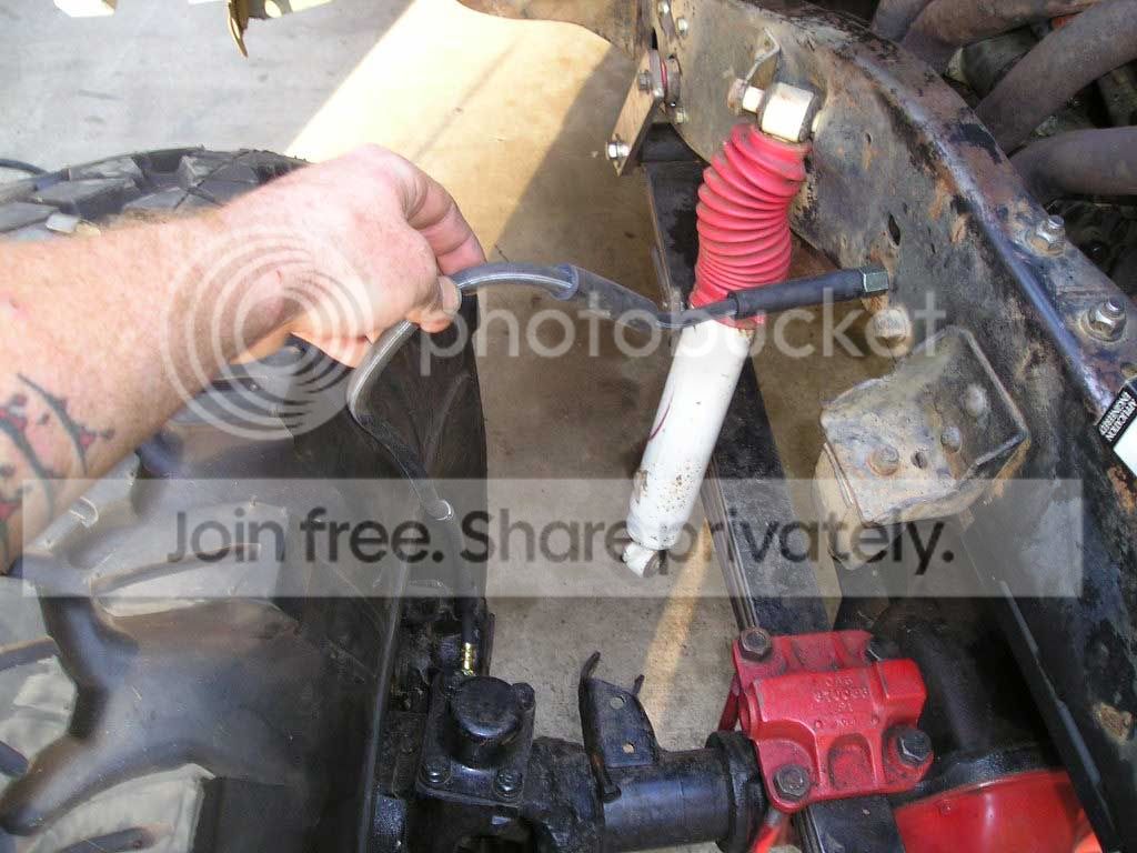

I used Napa part # 380295 on my 60. I think thier somthing like 34" long. $26.99 each. I think the application was for a late '90s Dodge Ram 1/2 ton. I can't really remember. Out of the box, they have a wierd lookin metal bracket on the hose that needs to be cut off, but otherwise they work fine.
