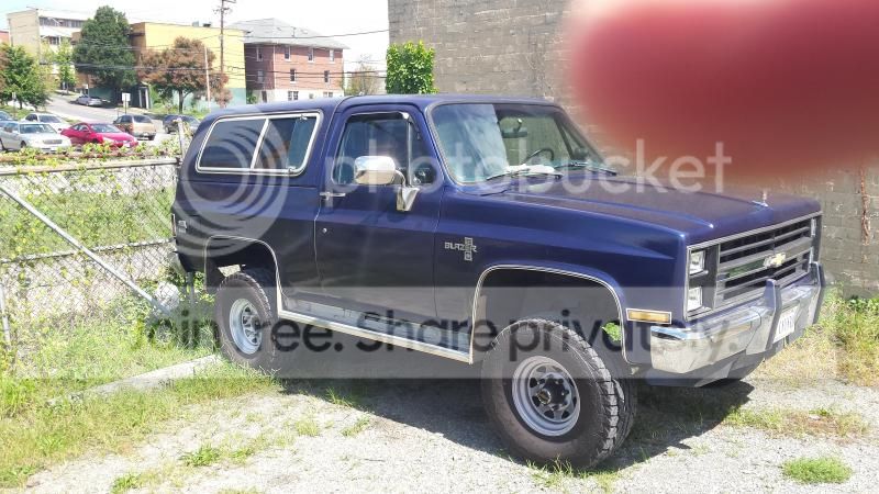

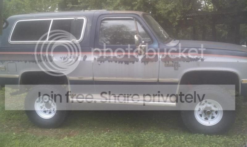

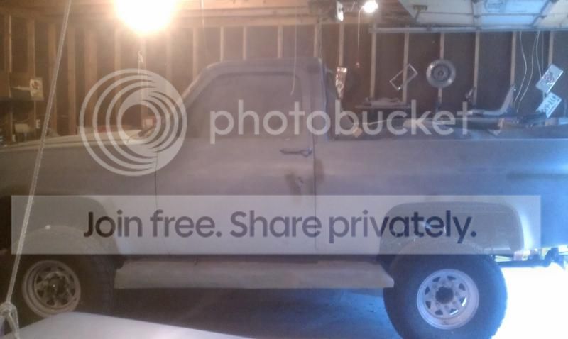

Here ya go, before and after paint, just ignore the finger in the photo...
The second picture was taken on an incline. Near as I can tell, it sits almost perfectly level. The general rule on blazers is to go an inch higher in the back for lift, particularly when using factory springs, because the heavy top causes a little sag in the rear. Depending on the condition of your springs and your axle setup, there may be some variance.
Lift--3 inch front, 4 inch rear, Tuff Country EZ-Ride springs
Tires--Firestone Wildpeak AT, 33/12.5/15
Wheels--Crager 15x7
Axles--Corporate 10 Bolt and 14 Bolt SF (1.5in Spacers)
Thanks for the pic! I like way it sits and understand weight thing (hope soft top doesn't throw it off to much when I get time to install). First pic paint is almost like mine but scared to get get a quote on a decent paint job. Thanks again Brandon
