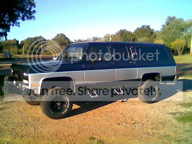

I'll sell you my '90 GMC Suburban with all of that stuff done already for $6k. It does need a paint job as the clear coat is blistered on the hood and top. ZERO RUST! It's been converted to 3/4 ton, Jasper engine w/warranty remainig, trans rebuilt 20k ago, front and rear air. power everything, but seats.
Looks nice same color layout as my 89 but I am in Oregon would cost me a grand to take off work plus gas just to get it, just for laughes barn door or tailgate?
