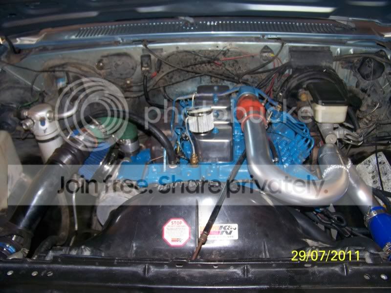

heres a couple picks for you folks that are curious...
