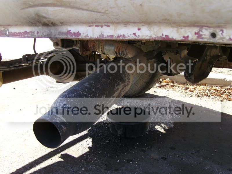

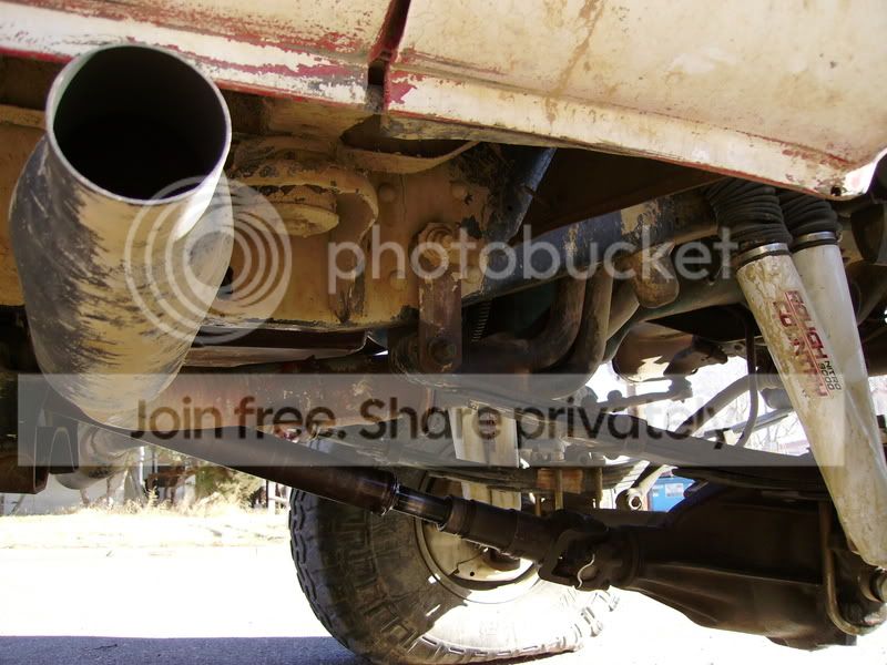

As far as duals being in the way, its all in how the exhaust is designed. Here's my duals though i made it myself the 1st pic is of the right side 2nd pic is of left side.
I ran my headers then dumped the exhaust right in front of the tire. Not saying this is how you should run yours but i had no issues with my duals and it completely unbolts from the headers with 3 bolts if i really need to drop my exhaust, hardly any hassle and simple to me. Hope it helps.
