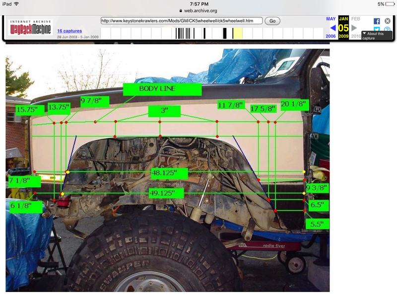

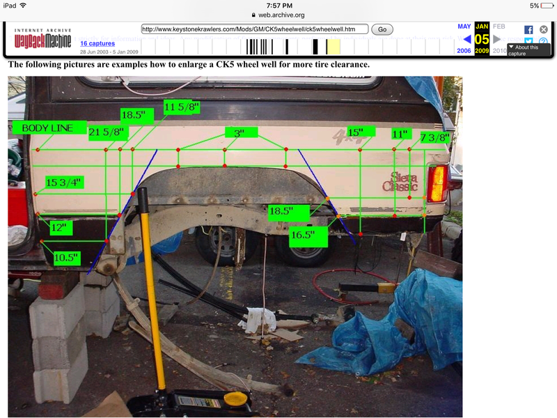

These cut maps are the basic shape / look I wanted but the cuts were a little bigger than I was willing to do as the front completely cuts out the liner attachment spots. These were posted by an old member named Yunit, his intent was a Blazer with 6” lift and 38’s. I don’t know if he ever finished the project.

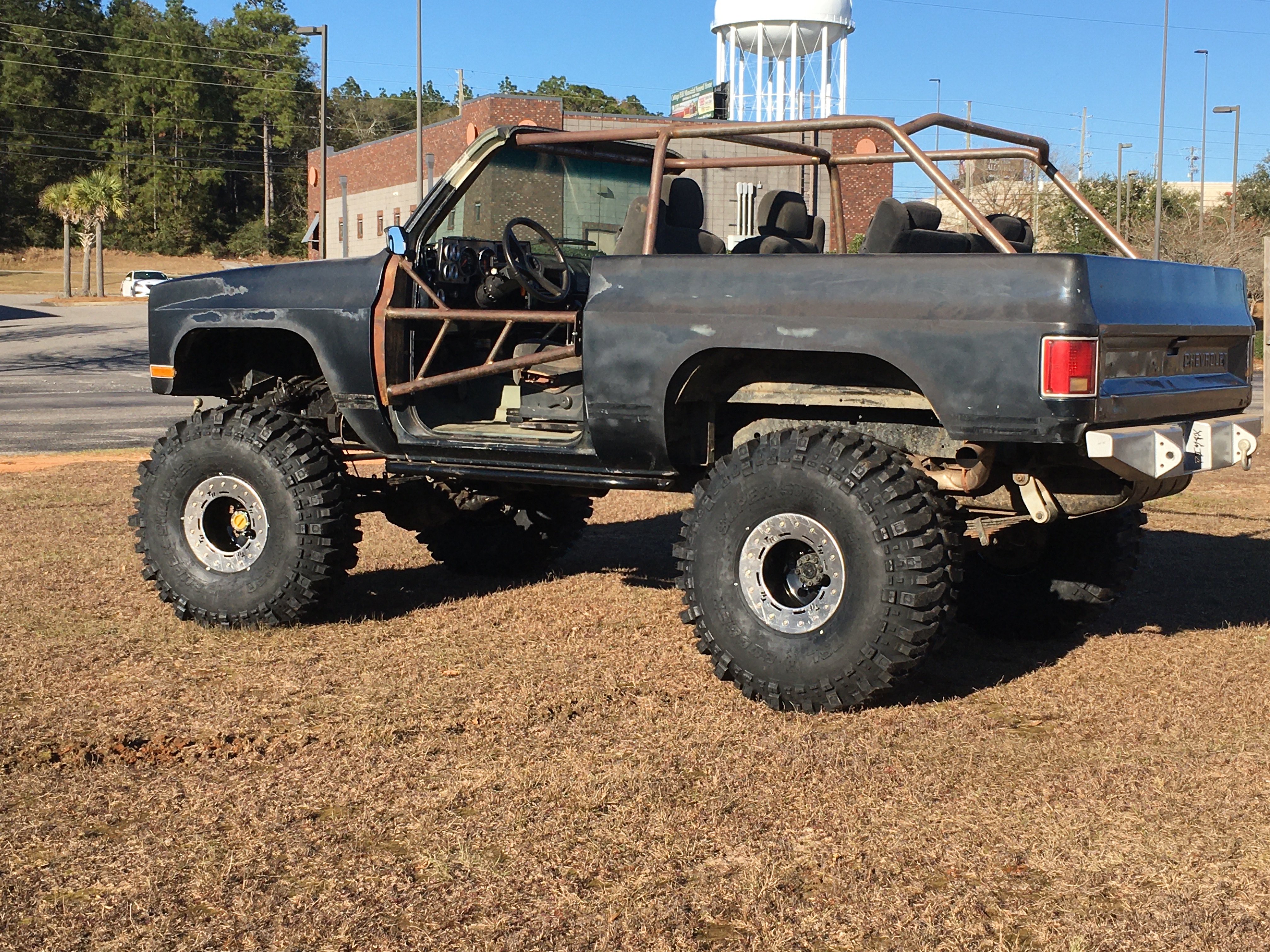

This is my Blazer with similar cuts but I just eyeballed it - it’s got 7” suspension, 1” body, each axle is moved 3” towards the end and 43’s. (it now has 40’s with the same lift)

None that are a good, straight on side shot to really show the cuts. I wouldn’t mind lowering it maybe 2” now but I’m not willing to cut driveshafts etc so it is what it is. The 43’s rubbed a little so I’m hoping the 40’s won’t touch.
