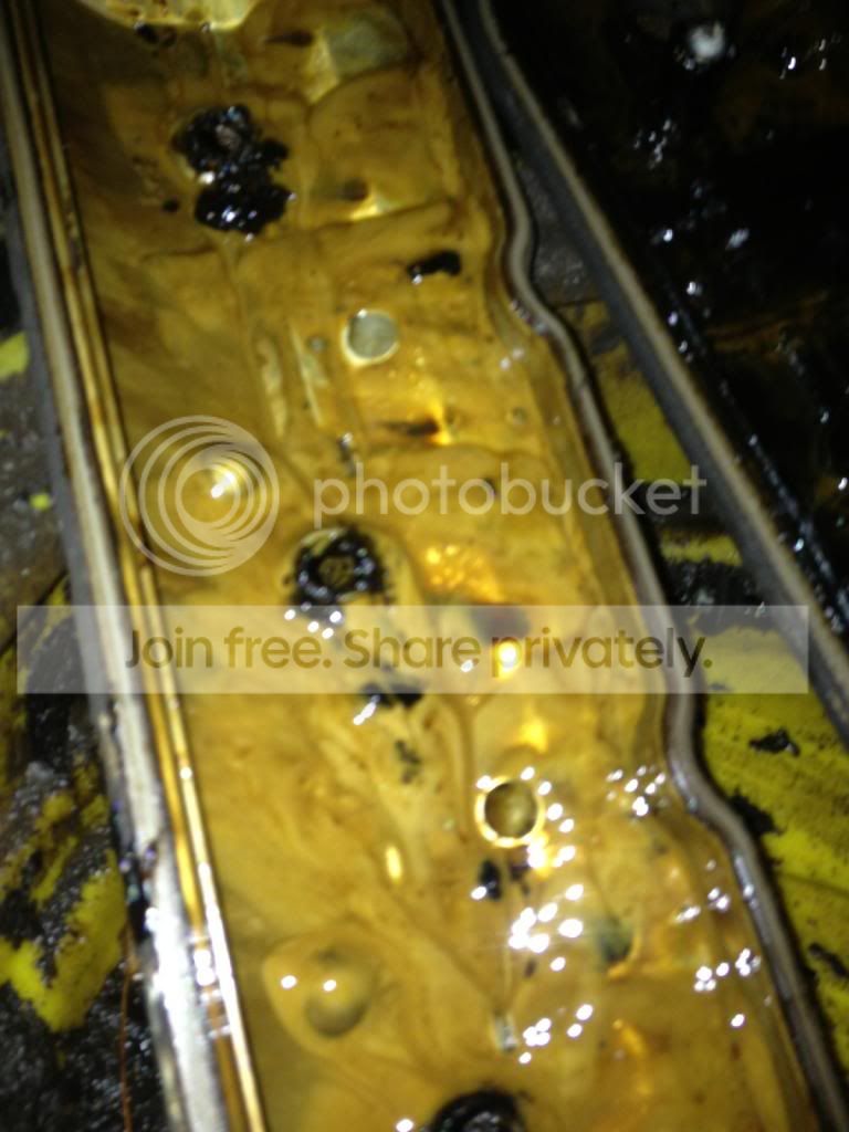

So me and 63chevyII picked up this 5.3 core recently. Wasn't completely sure of what the issue was. Dude said he hardly maintained it. Came from a 2002 c1500. 218K
upon valve cover removal...
Thought wow... this ones gonna be wasted....

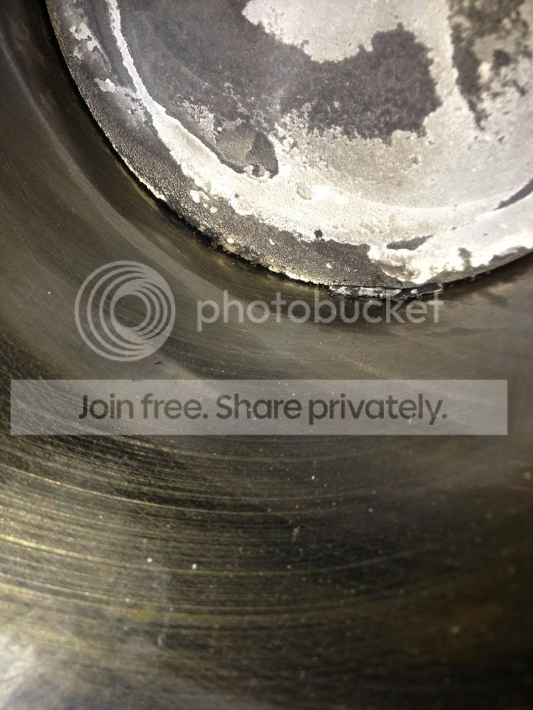

but upon head removal... The cylinders look amazing! still crosshatching all the way around the bore. NO ridge.
-ditching the 706 heads.
-having crank checked
-new bearings
-hone
-new rings
-cam swap?
-rework stock harness
Put it in something... GO FAST!
Its actually just build up. I cant believe this engine ran. Even.good engines aren't immune to dip sheet owners
I saw a post on one with bad intake gaskets that had been dumping coolant in the oil. The owner had been adding 1/2-gallon a week. The oil/coolant mix was actually coming out of the throttle. Apparently it cleaned up OK and ran fine afterwards.
I saw another one where somebody left a rag under the intake manifold on a 3800. There is a balance shaft in there that had shredded the rag all up, but the engine still ran.
