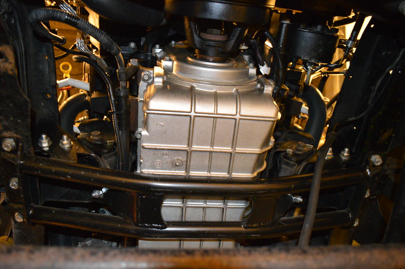

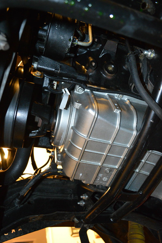

This is how the ORD GU32005 -Big Block crossmember looks installed with 8.1L’s, which has a much bigger oil pan than a Gen III “LS” engine.

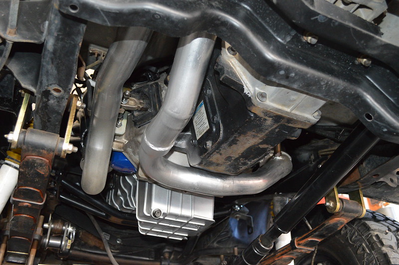

Suburban with Energy Poly engine mount inserts in OEM clams. Can’t see the oil pan clearance in this phone

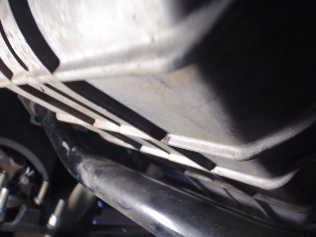

A little better view of the clearance. This one is the K10 with 8.1L, ORD Xmember and same Energy Suspension poly mount inserts

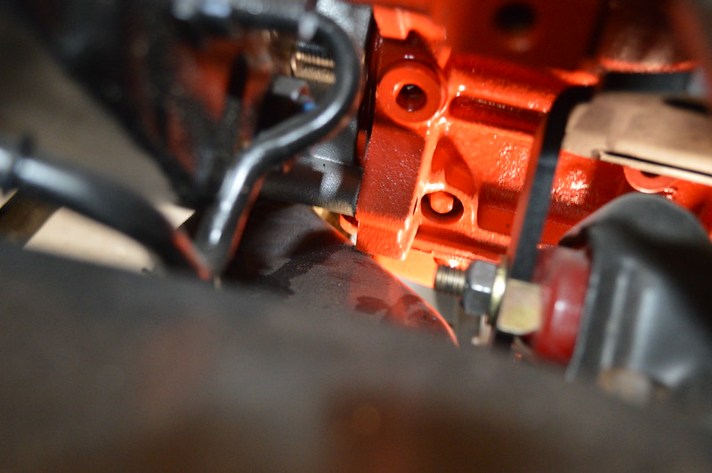

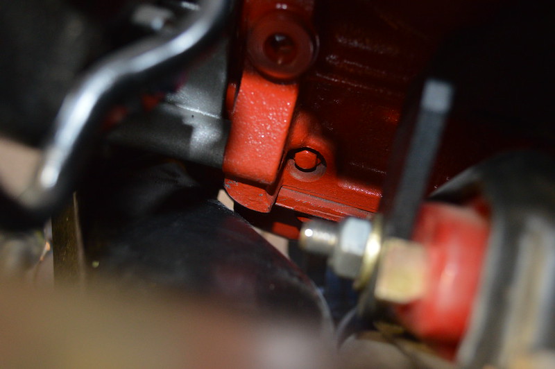

An example of a “LS” engine with the OEM xmember in a 91 K5. Interference between the block and xmember near the P/S pump
After a lot of elbow grease with a hand file. My arm still hurts over a year later. This truck also used Energy Suspension poly inserts in OEM clam with Dirty Dingo engine mount bracket as you can see in the photo. Love those mounts. Very heavy duty with practically zero engine harmonics emitted into the chassis unlike most all of the competition type engine mounts.
