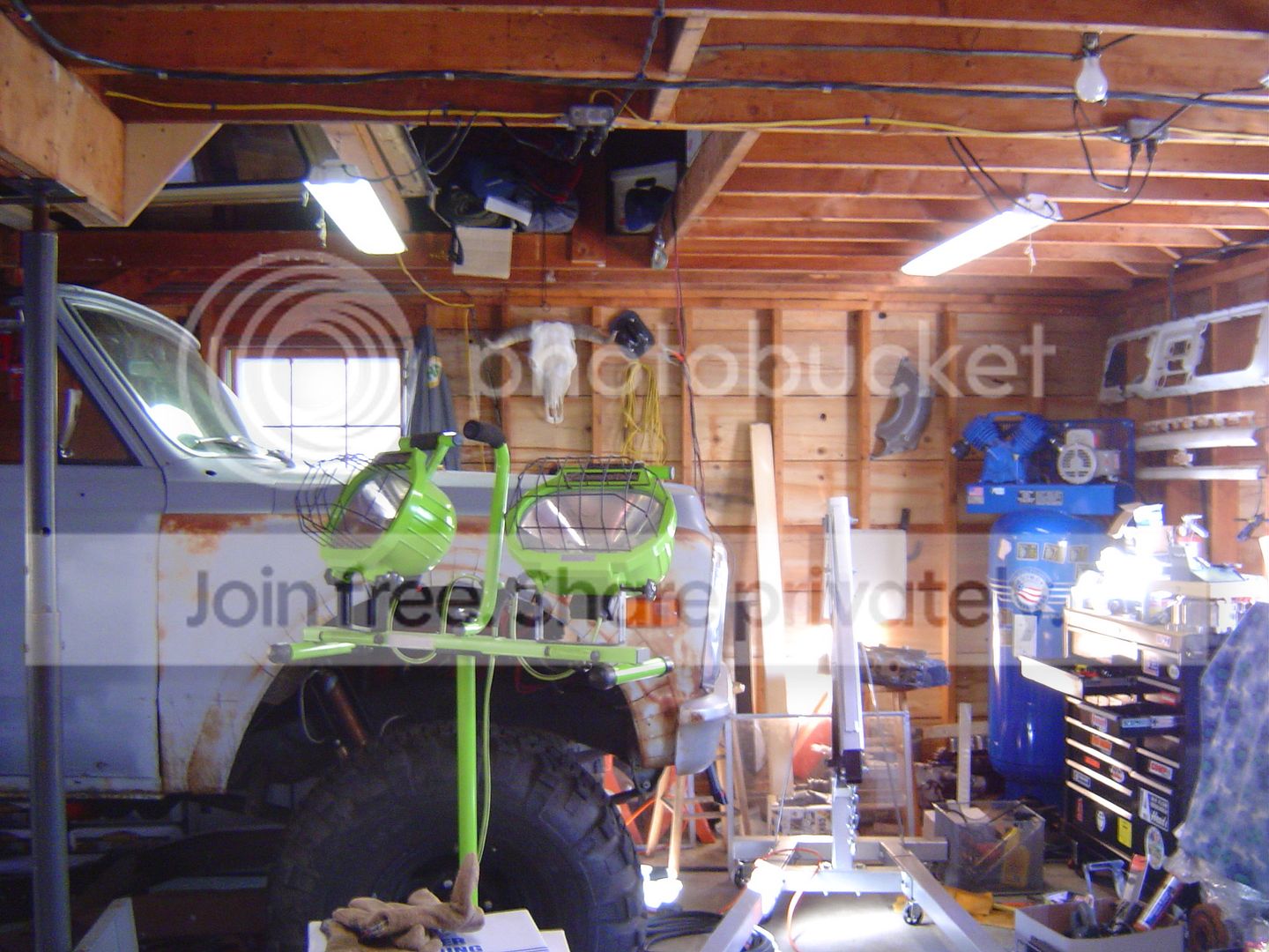

As you can see from the first photos, my workspace is a total mess. This makes for a really hostile environment to try to do productive work. Step 1 was backing the truck out and moving as much material into the driveway as feasible to create to elbow room.

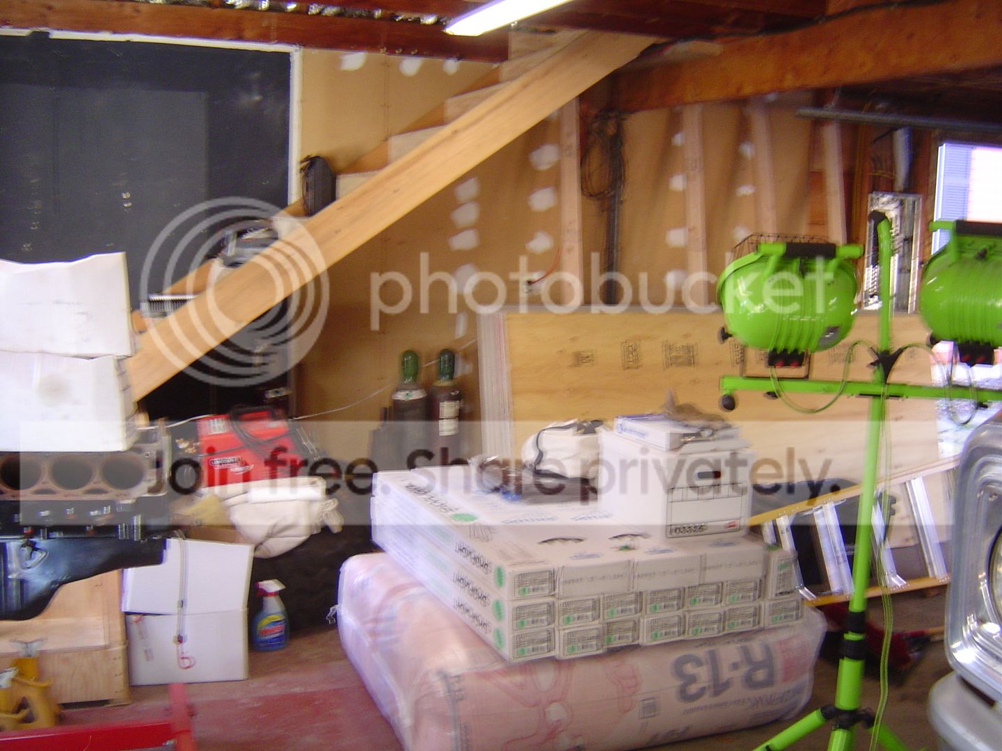

The first pic is a shot of the left-side parking spot. It has an opening above it where I am currently storing my hardtop.
This is a shot of the right-side parking bay. The staircase was built recently to give me more convenient access to the storage above this parking spot. It has already proved to be a Godsend....my workshop would be a LOT more cluttered if not for this area. All it needs now is some decent lighting up there to make things a bit easier to find. Sorry about the fuzzy pics....my camera blows.

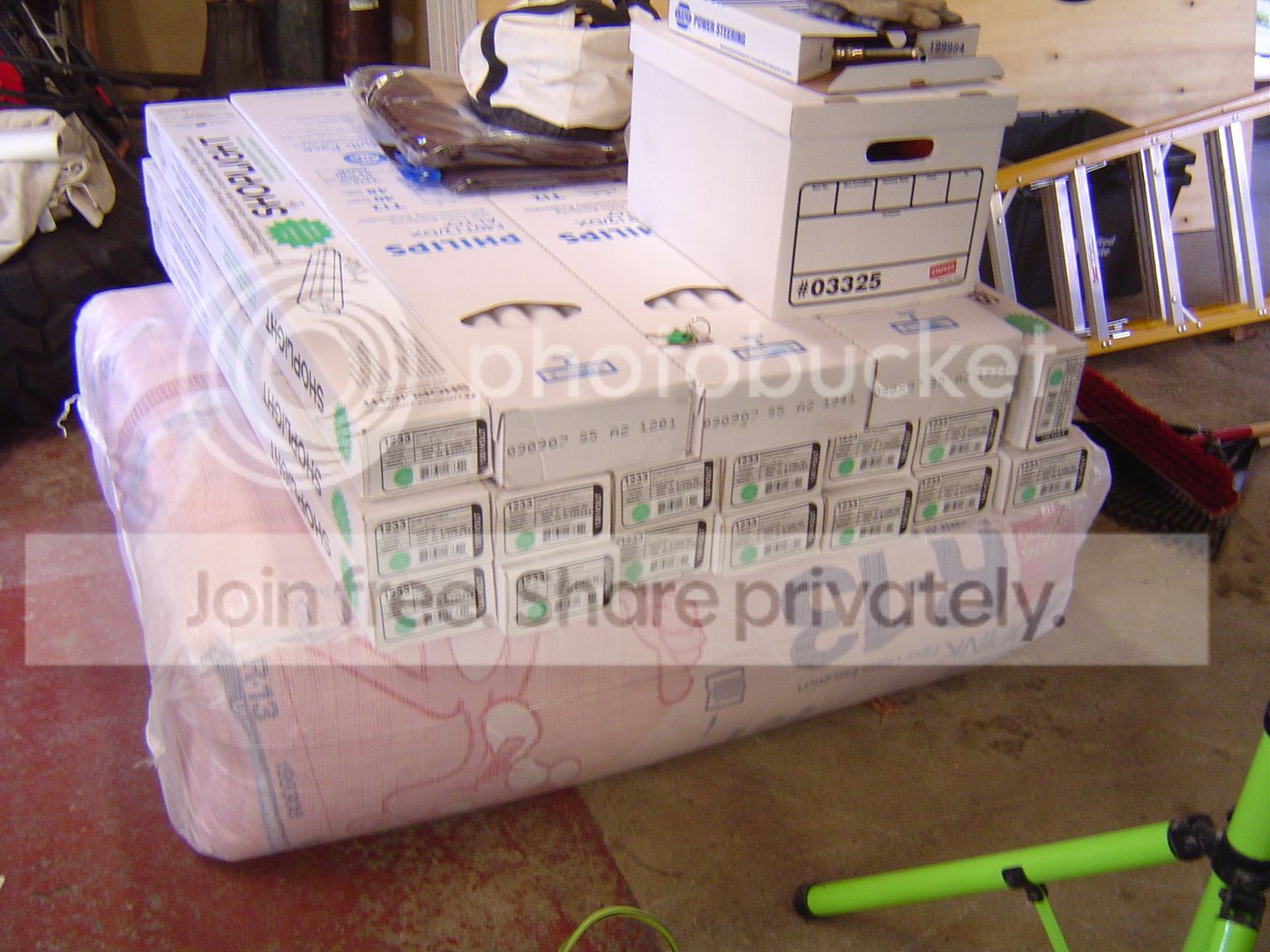

Materials for the job. 15 flourescent lights and a hugely-compressed package of insulation. Just cutting the woven outer bag caused it to explode to about twice the size pictured here. Cutting the individual bags causes them to explode to about 4X their original size. As you can see, I'm also buying bulbs by the case for this project! 6500K color temp....who knows? Maybe that will be nicer than the warm bulbs I've traditionally used. (~3500- 4500K)

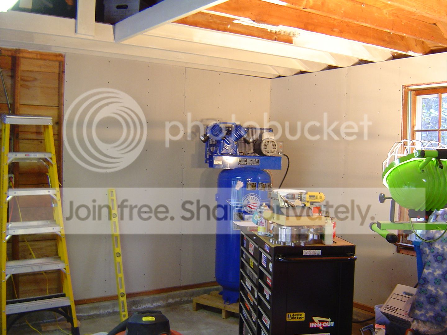

The problem with this process (other than the huge mess to trip over) is that I need to accomplish a number of things simultaneously. I need to insulate the walls before adding the sheetrock, and I need to run wiring for outlets before I add the insulation. That means drilling holes and snaking Romex all over the place too. This is all I was able to accomplish in a single day of work. Insulation, wiring and drywall 8 feet in both directions from the corner. Not bad considering what needed to be done....but if it keeps going this slowly, I'm going to be at this for a couple weeks.
BTW -> The wiring is inside those walls and the outlet locations are marked for "retrofit boxes". I had to make a trip to HomeDepot to get more, so now all I need to do is cut the holes and pull the wires through the openings and wire them up.

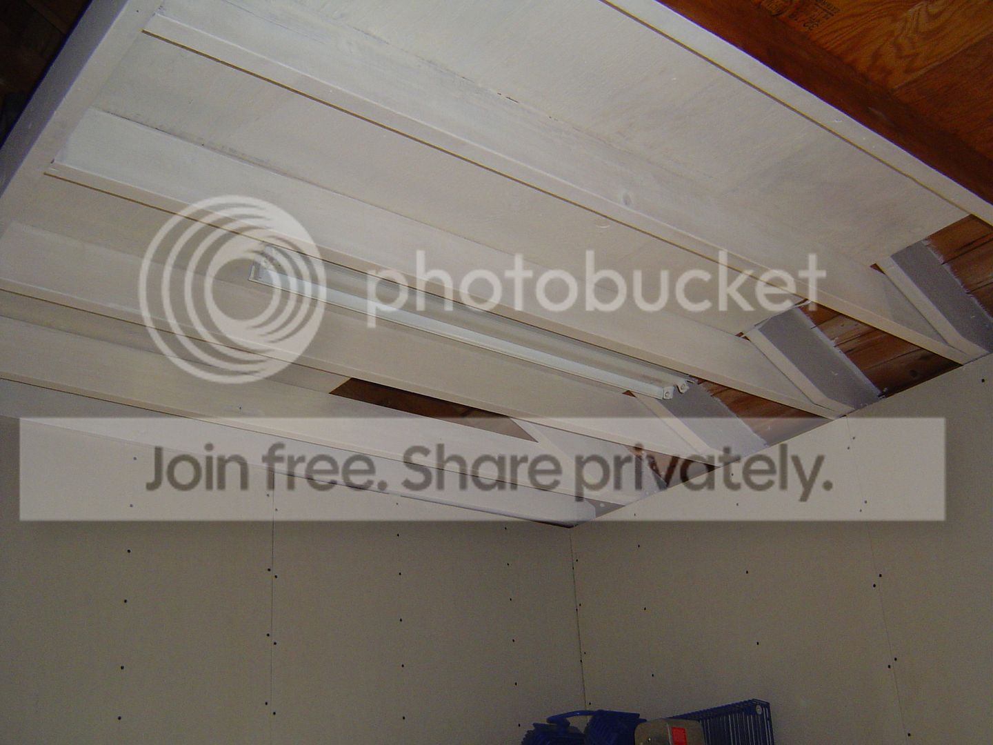

Finally, because all the wood is so dark (ceiling) it really soaks up the light...I've already experienced this with the current lighting. I've got 5 4-foot flourescents and it barely lights up the place. I decided to paint the ceiling beams with Kilz but due to the low temps (around 50 degrees) it took forever to dry, and the color kept bleeding through... I'm probably going to have to go back once I have heat in the garage and re-paint everything to make it truly "white". It does make things look a lot cleaner though...

6500 is a cool almost true blue light. whats the CRI on those lamps? you go two bright and things start to look funny. my roommate thought he needed the bighter coolest light in the kitchen and now the water looks yellow in the white sink.
