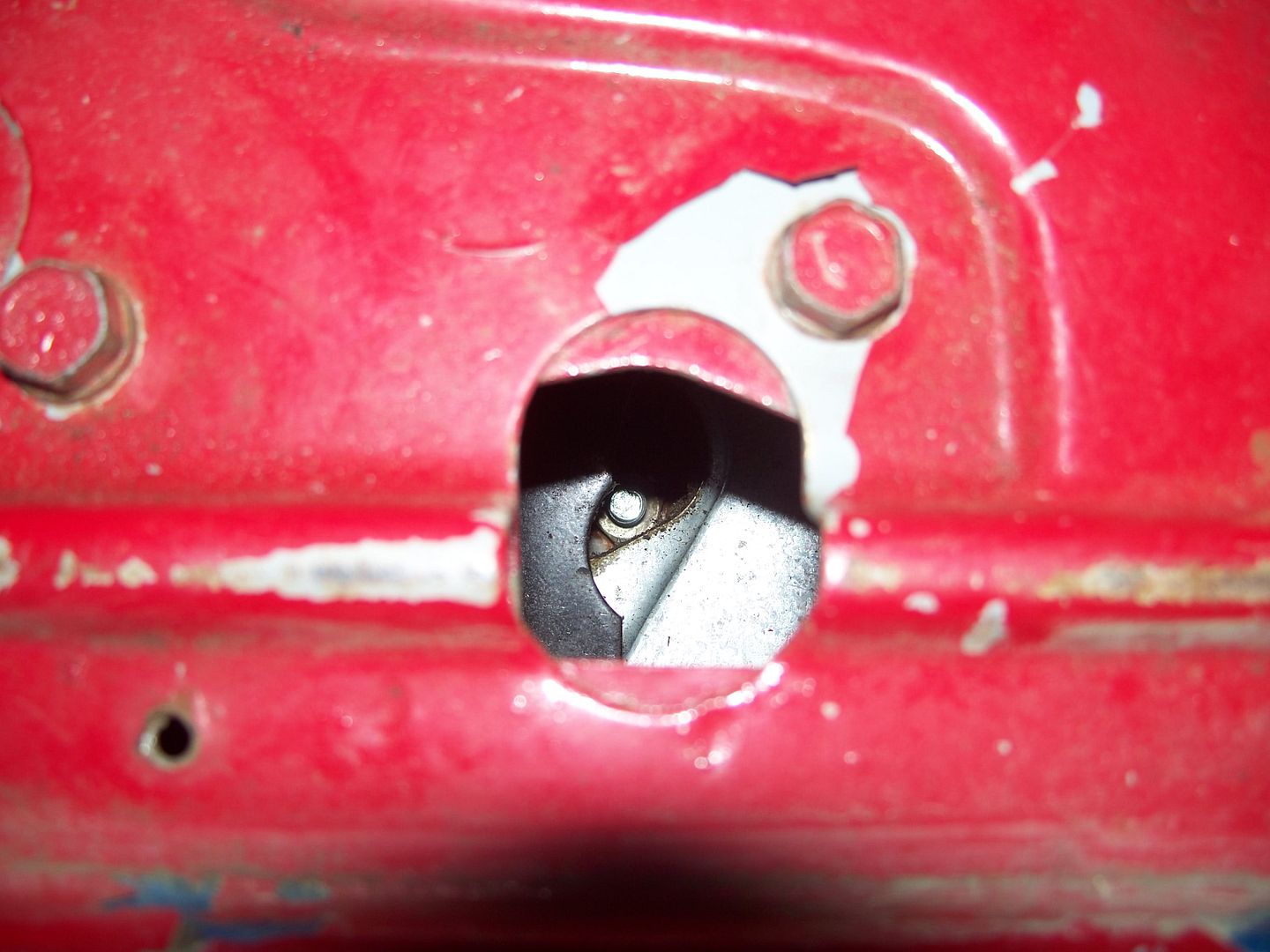

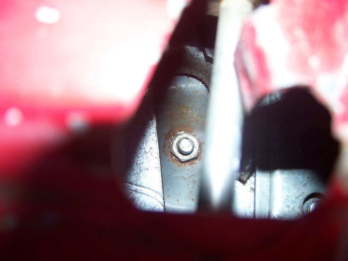

Ok, so I was able to snap some pictures. Hopefully they show what you need. I do know, looking at it now and remembering back a few months, that I was using a 1/4" drive socket with the 3" extension, then adapting to 3/8" drive because I did not have any more 1/4" drive extensions. The 1/4" drive made it so there was enough room for the socket to get a good alignment on the nut. I also used some paper between the nut and the socket to add just a bit of resistance to keep the nut from falling out. The window was in the all the way up position, but may be past where it usually stops when the gate is closed. You do need to have something there to support the window. My shop/bar stool worked great for this purpose.
Anyway, here are the pictures:
Driver Side
Passenger Side
Thanks for the help guys, i think I can get it now. btw swart, i really like the paint scheme on your k5
No problem on the pictures. I am glad to help. I had everything apart already so it really took less than 5 minutes to do.
