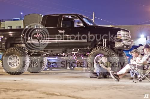

My friend was running 46's baja claws with a 10 bolt........
Yeah, he bought if from a dealership. He came up to work to show us, first thing I said was thats gonna break. Was not 2 months and it broke.:D
Broke it twice then went to a 14b SF...it broke also. He wised up and is now in the process of ripping everything out and running rocks.
