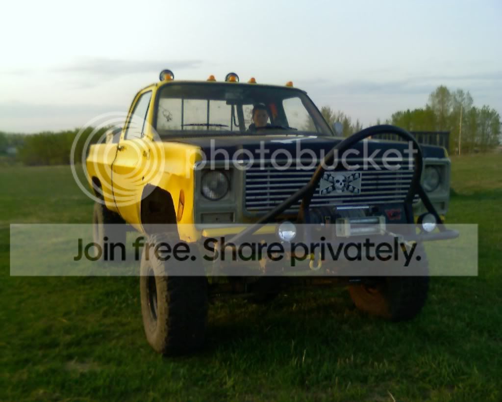

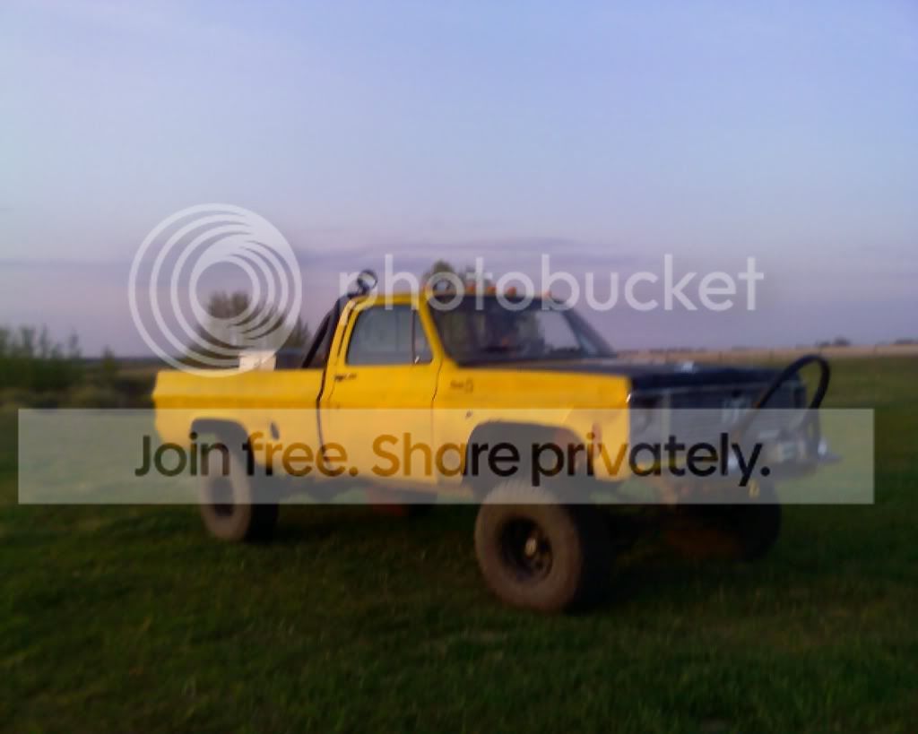

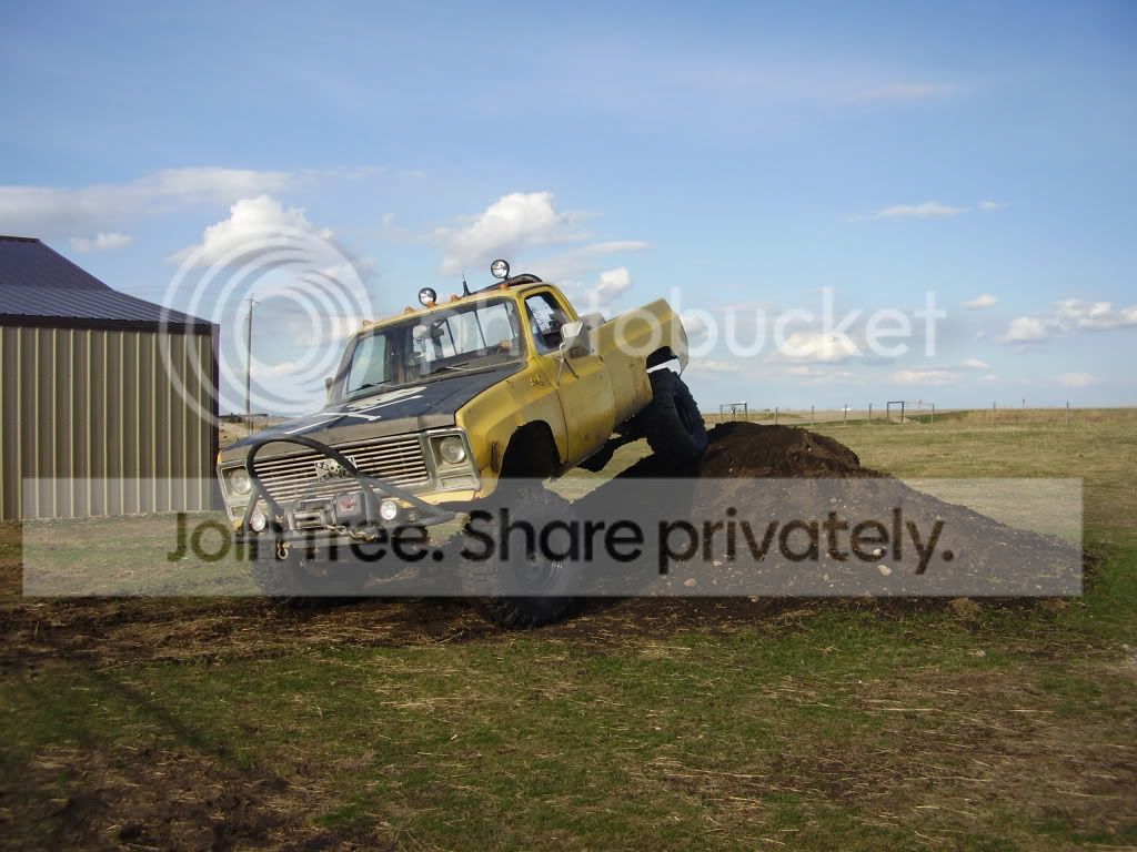

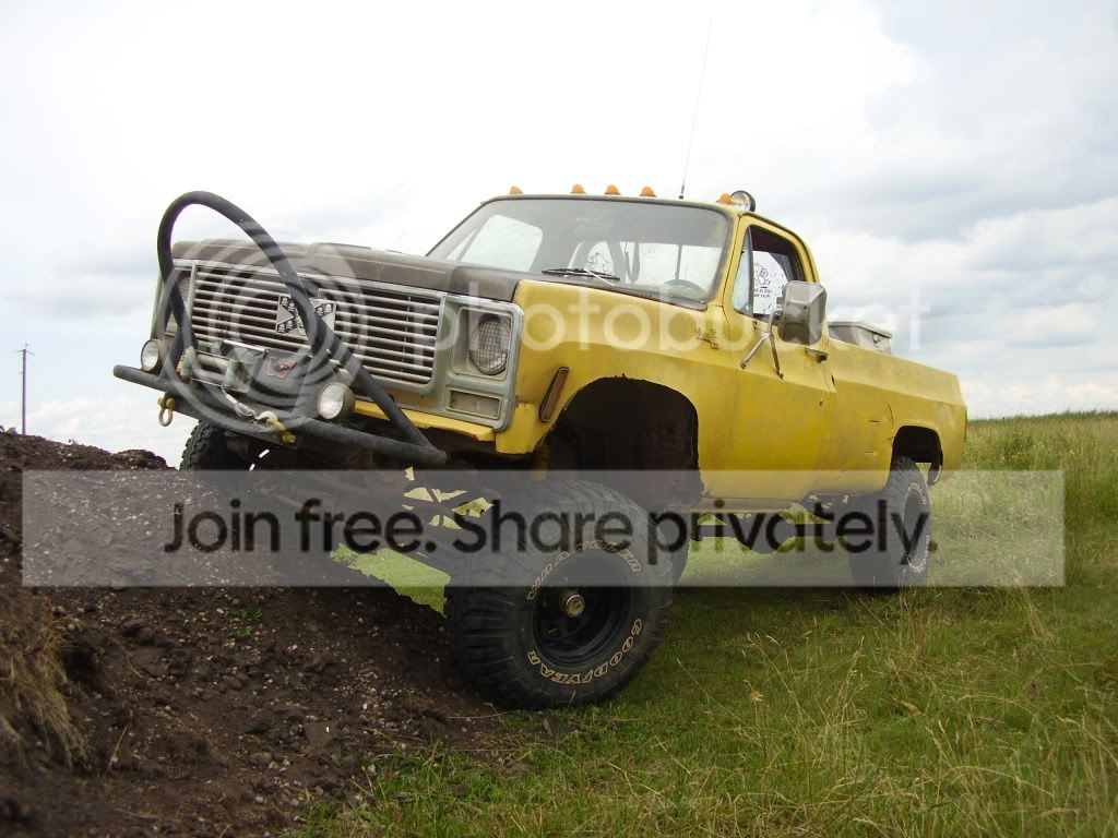

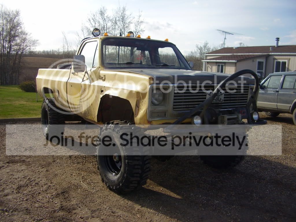

I'm running 37's on 3" lift in the pics below.
This is with the same suspension but I added a 1" body lift.
Must see pics of this. I have a set of 39's here and want to put them on my blazer that has 2.5" rancho springs, 1" body, and cut outs. Wondering how much more i need.
