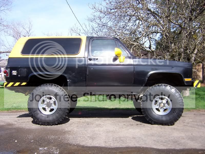

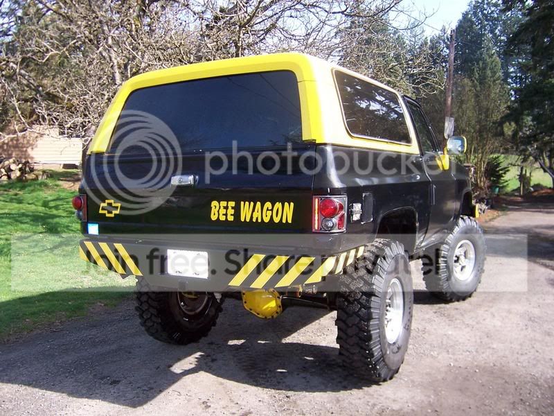

Jeesh, dat's a biggun!
howdiy, what do you think of the XZL's?
I have wheeled the xzls and driven them just a bit. The set I used was worn a bit they drove fine, if there is hardcore wheeling in your future grooving the tires would help a ton. On the rocks out here they don't work that well. They are super hard

Thats just a pictrue I took from the gallery. Can't help sorry.
