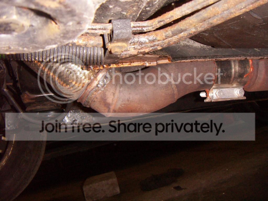

Well, here's what I got. Not pretty by any means, but they appear to be attached.

Or am I overthinking this? That flex joint I posted above has been fine so far and I didn't do any special prep.
