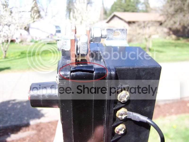

Has anyone had or know of anyone that has had issues with the Mile Marker SI 12,000lb winch being a piece of CRAP?? Out of the 4 times I have tried to use mine it has failed on two of them. I had a cracked solenoid the first time and now the small feedthrough on the side has cracked and the wires came out. These seem to be a very crappy winch. Just wanting to get some feedback from anyone else that may have some input. Thanks

The first one that I received at the door had a side heat indicator feed through that is made of plastic that was busted. I drove it back out to the shop and then had to wait 2 weeks for the new one to get to the door. I got the new winch after that and the first time I used it it stopped about half way in.

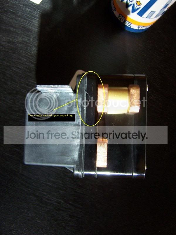

Turned out to be a cracked solenoid.
I called the warranty department and they said they would ship me out a new solenoid. This one showed up about 2.5 weeks later and had a freaking crack in it! Also had a tag attached like it may have been an old one sitting in the warehouse. Not the crack is in the exact location where a wrench would apply pressure to the case while tightening the cables on... USED AND RETURNED???

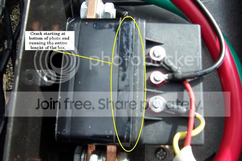

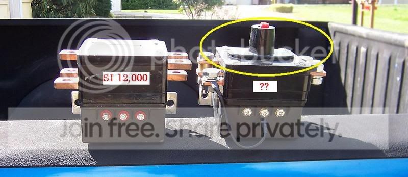

Called them back and sent them the above pic. The warranty department then sent me a new solenoid. After 3 more weeks of winch down time (total 7.5 weeks) I got this in the mail. The one on the left is the one I needed, the one on the right is the one they sent. What the hell, it grew a nipple for my application? I don't think so.
This is the funny part.... Notice that crack in the part when it arrived... Even if it had been the right part for my winch it wouldn't have worked with a crack so damn big you can place a penny inside of it!!!
