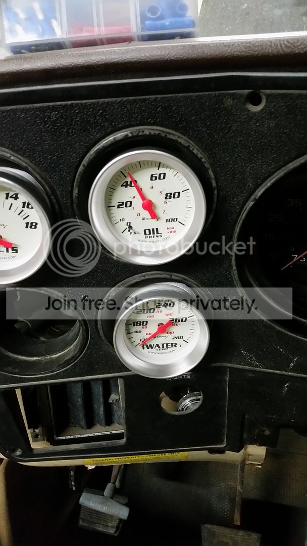

Bought a cheap set of gauges at the part store. Just stuck them in the factory holes for now. Might change it up at some point. 40psi of oil pressure at idle. Didn't run it long enough to see if the thermostat worked. Alternator also charges.

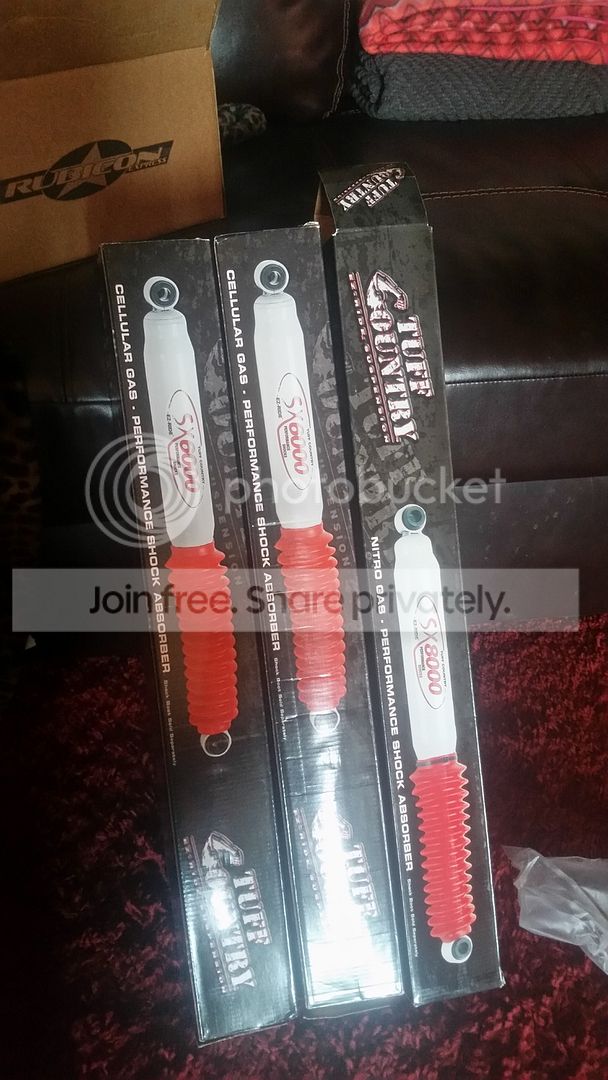

Big shout out to ORD. Only two weeks later and my shocks arrived.
As you can see from the picture, there is one missing. If, and I mean if, they sent the right ones I should have 3 of them on tonight.
I got the gauge lights wired up and working. Put some of the interior back together. Still need a speedo cable and to fix the fuel gauge. And mirrors. It's odd not being able to see behind you. I've been driving it almost daily around town. I had forgotten how much fun driving an old 4 speed truck was. Puts a smile on my face every time.
Haha nice gauges! I did the same ones in mine when I first put my truck together. To be honest I can't stand them. I about pooped myself one day when I looked down and didn't have any oil pressure. I did the classic tap on the gauge thing and it bounced back up. Does it all the time so I worry that one day it might just not bounce back up and I'll be stranded without a real problem other than fear of no pressure. Ok my rant is over... Really diggin this build! It's cool to see the guys on here that are putting a ton of time and money into their rigs but it's also cool to see budget builds like this going on! Keep it up man!!!

Front shocks are too long for anything other than flat road driving. Going to try to find some ford towers instead of dealing with sending them back. I'm assuming this truck had a blazer tank in the back at one time, and it looks like I'll have to modify the crossmember to get the right side shock in.

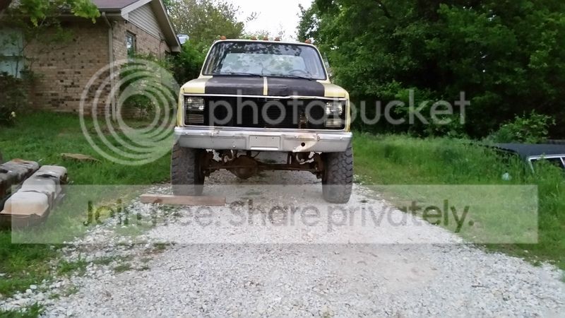

Trimmed the fenders in the front a bit. Went to change brake lines but wasnt able, different fitting. So I pulled the metal lines down a bit to work until I can find another line that will work.
They look cool until you realize they arent autometers. Haha. They work well enough for now. I've got another set somewhere from another K5 I bought years ago if I need a spare. It's been fun to have something to tinker with that's simple. If I want to work on something I just go do it. No reading about wiring or trying to find a part someone else has used. Just stupid simple and fun.
