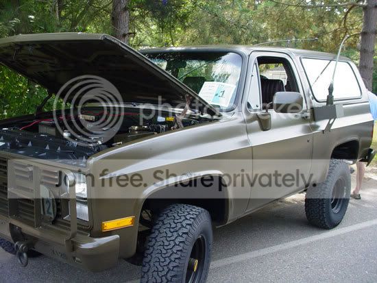

EDIT: Olive Drab Green...you'll want to remove most of the old paint and make sure you have something to adhere to. i did a cheap rattlecan paint job but it's worth it to do it right the first time

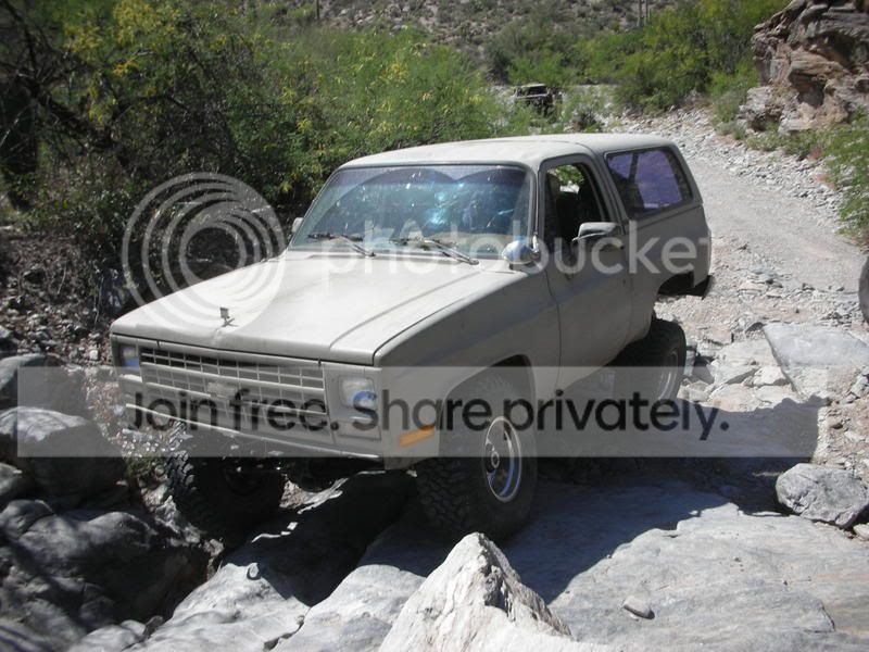

here's mine in Krylon Camo desert khaki. Except my wheels and tires are different now. :wink1: Will be working on a desert camo pattern when I have time.

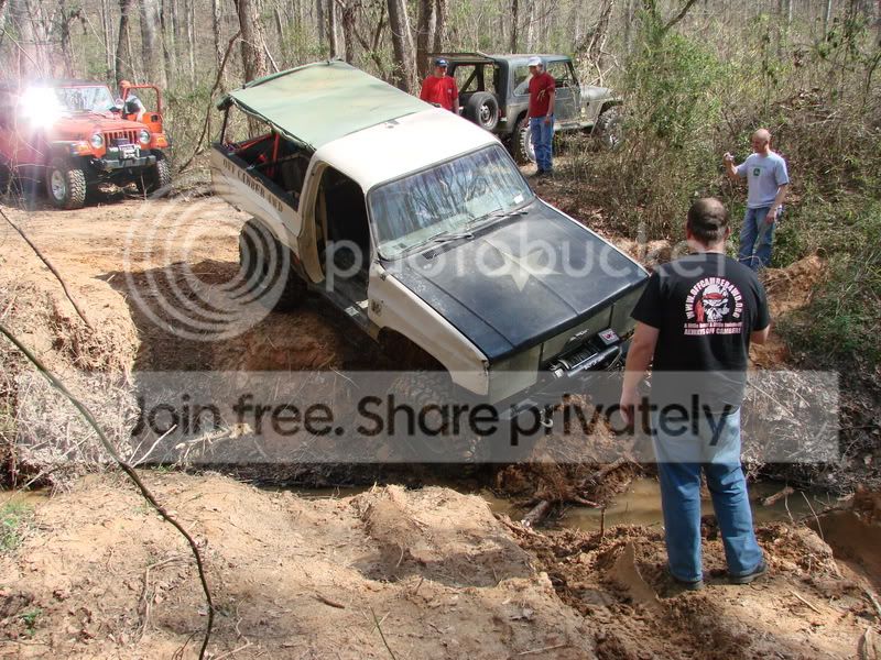

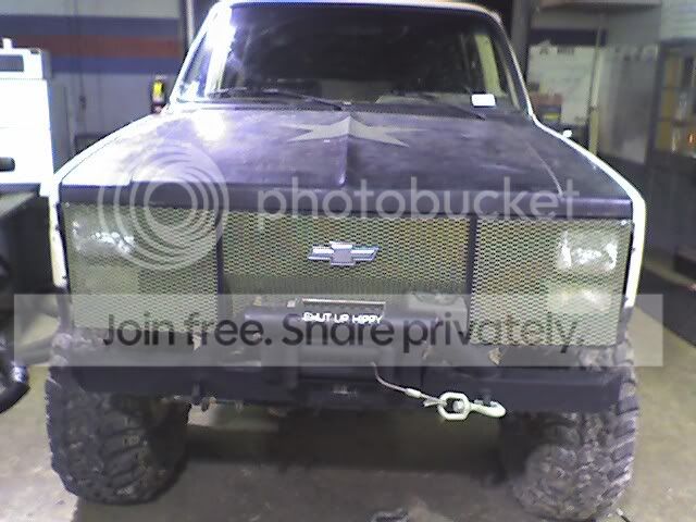

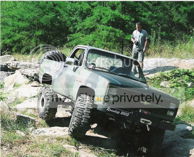

i am going with the ww2 grean on mine but FORMUD has a nice paint job see
this is him in the middle of a bad and nasty roll over this is after turn 1 and on to trun 2 next :haha: :haha: (all ok) -- J:D this is for you bud

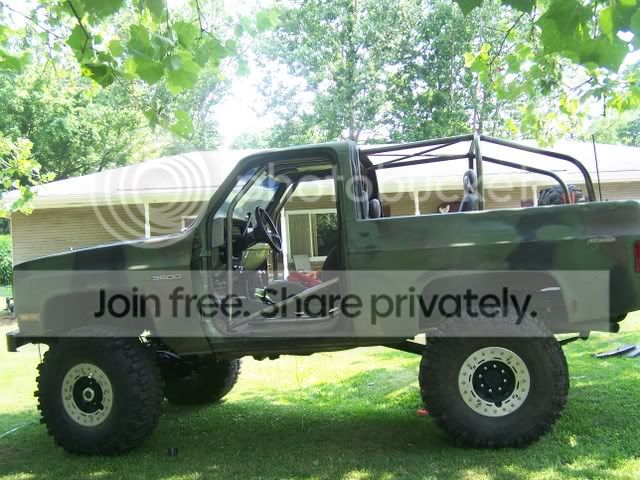

Here is the OD WWII Green I like.
