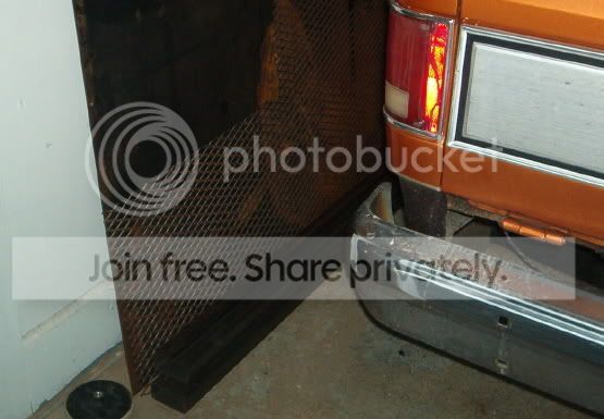

hmmm, thought I just came up with the idea of a full expanded steel grill.. :doah: hadn't seen yours... i've got some downstairs..
it's like 9 - 1 1/2" or something, 9 gauge, with diamond openings 1 1/2" across the opening..
bigger holes than yours... I'm gonna rap it in 5/16's roundrod... gonna do it in black, offset the copper..
I dig your Bowtie and aux lights in there.. :bow:

Georgia Gabe & Ryoken, more info on your grills please:thumb:
I've been looking to do something similar:D
How'd you attach it? Supports?
Did it increase your "usable space?" I'm looking to add an intercooler and will need all the real estate I can get :doah: ;)

Now that I've officially hi-jacked this thread... :o
I haven't done mine yet, waiting to pick up a clean pair of fenders...
I think the roundrod edge idea should work good.. It's what popped in my head when I first thought of this.. I'm gonna just weld in small tabs to the inside edge of the roundrod for perimeter mounting... I figure 2 on each fender, then maybe 2 on top, and 2 on bottom..
at this point, thats all i'm planning on for mounting till it's in.. The stuff I bought is pretty heavy and stiff... I would bet, the center downbrace of the factory grill could be ditched at that point.. And that would free some space to add to the couple inches ya pickup from losing the plastic grill...
I made mine out of three small sheets I had laying around. I welded it to the two metal straps that you can see in the pic and bent it at each end. I then took the sides and bent them in to tuck up inside the fenders. I also ran some sheetmetal screws with washers through the holes in the very top to hold it to the core support. Currently I have the whole front clip off of the thing and am about to totally redo the front so I dont know what Im going to do again for a grill.
