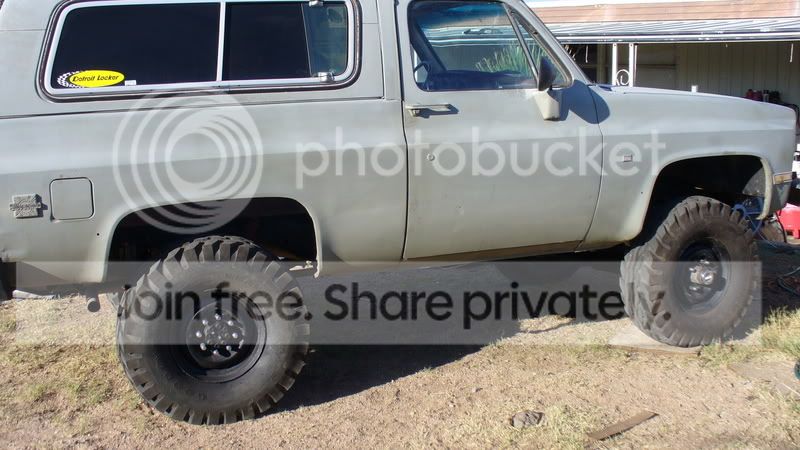

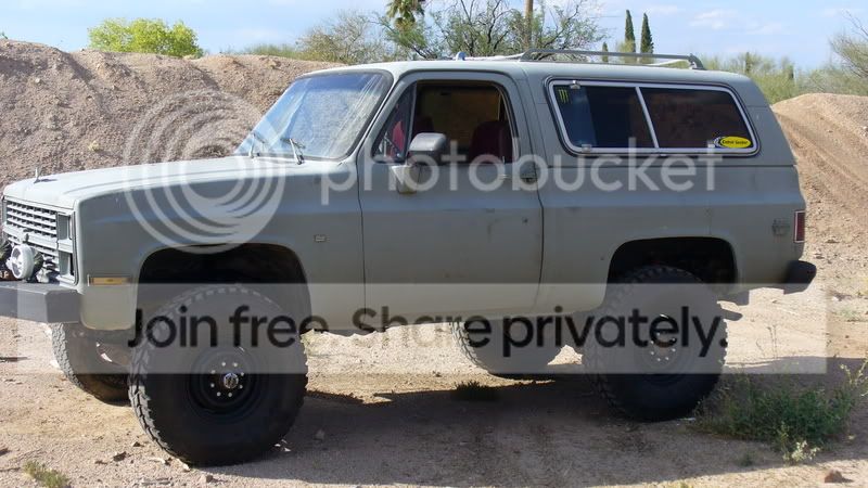

You need these;
These are Michelin 11.00R16's (37's) on my rig.
These are LAV tires. I bought them with 2/3rd tread.
If I drive coast to coast 10 times, I won't wear them oot!!
One tire can support my whole rig.
BTW, I paid $330 for all 4 on eBay :D .

Very nice looking rig!!
HA! i was just searching for this exact topic. the michelins are hard as hell and seem to be pretty good. hummer tires, just pass on them.
how loud are the Michelins?

Same tires I have. Mine have a lot less tread, but they run great on the pavement. I grooved mine, and they are a lot quieter. I don't think they are an outstanding offroad tire, but I also don't feel like they are a hinderance either.
I paid $250 for 6. :p:
I drove 70mph for 400mi driving home from Moab. No problem.
Oh and I don't think they weigh that much more than any other tire. I don't think my steel beadlocked tired weigh any more than my buddy's 40" MTRs on H2s or his spare 39" TSL on steel wheel. I think this belief has been going around because if they are mounted on the steel military wheel, yes they are VERY heavy because there is a ton of steel in the wheel and they have the run flats.
