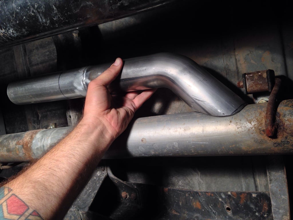

The 45* bend showed up yesterday, I just need to cap off the end and it's ready to be installed. I've got the position marked on the exhaust under the truck, I'll have to remove it or at least drop it down to weld this thing in.
Didn't see you mention anything on this, but those pipes are 'tuned'. The length make a difference in where it resonates, so you want the right resonance point to offset the drone.

Man....I'd be tempted to "sleeve" a capped section of tubing over the end of that new "J" pipe so that you could slide it in or out a few inches (like a trombone!).....
Do a few road tests.... move and tack weld the sleeve an inch or two.... retest and evaluate. Once you were 100% satisfied with the tuning, do a perimeter weld around that adjustable sleeve and call it a day.

Before that, you need to figure out the frequency you're trying to block out.
A V8 fires 4 times per revolution. 2500rpm/4 =625. 625/4 = 156.25. So the frequency I'm trying to cancel out is 156.25hz.

Hmm, good idea. I need to see if I can find some 2.5" OD tube to slide into the 2.5" ID stuff I've got.
No it gets capped. It's a dead chamber. The sound waves go there to die and it cancels out the offending waves. You ever seen an intake setup on a newer car? They have little side branch chambers that go nowhere. But it helps quiet things down. It's like a resonator only designed to kill a very specific sound range as opposed to just being in line.
