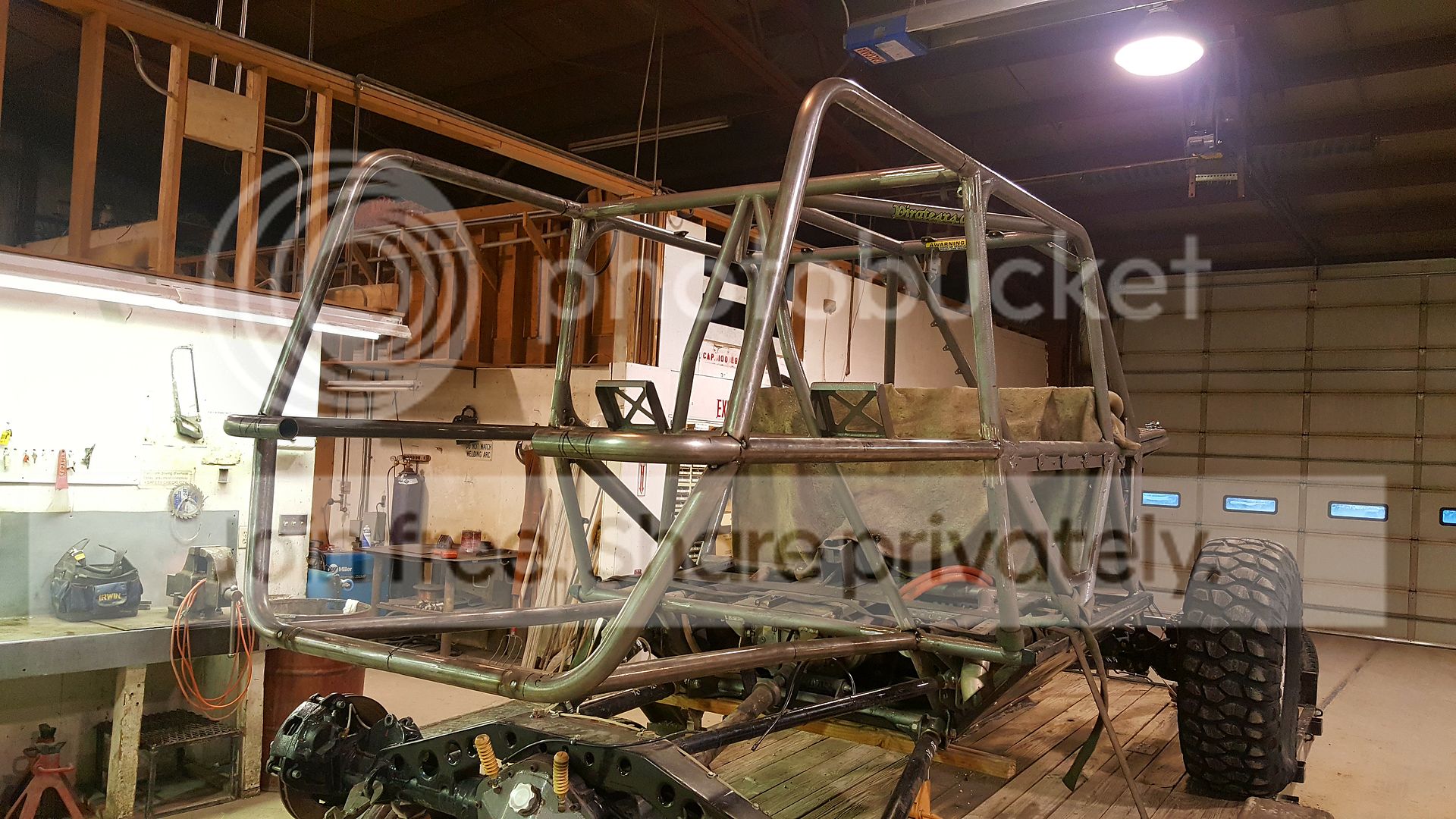

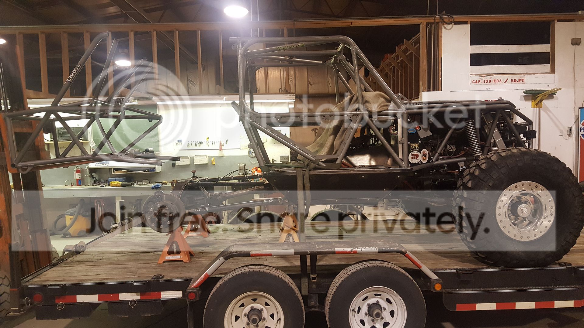

Monday I cut the back end of the rig off and spent a little eac day this week to clean and sand the existing tubes clean and ready to start reassembling.

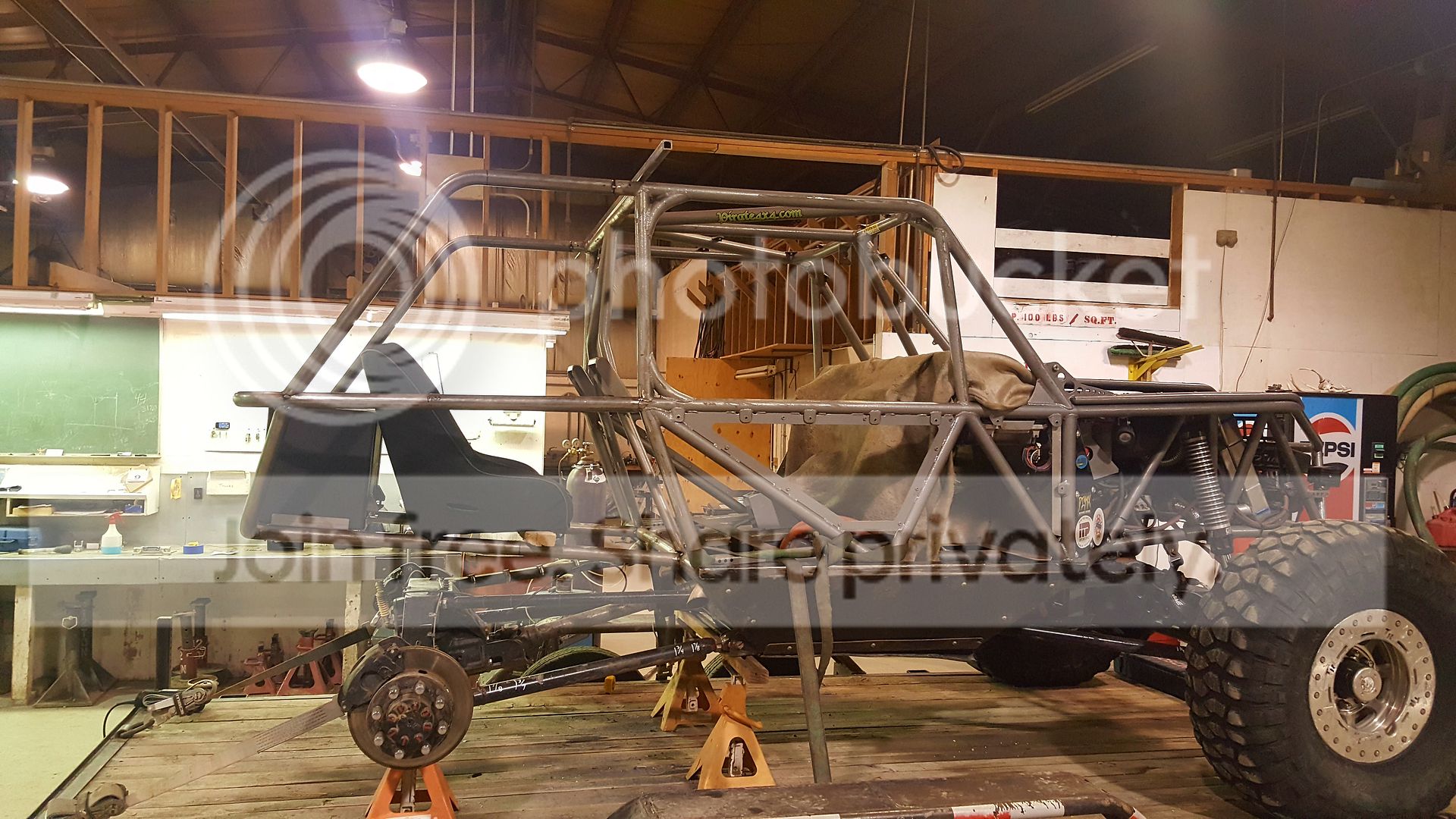

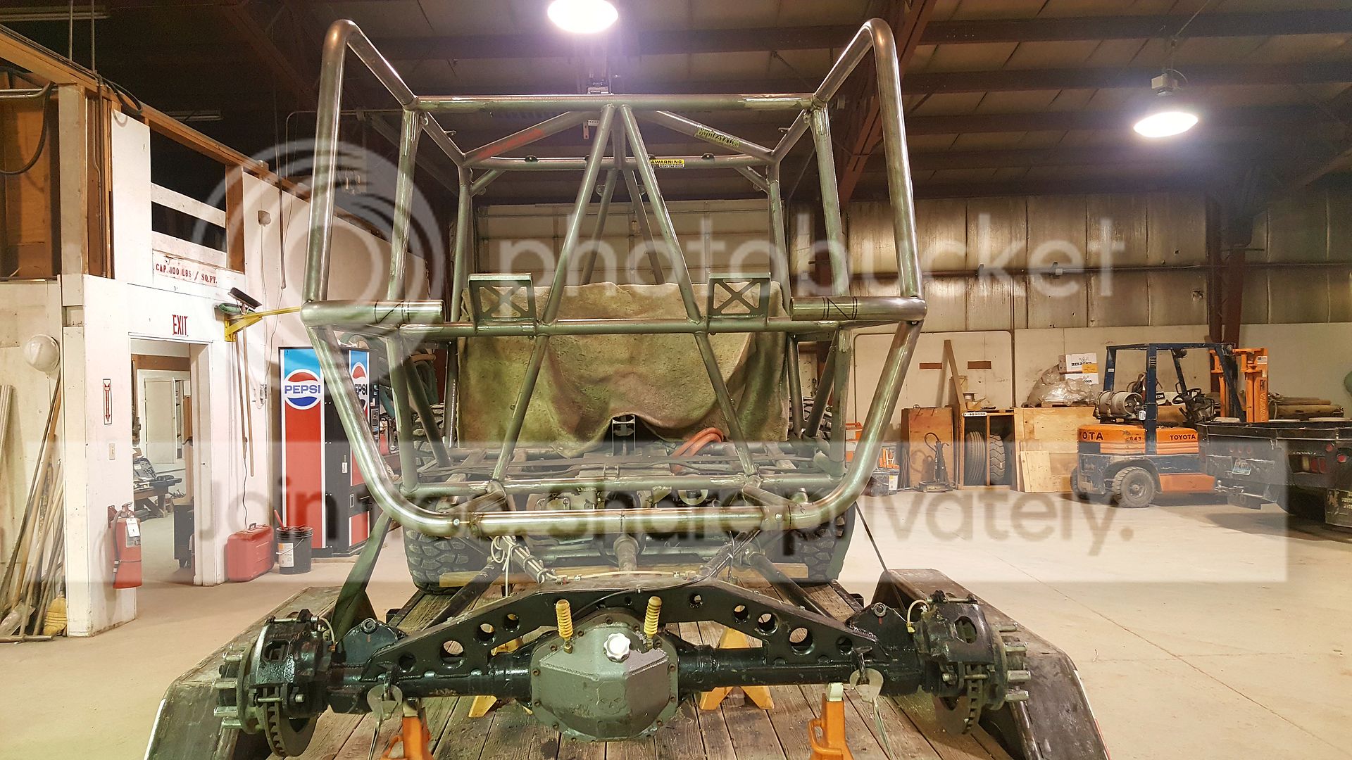

Today's start. Wanted the bumper sides to be at same angle as C pillar and the C pillar to be 48" wide at door tube to not pinch in from the top of roof that is 48" wide.
Original setup with rear frame straight back from cab area at 32"'on center but decided that was too wide so made new frame rails and rear bumper and brought it in to 26" on center. Also internally sleeved bumper with some 1.5" after bending the bumper last summer. Bumper is 1" back farther and 1.5"' lower than old setup.

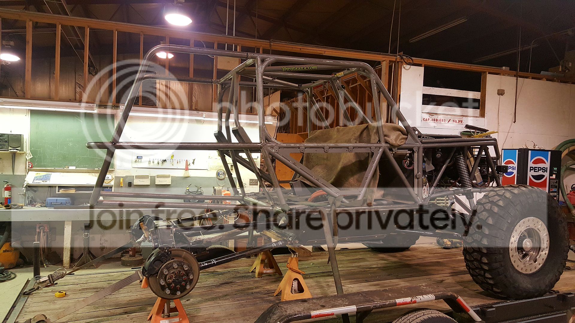

Next mock up fuel tank to figure out the tailgate then mockup seat to figure out rear roof cross
I didn't like how boxy the rear roof was when making the C pillar follow the same angle as the bumper tube so redid that this morning. Will make the rear roof crossmember kick back for extra rear seat protection.
