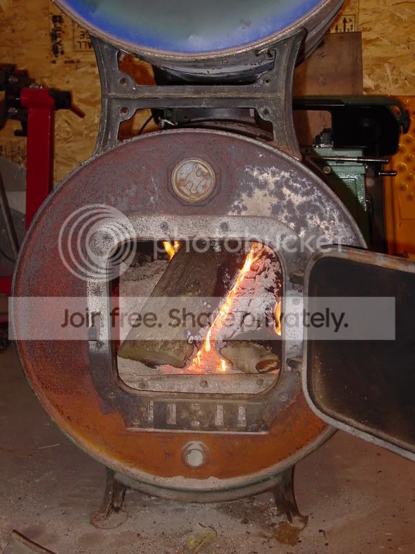

I have the same stove as Stein and it works great...
I cant blame you for wanting something thats "automatic" though,it does get annoying having to feed the stove every so often,though the barrel ones have a long burn time if you stuff some big logs in it..
It kind of sucks having to cut trees and gather pallets and smash them up to feed the stove too--its a lot of work and time that could be spent on better things...I dont like having to freeze for an hour till the garage gets warmer either...when I had a hot air oil fired furnace it was nice,in ten minutes you could get it up to 65 from 30 degrees..
The sealed heaters are much safer,using outside air for combustion..having it high off the floor also increases safety if some gas got spilled,the fumes tend to stay close to the floor..
I have had a few incidents where some gas spilled while my stove was blazing,not a lot of gas,but about a pint or so--I saw the flames in the stove start roaring and luckily the fumes just got combusted in the stove and it did not "flash back"...
