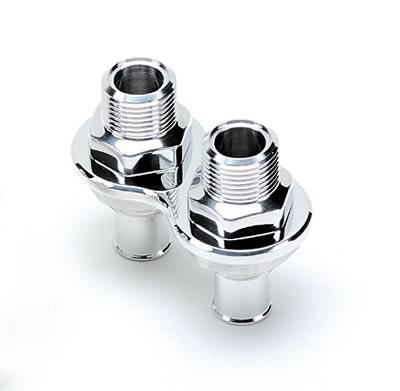

Looking for some sort of bulkhead fitting through the firewall, barbed fittings on each side[maybe a 90 on one end?
Anyone have any ideas?
I looked on most sites and started to get a headache:doah:
I have only been able to find a billet one online or some from summit. Links shortly
i just looked for the one i bought from summit and couldn't find it... wish i could remember the brand name..
Here is a good thread I found: http://www.chevytalk.org/fusionbb/showtopic.php?tid/207233/tp/2/
I think I am going to forgot about the bulkhead idea and go with pass through grommets. Anyone know where I can find some thick rubber ones?
Something like these?
this is the one i'm running... iirc, they are also available in barb to barb.....
