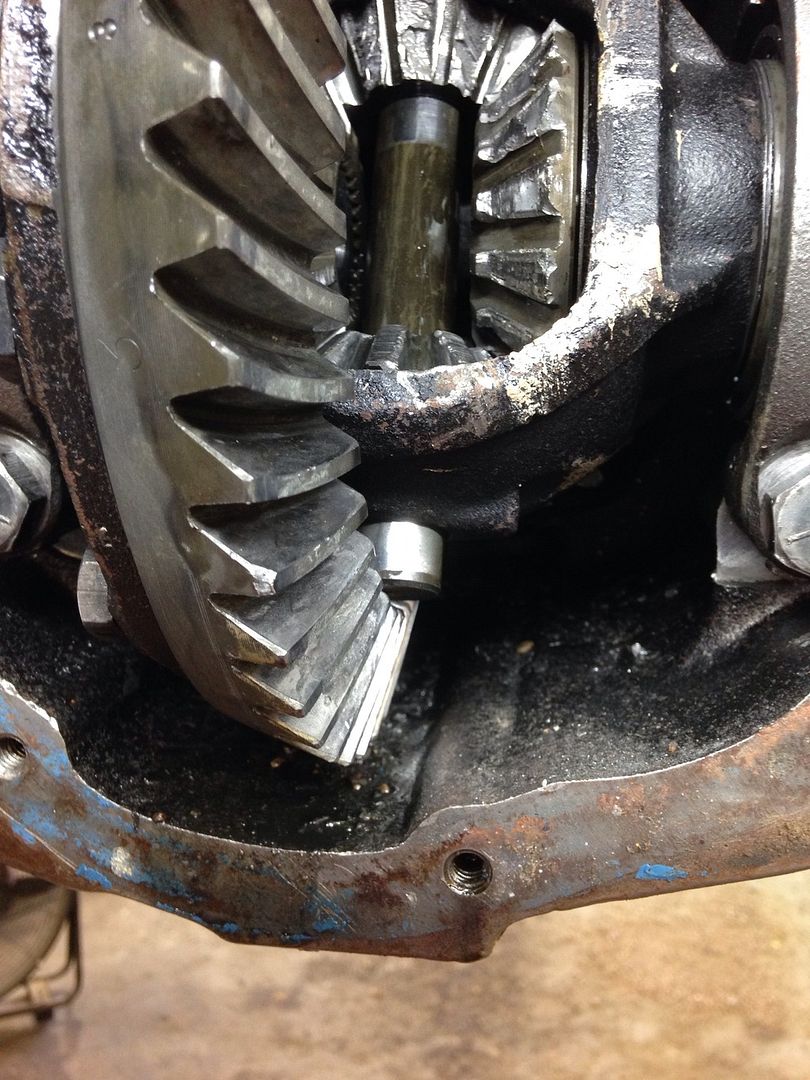

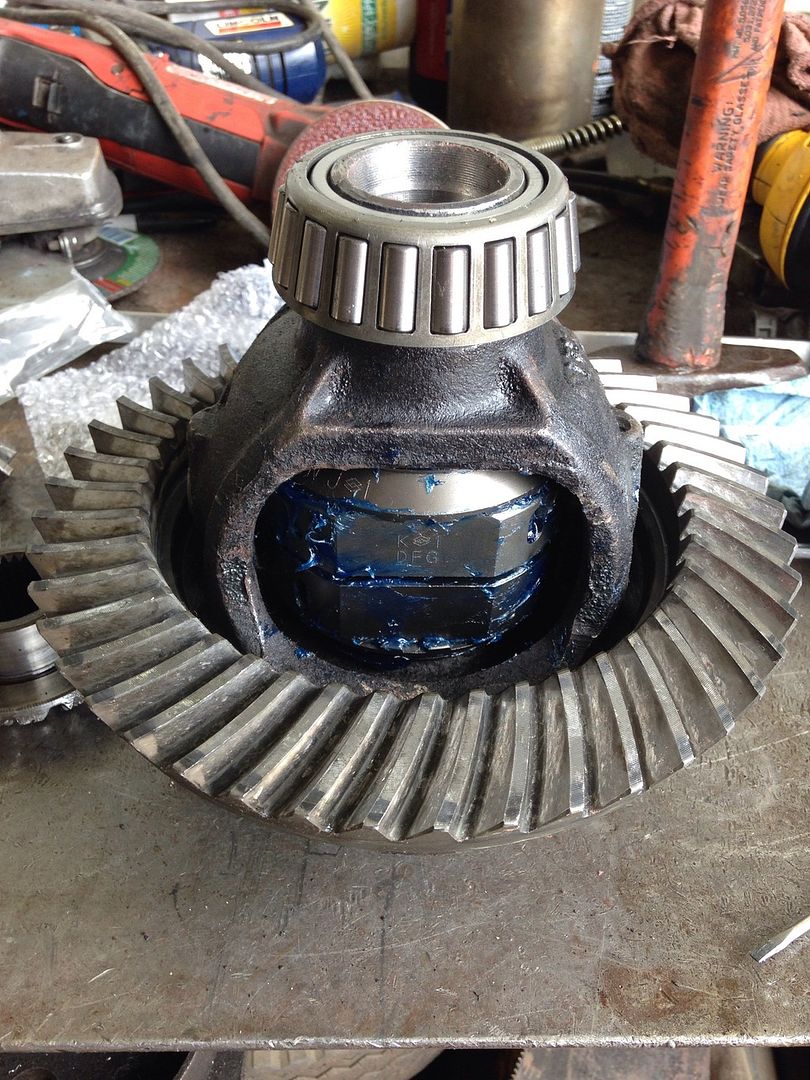

When I did the engine swing, I found a hole in the Dana 44 diff cover. Pulled the cover, and found the spider gears fragged. I told the kid to just buy a Lock Right, and I would install it.
Silly Dana axles. Why put the cross shaft where it interferes with the ring gear?

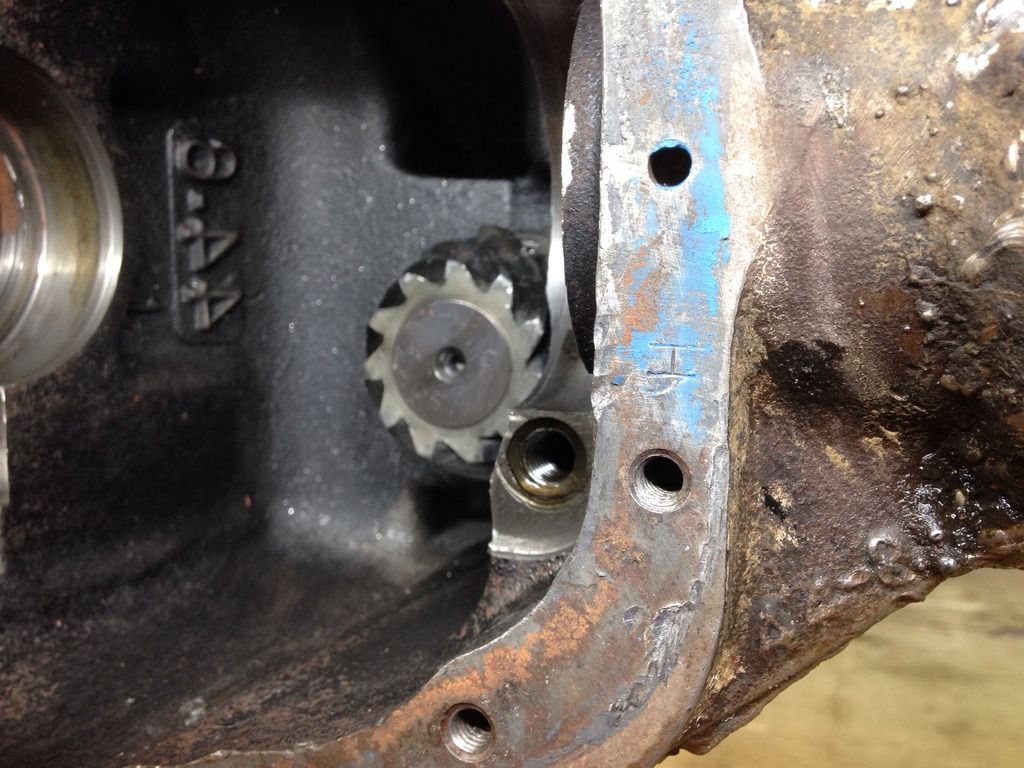

Cleaned out the housing. The pinion is not too pretty, but we'll see how long it lasts.

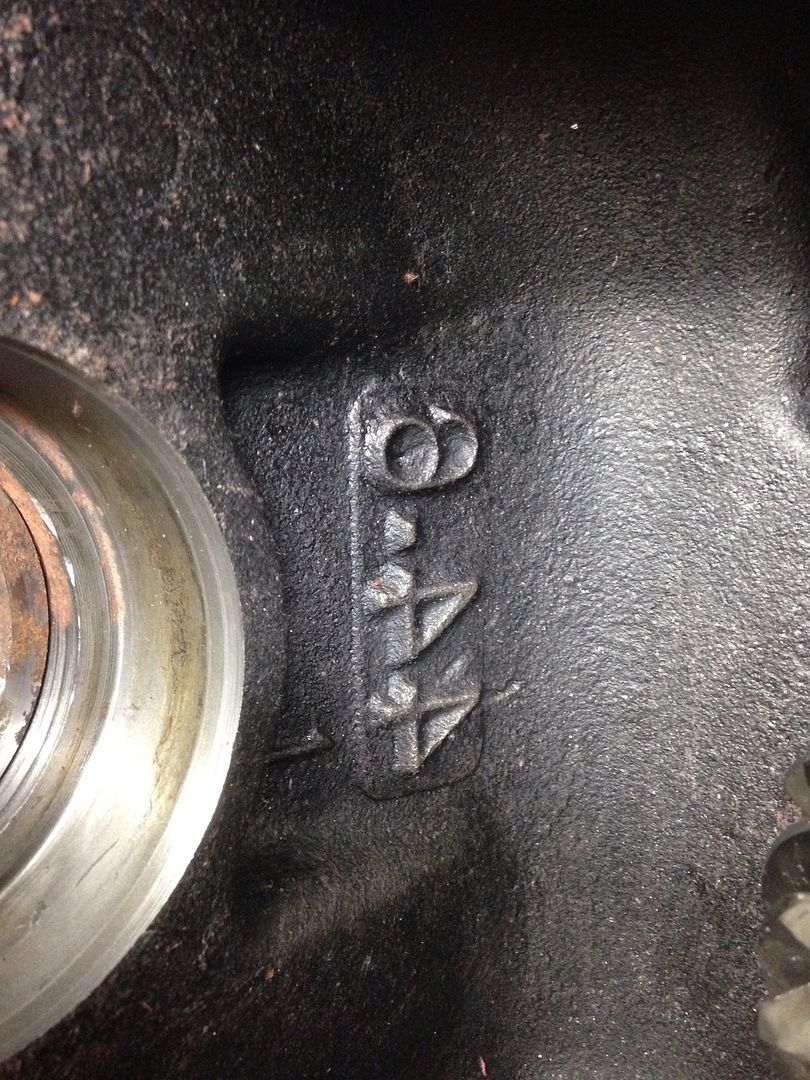

44-6 cast inside the housing.

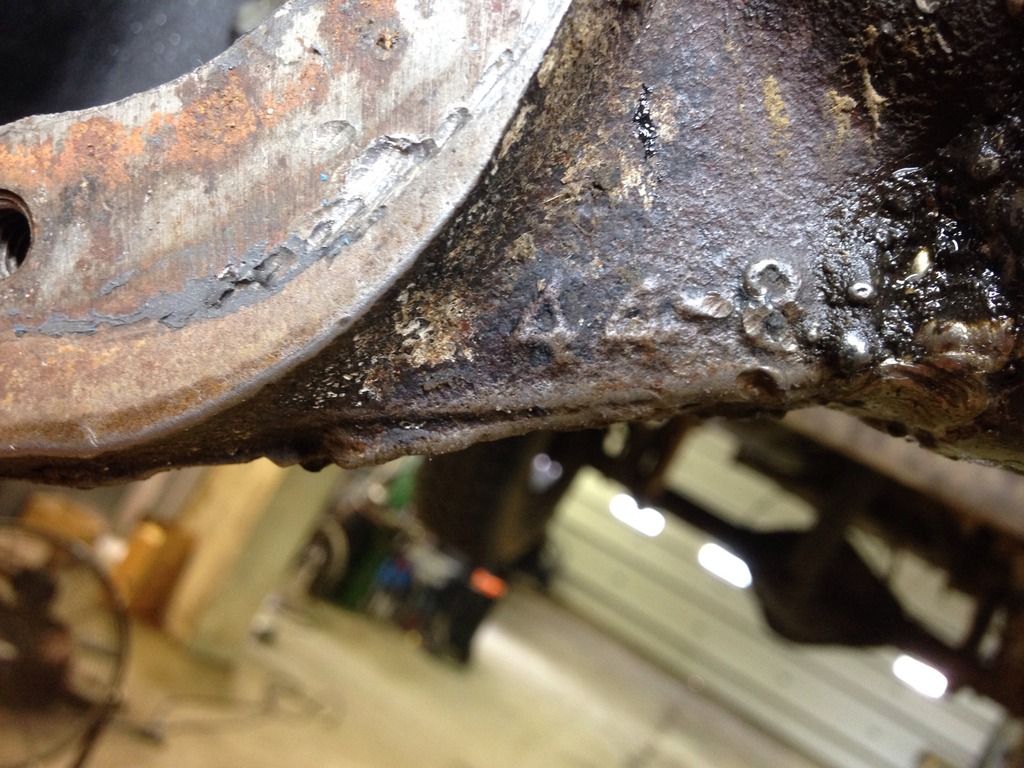

....but 44-8 cast into the outside of the housing???

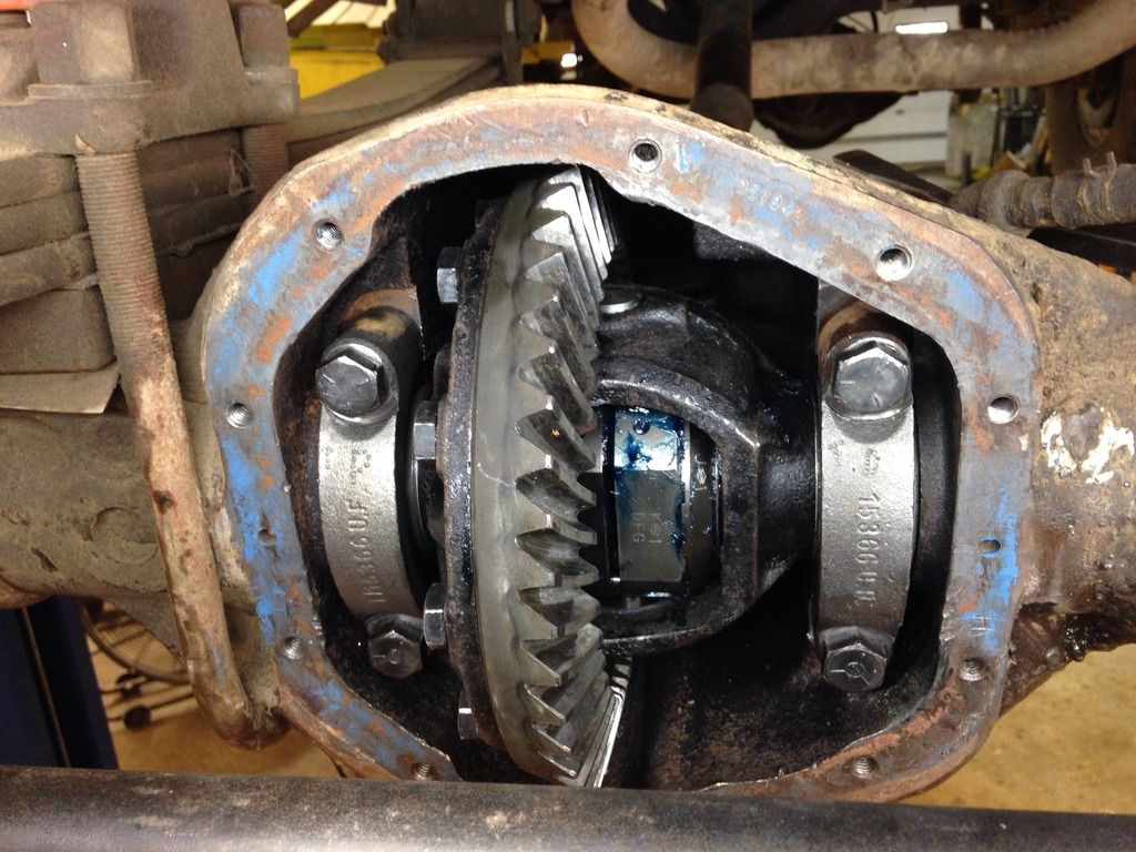

Lockright installed.

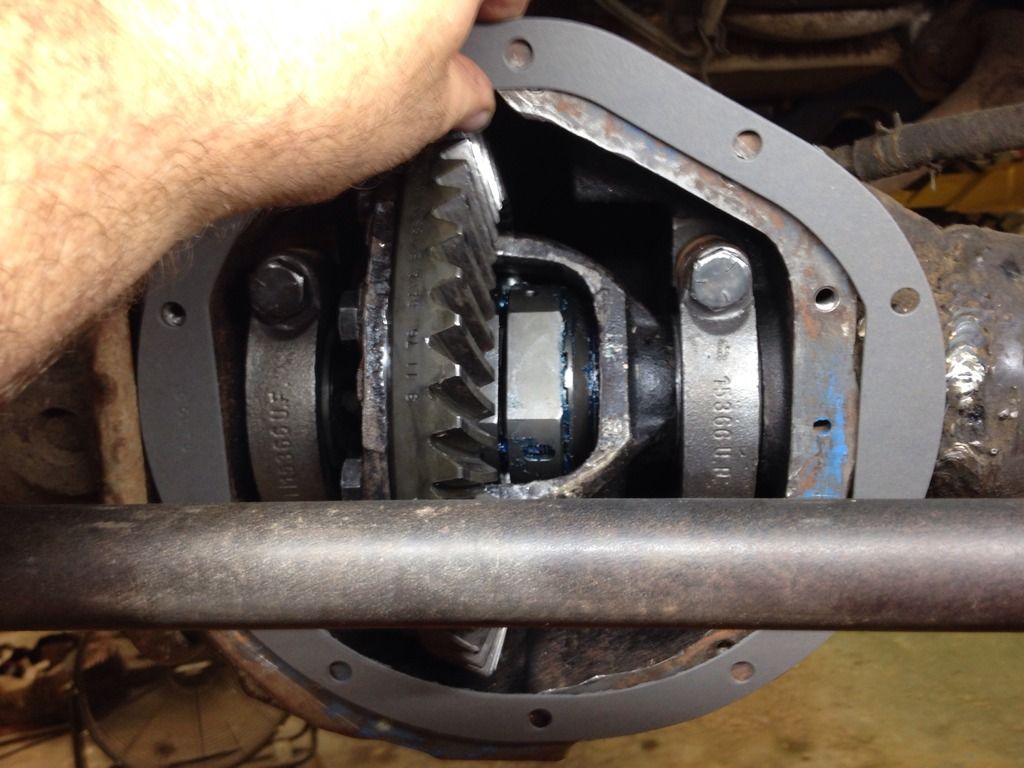

Carrier back in the axle.

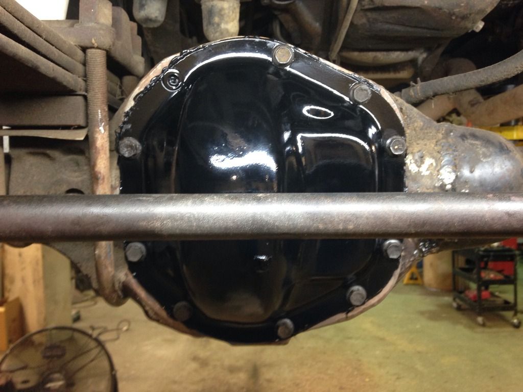

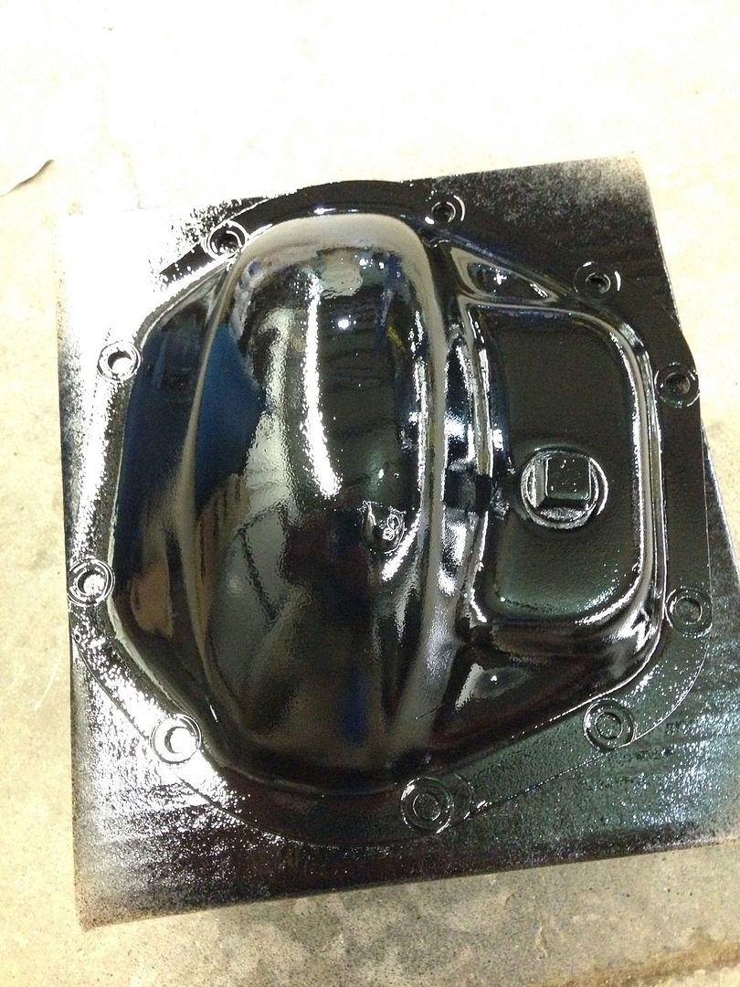

Fresh paint, just to make Dueling happy.

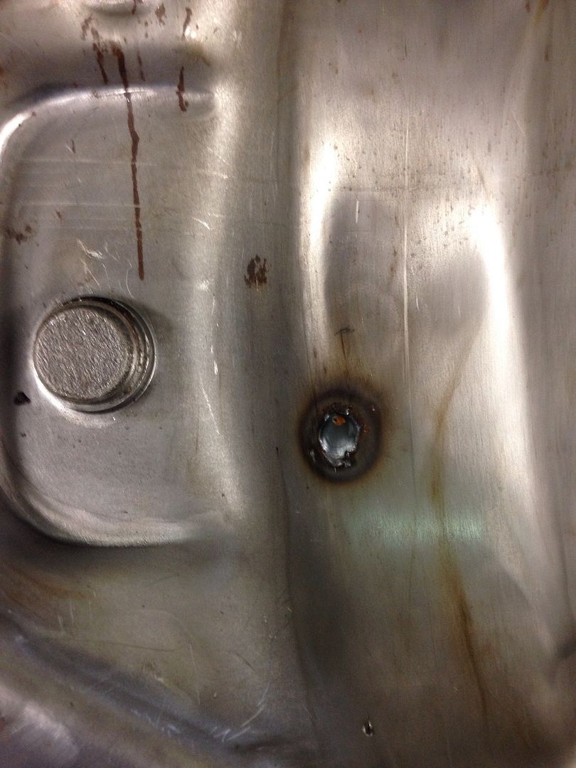

Had to weld up the hole in the stock cover.
Damn parts store sent me the wrong paper gasket, so I had to use silicone instead.
You better appreciate this Deuling!

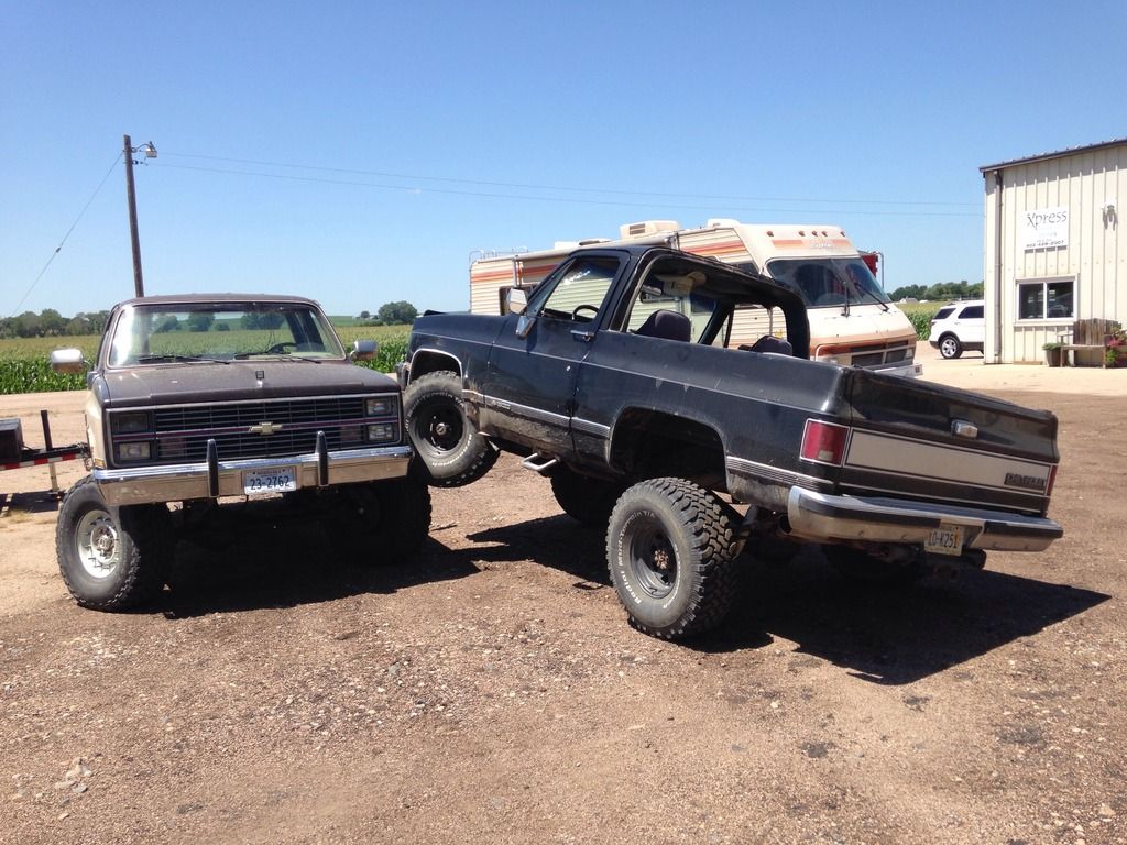

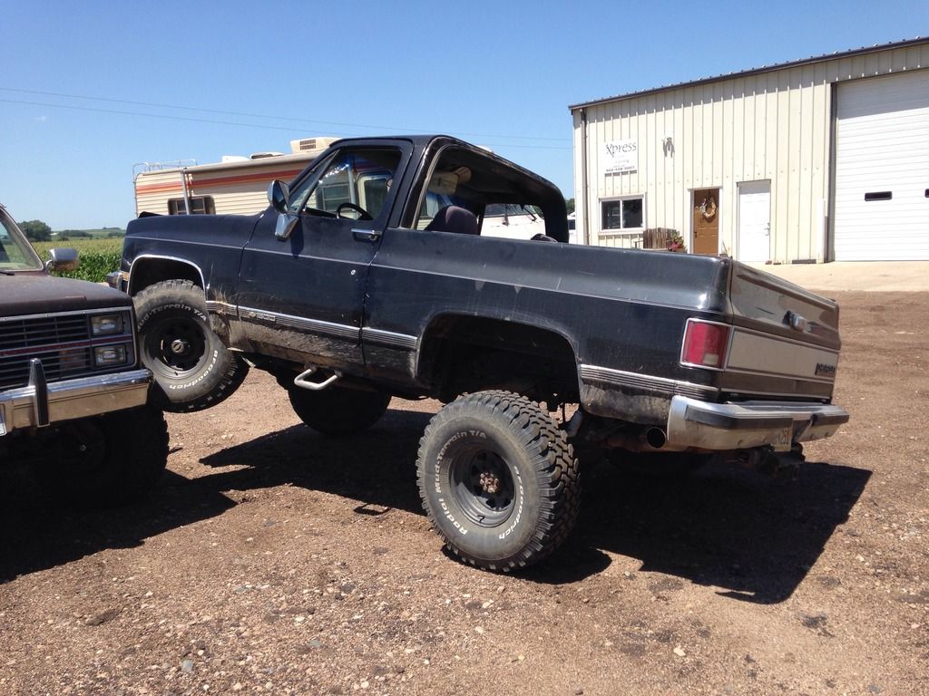

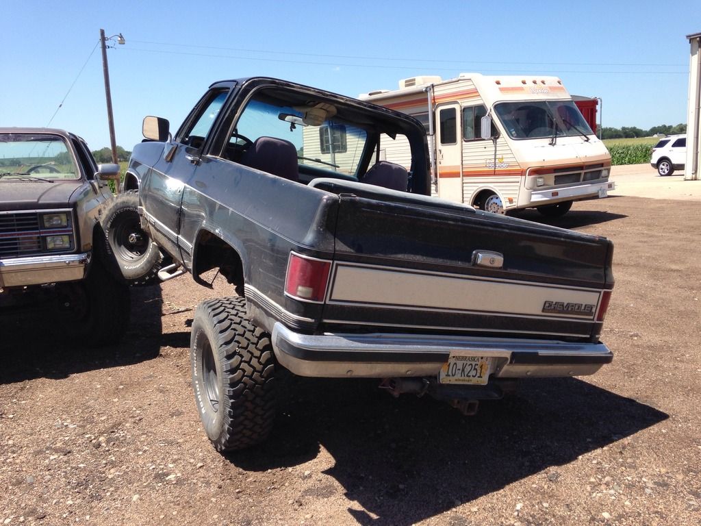

So of course, I had to check the locker operation.
Walked right up there. I thought that was pretty good flex for stock suspension (it has a set of three pack springs, and a zero rate in the front).
