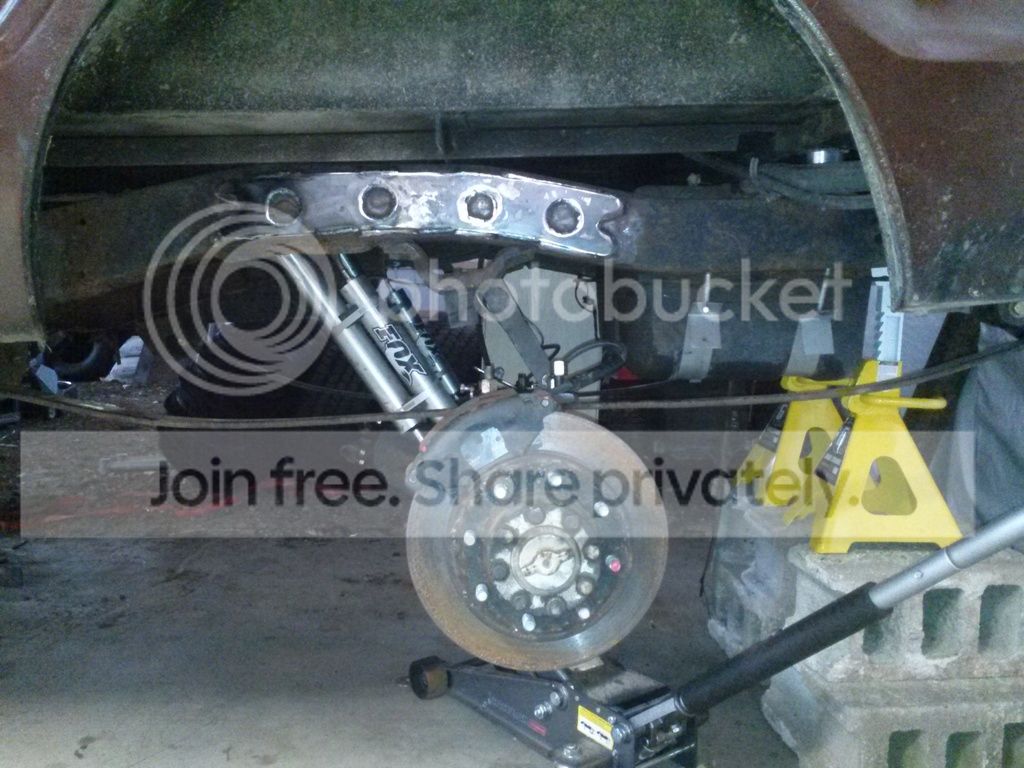

So today I finally got my rear springs tore apart today and was able to really quickly cycle and measure and from what I measured I am at 9"s of travel. I was really expecting/hoping for atleast 11"s out of these springs. Now I have to check tomorrow but I feel my shocks may have been limiting my droop and I think my shackle is too short. You can kind of see in one of the pics at bump my spring looks wavey? The shackle was fully extended and I feel the spring had more up travel to go but the shackle was causing it to bind? Thoughts? I was really shooting for 11"s and i'm still going to try. I want to move my shocks and get them vertical over the axle and I also am going to go to a longer shackle and see if I can get my 2 more inches.

Shackle

yeah, I'll say the shackle looks too short. That main leaf should be able to go completely flat. So either your shackle is too short or your frame bracket needs to get moved back AND your shackle is too short.
I'd start off with at least a 1.5" longer shackle and go from there. I run 6" shackles with my 56s.
You sand guys measure droop differently, since you aren't worried about articulation. If you were, you'd see the massive numbers you were hoping to get. My 7 leaf stock 56s use all of my 12" shocks. My rear will tuck nicely, but droop is limited by my shocks :(
Yah your shackle is too short and binding the springs on up travel. I bet you can squeeze another 2" out of them on uptravel easy with the correct shackle.
Note how mine are a nice straight spring, and yours start the bend out towards both ends...

Just an fyi nate, if you are not able to use all of that shock with 11" or so of spring travel, you should sell those shocks and get a shorter shock. They are 14" or 16" shocks if I remember correctly. A 12' will be easier to package and get the angles better.
Weird, im recommending a shorter shock I know....
But if a 12" shock is tipped forward just a little bit, you can still get 13-14" of travel out of it. No reason to have those long shocks if they are doing no good. A vertical shock will work %50 better than a shock at 45 degrees.
