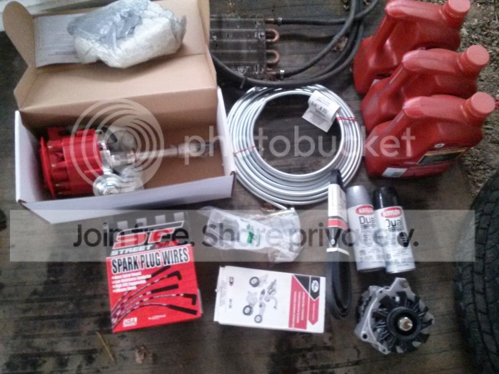

Well my debit cars is melted from swipin' it so much this monring. I have more parts coming. The orders should be 98% of all the parts i need. Nows jjst fiding time to get it all in!
