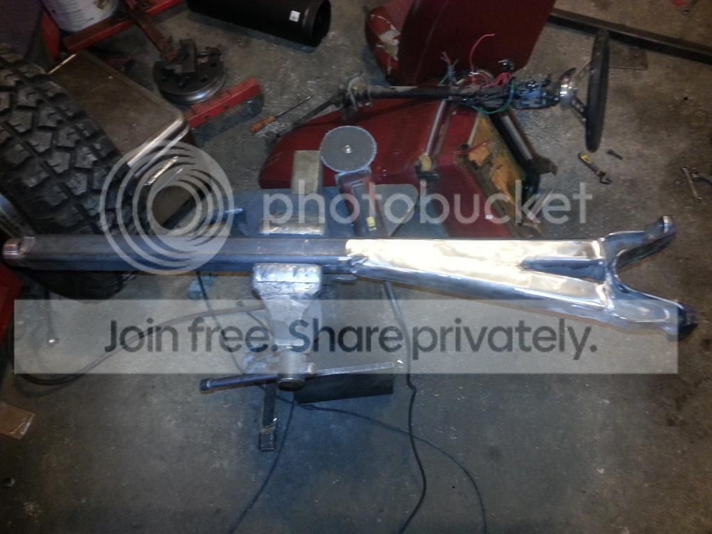

I would still do something with the radius arms.
If one of those breaks at speed its not cool and having seen thicker wall and larger tubing bend on a jump gone wrong just not worth risking your shocks and leaf springs.
Btw we had a modified radius arm set up on the 4500 class truck I was involved with. It bent while I was driving it. Took out both coilovers and both bypass shocks on the front. Fortunately just broke the shafts so not as much to fix but still dang near 600 bucks.
My idea with radius arms is that one can break and the other one needs to be able to not on ly survive but still locate the axle well enough to only break minor stuff
Also now y'all have seen the light with links. I expect many heim joints in your future :woot:
Those look beefy.
With how hard i am on things (you guys will come to learn this) im sure lots of heims are in my future. Its just a matter of saving the money for shocks and heims to 3 link it. Until then ill find the weaknesses in radius arms im sure. I dont have a tow truck and trailer for nothing. Thats why first priority is safety. Needs some more cage work incase of something bad happening at high speed.
