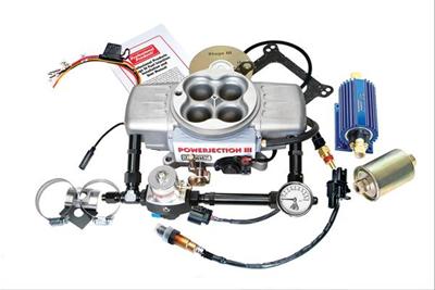

Looks like a sicker version of this set-up...
These Professional Products Powerjection III systems are a major leap in technology for aftermarket fuel injection systems. They are inexpensive and easy systems to install. The Powerjection III features the Engine Management System (EMS) mounted directly on the throttle body. This eliminates a major portion of the wiring harness found on most EFI systems. The injectors, and the idle air control are contained inside the throttle body and the unit that controls them is attached to the side of the throttle body. Despite its compact size, the EMS is still laptop programmable although this is normally not required with most installations. It is a feature for those enthusiasts who prefer to do their own programming. For most enthusiasts, the installed program is more than suitable. This, like Professional Products other EFI systems, is fully self learning. Install it, fire it up, drive it around for 30 minutes or so and it dials itself in. It continues to fine tune itself as it adjusts to your driving habits and various atmospheric conditions.
http://www.summitracing.com/parts/PFS-70026/?rtype=10
That is pretty slick! Just hook up an O2 sensor, coolant temp sensor, and fuel pump and its good to go.

The Powerjection unit is some chinese crap that I wouldn't trust, although the design does look strikingly similar to the new MSD unit.
