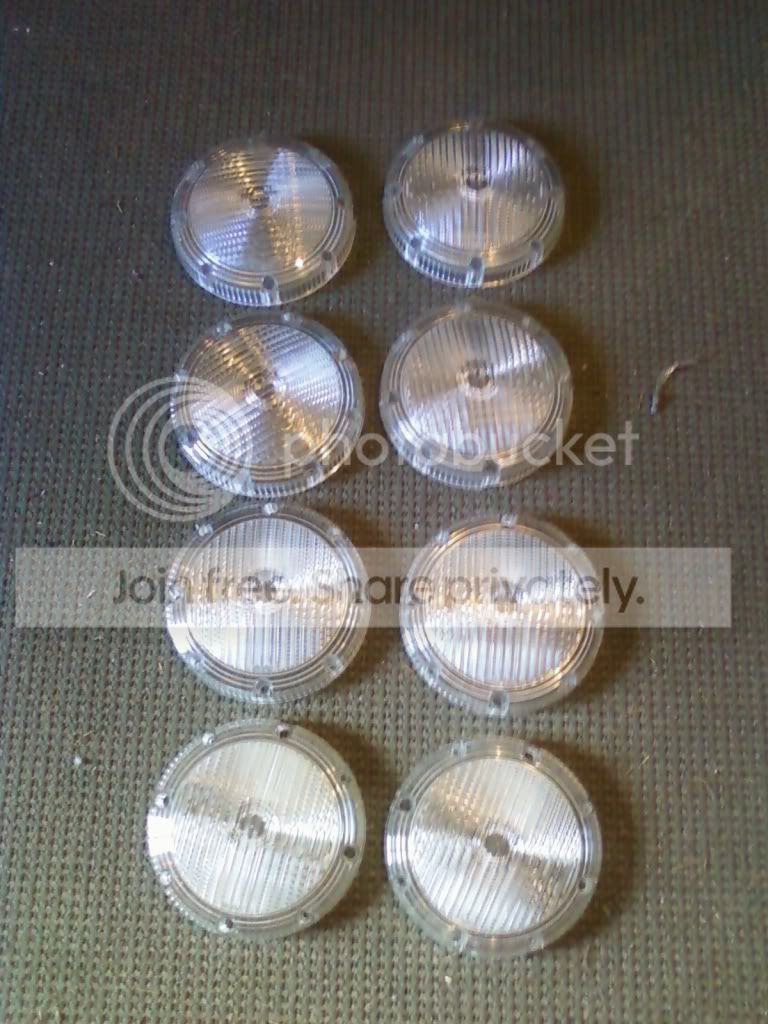

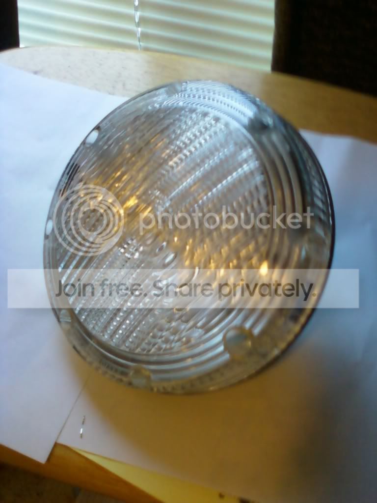

I got the clear lenses for the upper lights today...

Here's the lenses... They should light up camp really nicely...

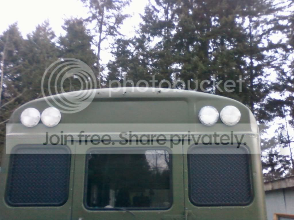

Got the new clear lenses on... I have to figure out what wires make them work... When the bus was decommisioned they pulled all the toggles that work the safety stuff that's ony legal to use on school busses... So, I need to figure out which one works them and remove the flasher...
I like the way they look...:cool:
They should light up camp pretty good... Haven't lit them of yet, have to figure out the wiring...

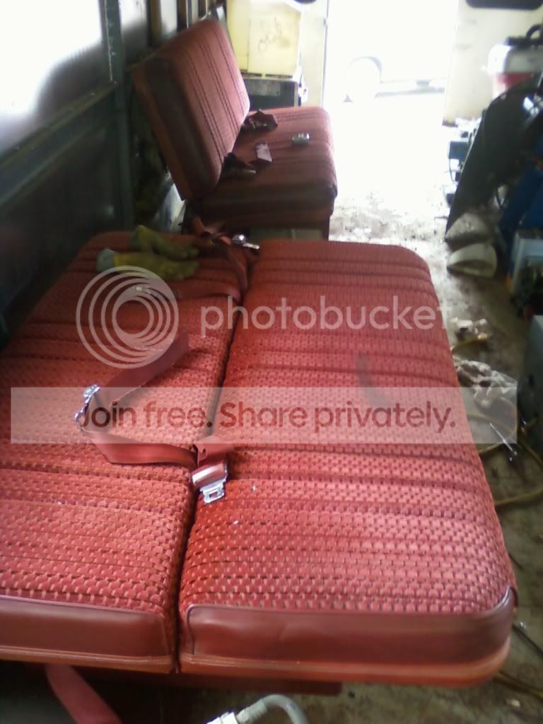

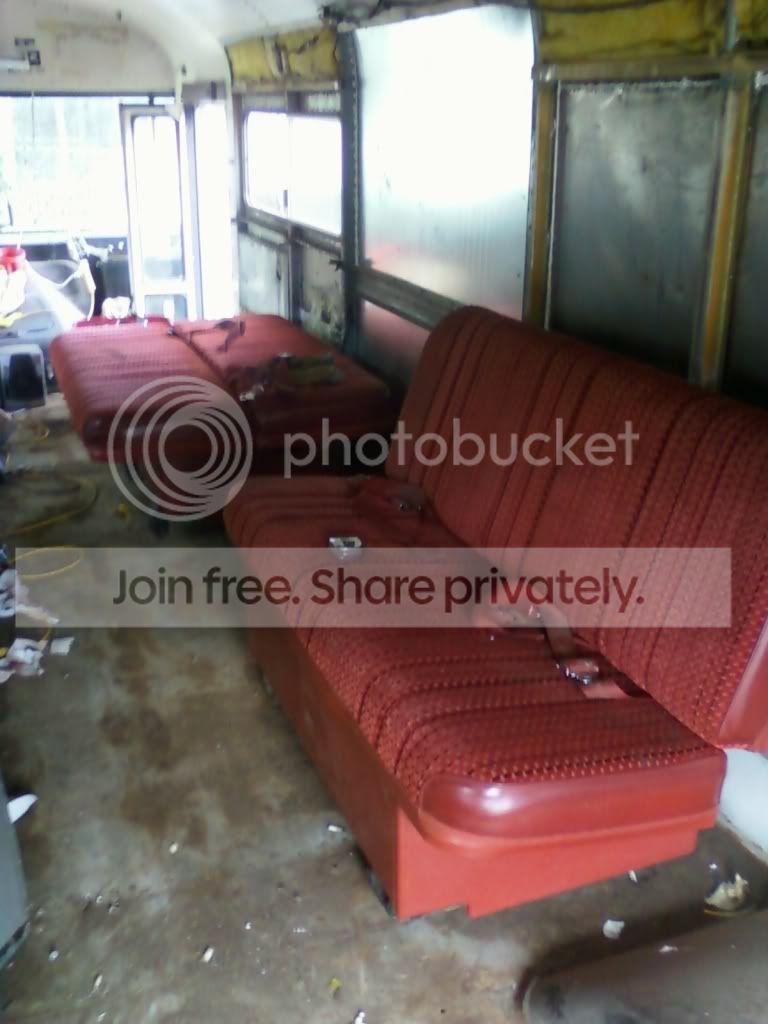

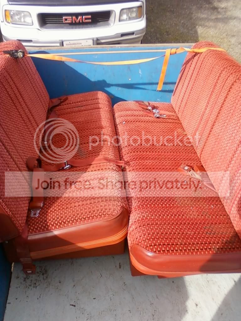

Picked up a couple of seats out of a Dodge van from a good friend of mine, thanks Rick...
They lay down into beds... Have seat belts for 6... Really good shape, but an ugly red... I'll paint the bases and look into seat covers...
They measure 54" long, so I can't face them forward because it wouldn't leave enough space to get around them with the galley in place... So, I plan on mounting them where they are sitting and build an end table between them...

It'll be like a living room!
I don't think the seatbelts would be beneficial except in a side rollover scenario. Seems to me that a sudden stop while moving forward would cause more harm than good. :dunno:
Nice score otherwise. You could dye them.:laugh:
all RVs have the seats facing that way, the seatbelts are an improvement no mater what. My dad's rv has seatbelts in one of the benches that face sideways, the others do not.

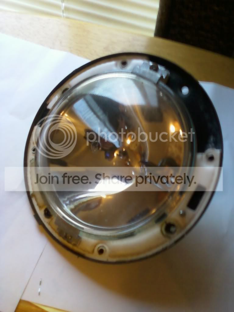

I got the rest of the exterior lights the other day, so everything is led now... Well, except for the upper flashers front and rear, they are seal beams... Took all the marking lights apart and painted the backing plates black, they were white and couldn't find any with black...
