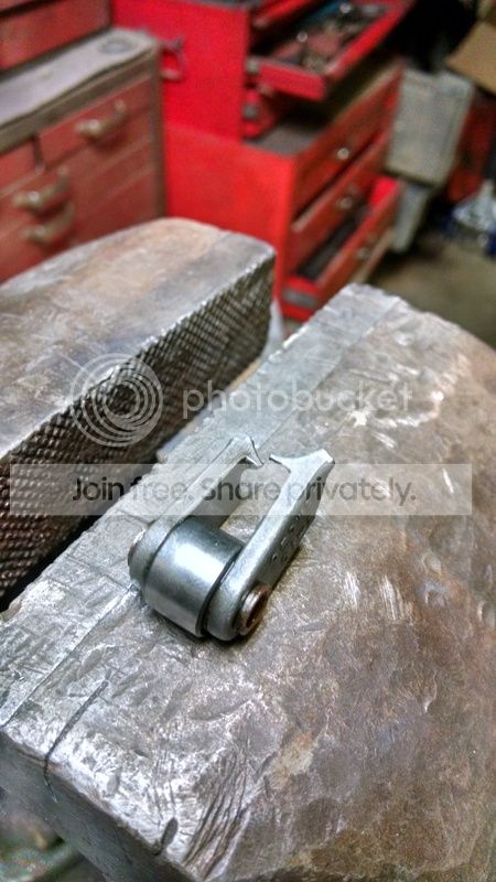

i changed the plug the other nite and it's a pain to do because they have to be indexed so the ground strap doesn't hit the piston. so i fired it up last nite and now how i check to make sure everything is good, i use a temperature gun to verify my work was good. #4 cylinder wasn't coming up to temp. pulled plug, it was good, installed another, same deal. cleaned distributor, put another plug to ground and made it was firing.
pulled valve cover after a phone call to a friend. found that laying on the head. that was from #4 exhaust. then realized #4 intake, the pushrod and lifter were not in their holes. we think we can see them laying under the intake. these were solid lifters and are supposed to be linked. i'll be pulling the intake tonight.
folkenheath - the first run, it was missing, not sure why. i didn't change anything between rounds. that was the first pass after sitting all winter and really running it.
yes, timed races. some of the trucks got updated and they were scared of them. i'll watch the videos and see who it was. yes, we (most) all have mud guards built all around to prevent mud splashing on critical parts. that was one of the women drivers, she was stimid because she rolled that truck over last year.
this is a different chassis then i ran last year. cheaper and easier then 4 linking my old one.
cam is screwed, needs some push rods, lifters, rockers.
taking the heads to get looked at. gonna get the bottom end checked out too.
Think it all stemmed from the broken rocker or did you find another cause?
i think it was from too much valve lash., broke the rocker, pushrod came out and got ingested by the #8 cam lobe. i'll have to post up the pics.
my one buddy/engine builder (not of this engine) thinks a valve hit a piston #4 and broke the rocker from over revving.
that could be, cause i drive by feel, not gauges!
Man that really sucks. Be sure to post the rebuild and if you do any upgrades.
