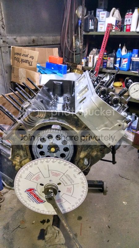

after 3 months it's back together. i learned alot and spent even more. it got the heads redone with everything but intake valves, that included new valve springs, locks, titanium retainers. the machine shop said i was the luckiest guy he ever seen when he started taking the heads apart, broken valve springs and locks. bought a new cam, lifters, and rockers. the new cam was bigger/ different then the old one so i had to buy new pushrods. i had to buy some engine tools to measure /setup everything.

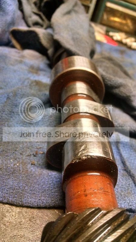

the lobe that ate a pushrod.

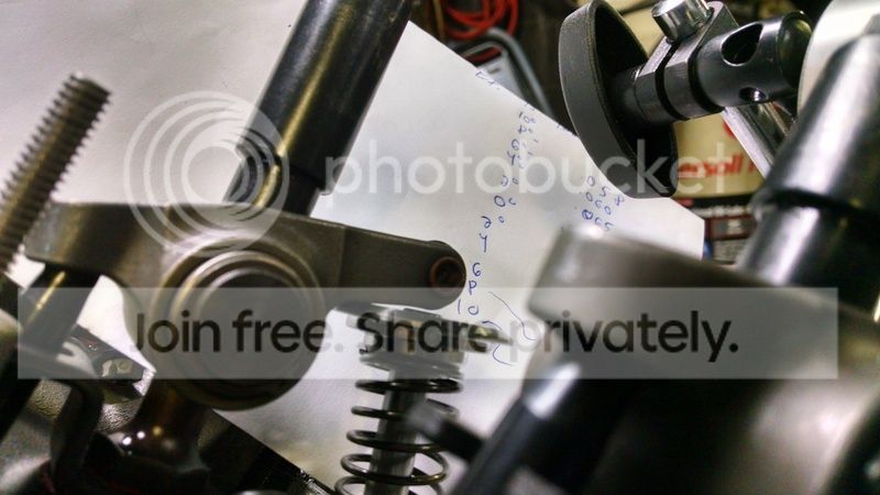

checking clearances.

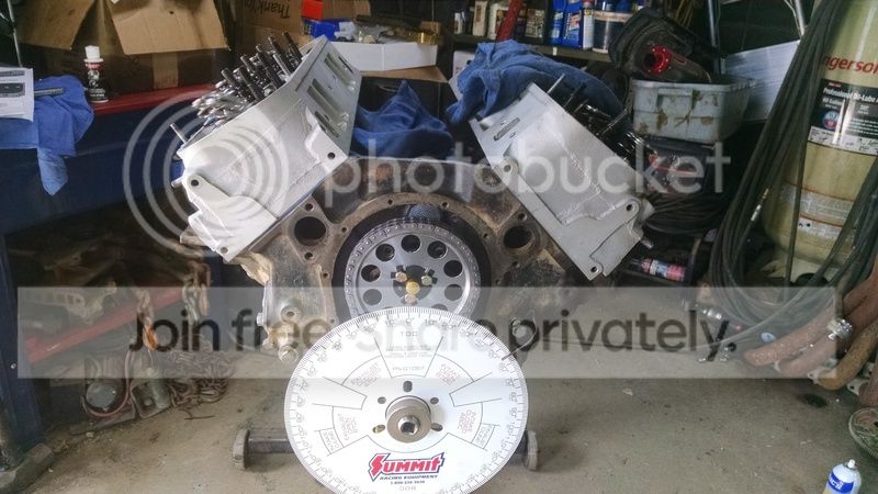

getting there.
uh oh. needed longer intake rocker studs to.
I learned how to degree a cam, check valve lift, and clearances. it was frustrating but got thru it with a few good engine builder friends.
