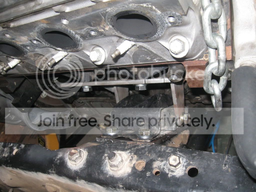

Motor mounts, CSP2370
http://carshop.carshopinc.com/product_info.php/products_id/98457/CSP2370

Doing the same swap on my 87 K5. I'm also in the parts collecting phase. What trans are you running? Have you thought about the Dirty Dingo engine mounts? That's what I'm going w/ I've heard good things.
Also doing this swap on my K5. Have the motor and am gathering parts. Those Dirty Dingo mounts look sweet!
I would have to ask teck about the dirty dingo mounts but xpndbl3 gave a good review to the car shop inc mounts.
I think these are the dirty dingo mounts teck used. They look good. A little different style then the car shop inc mounts. Also about double the price so I'm not quite sure if they are really worth it with the car shop ones already having a good review in here. But here they are anyway.
http://dirtydingo.com/store/product_info.php?cPath=1_206_305_318&products_id=1369
i used the dingo mounts on my 5.3 swap into my k5. they worked perfect.

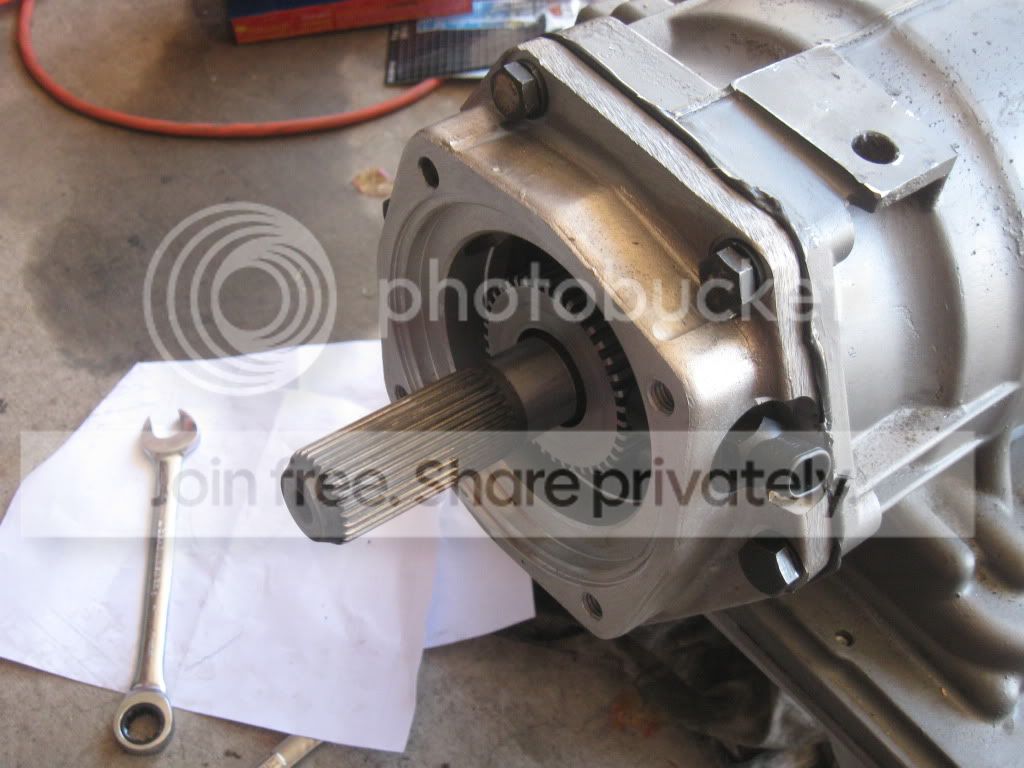

i used a 4l60e tranny with this advanced adapters part
http://www.advanceadapters.com/products/pn-50-0405/
i like it cuz it gives you a place to put your VSS sensor.

use earls or aeroquip fittings only, have had bad luck in our racing circle buying jegs, summit, "house" brand fittings. Also the car shops are "thee" choice for price/function. Done around 10 vehicles now with them, all bolted up 100% in the stock location for the trans to bolt to the bellhousing.
Awesome! Thanks for the info! So in other words, you didn't have to move the trans location? And right/ clearence was all good?
Trans pan sat on 2x12s stacked REALLY high on my truck the entire swap lol. Dropped the new motor back into the chassis, tightened up the bellhousing bolts and torque converter bolts, then shoved in the motor mount bolts and called it a day. Same location, same driveshafts, same everything. I suppose if your mounts are really shot you might have crossmember clearance issues near the front of the oil pan, but I have plenty of clearance. I've seen some pics where the $12 rubber mounts look like death and the motor is probably sitting on the metal clamshells instead of the rubber mounts entirely. Just inspect yours when you pull the engine. My stockers were still perfect, probably from that weak weak weak! 350tbi compared to this new engine ;)
