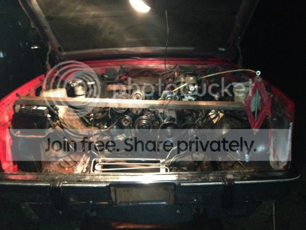

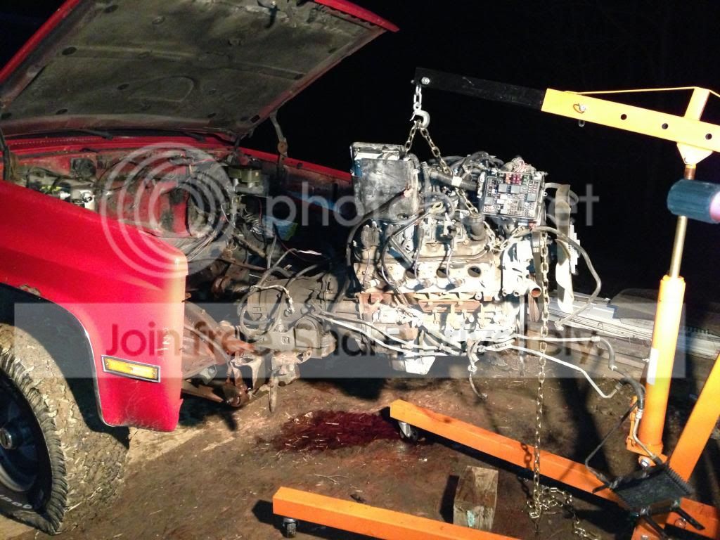

Then used my high dollar fender spreader to get the core support out alittle easier

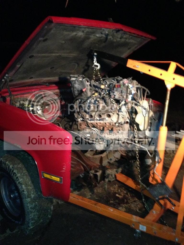

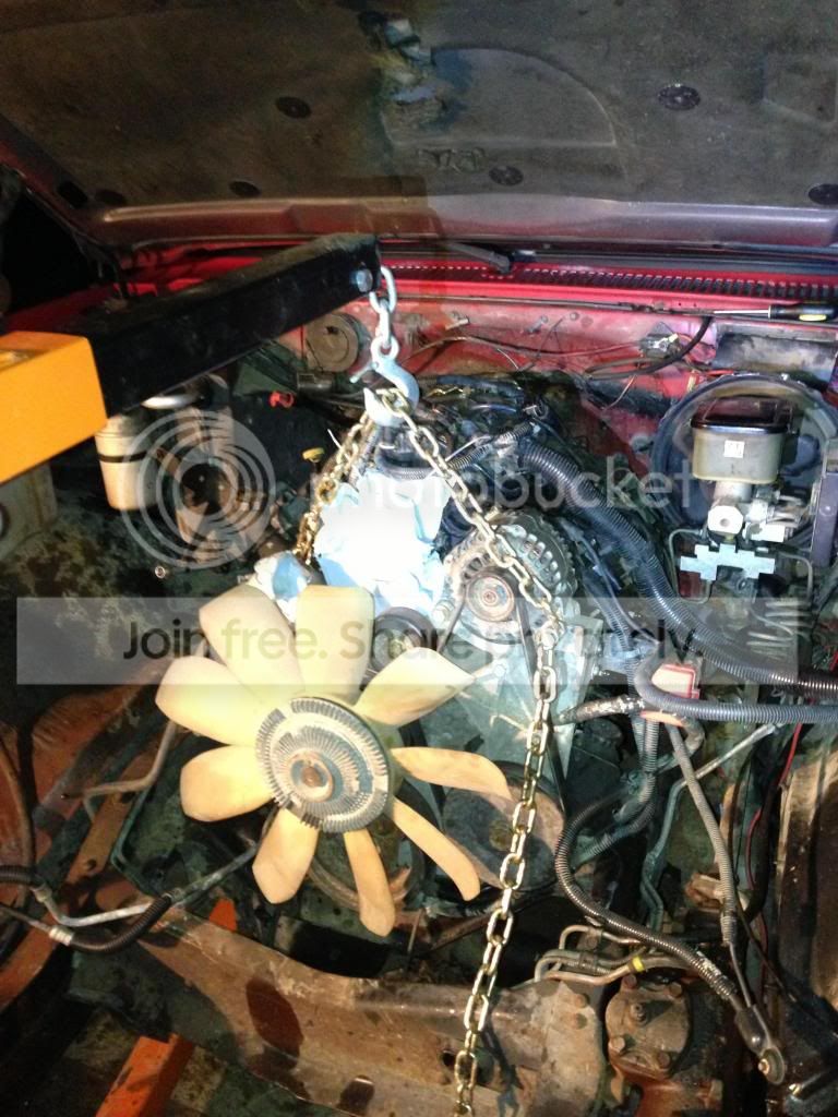

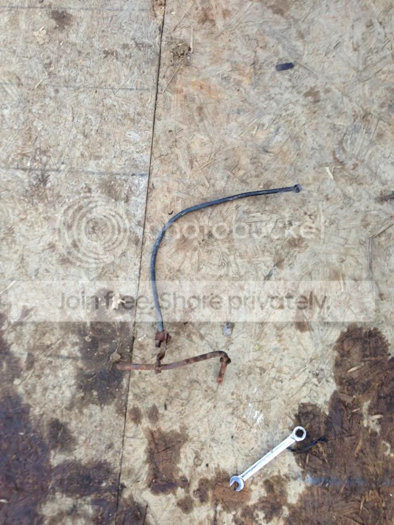

Then I mangled my shift linkage pulling the engine out. Face palm moment

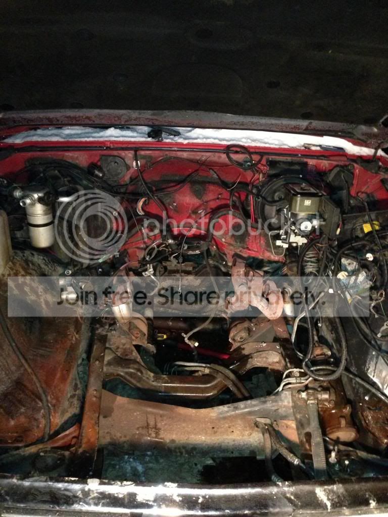

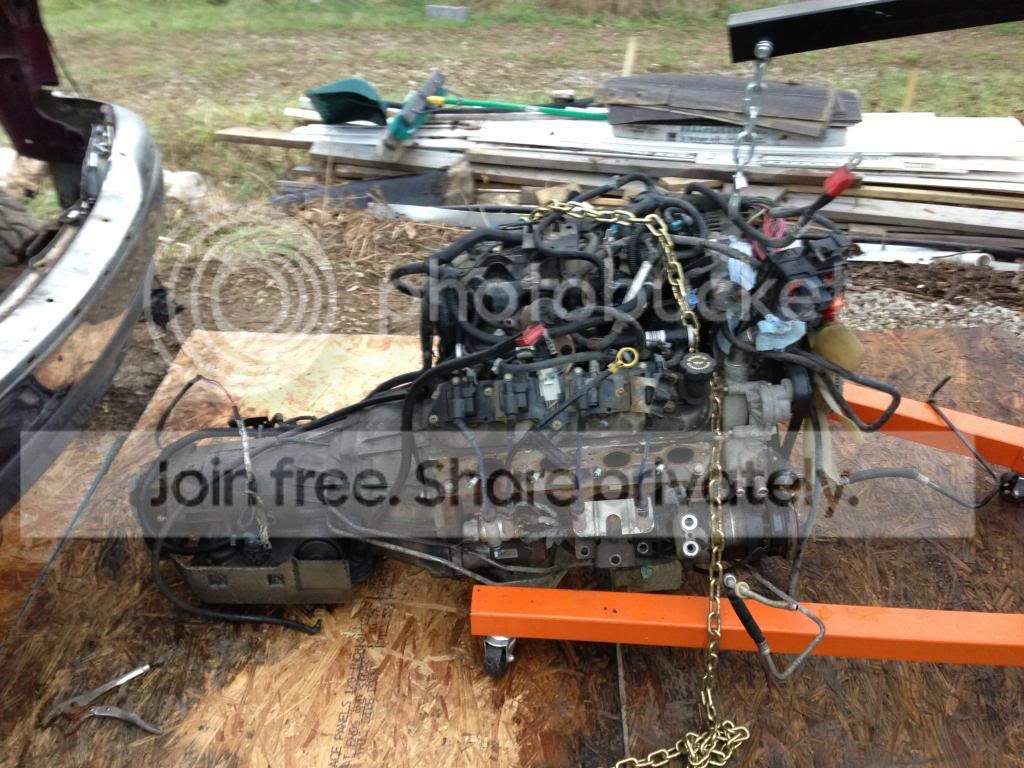

Motor out and ready to pull the factory wiring

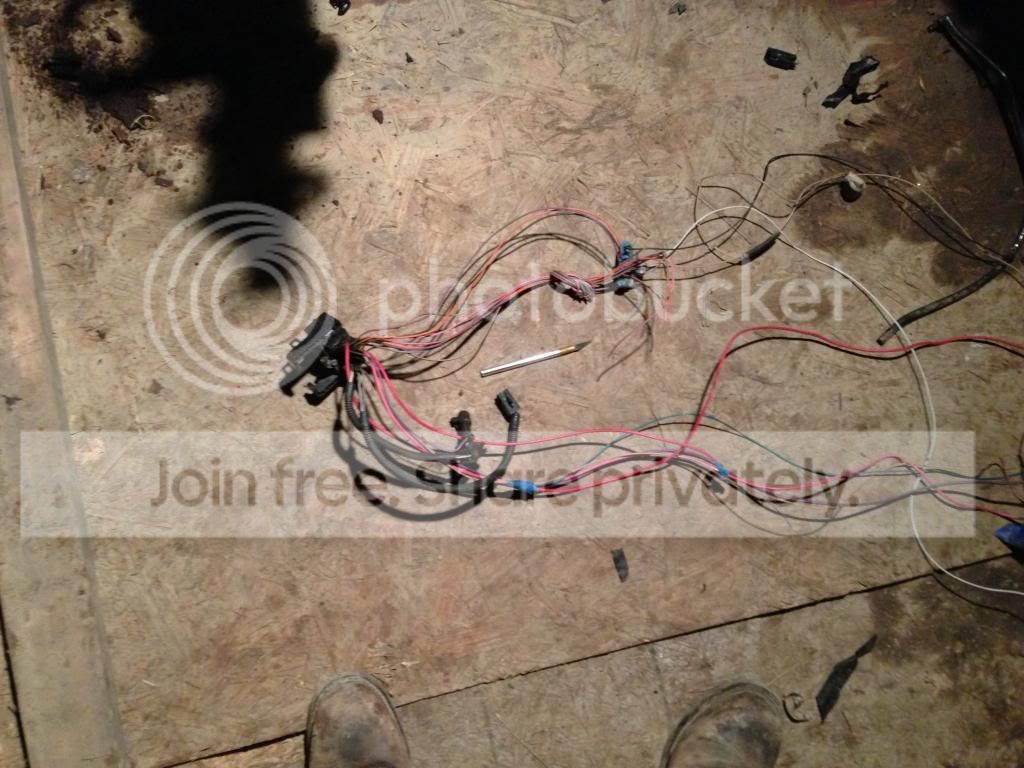

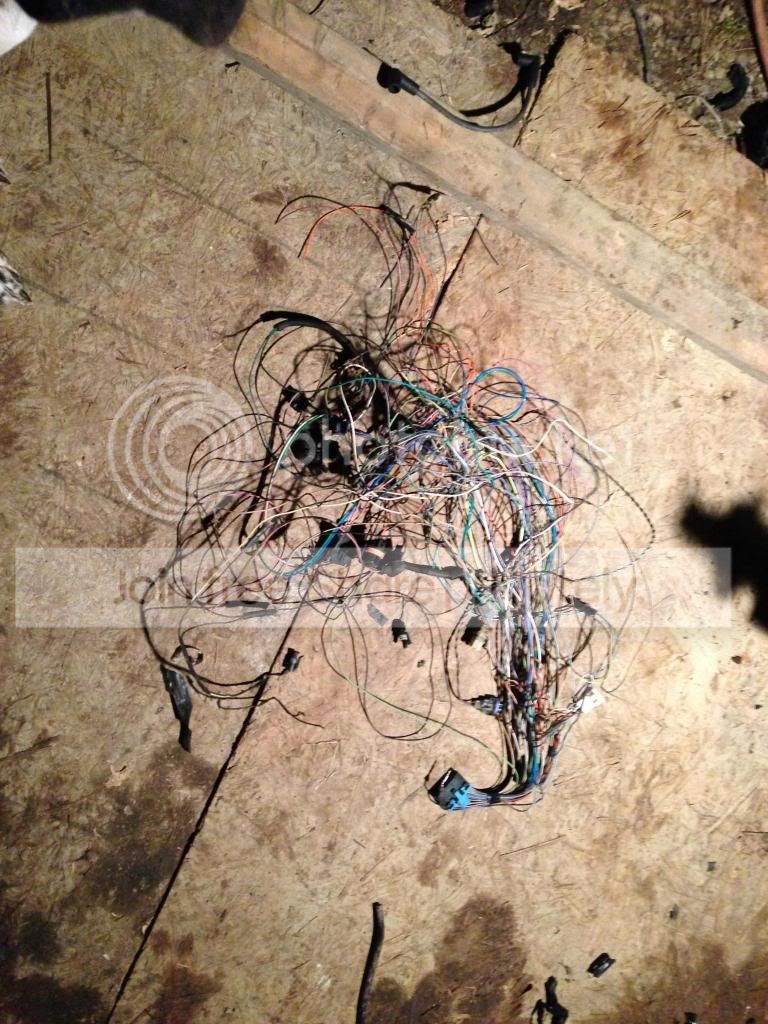

All the factory TBI harness out of my harness
My stock harness trimmed down

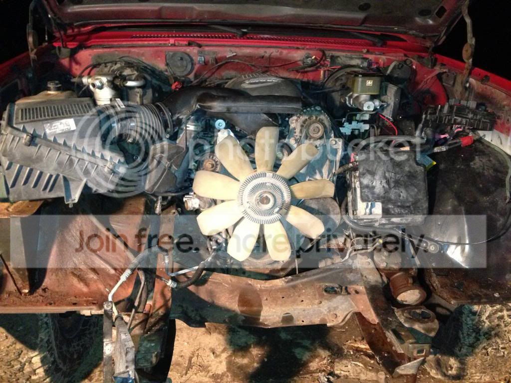

Starting to stuff it all in
TA DA

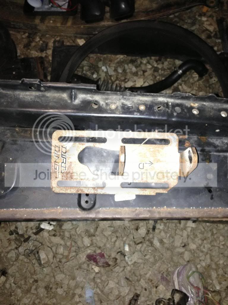

Thanks guys. For motor mounts I'm running some old dirty dingo ls swap mounts. I was gonna run them on my 6.0l 79 bonanza but they seem kinda weak for my liking. I get stupid offroad sometimes lol.

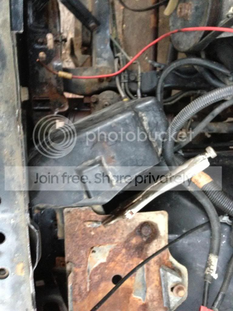

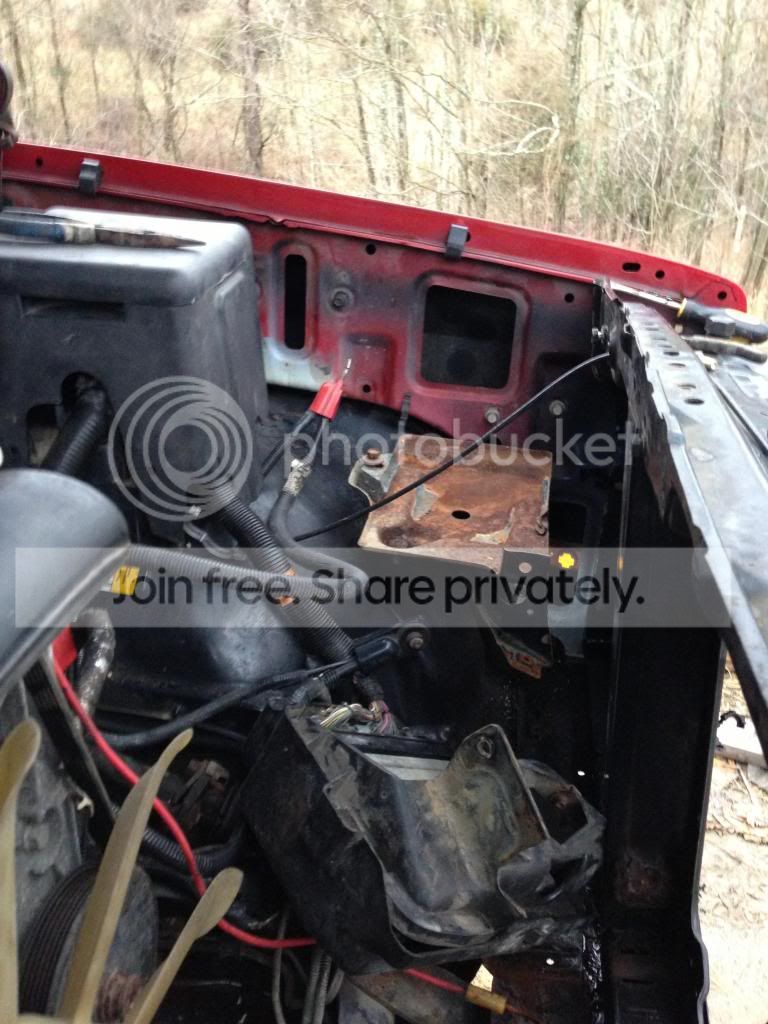

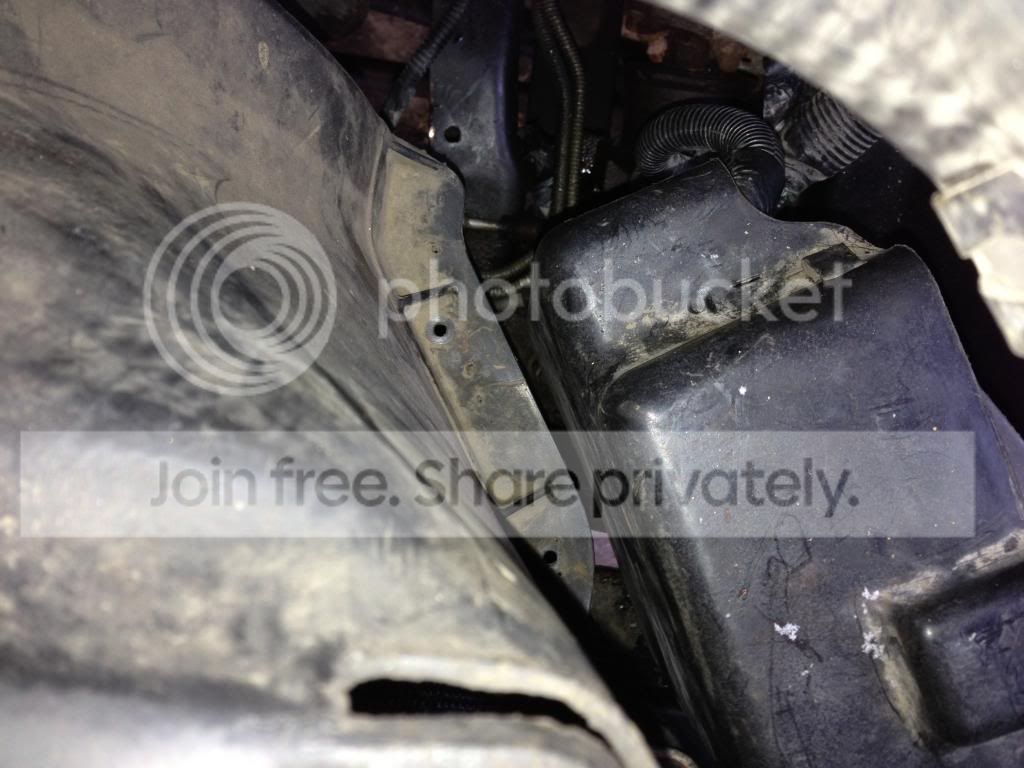

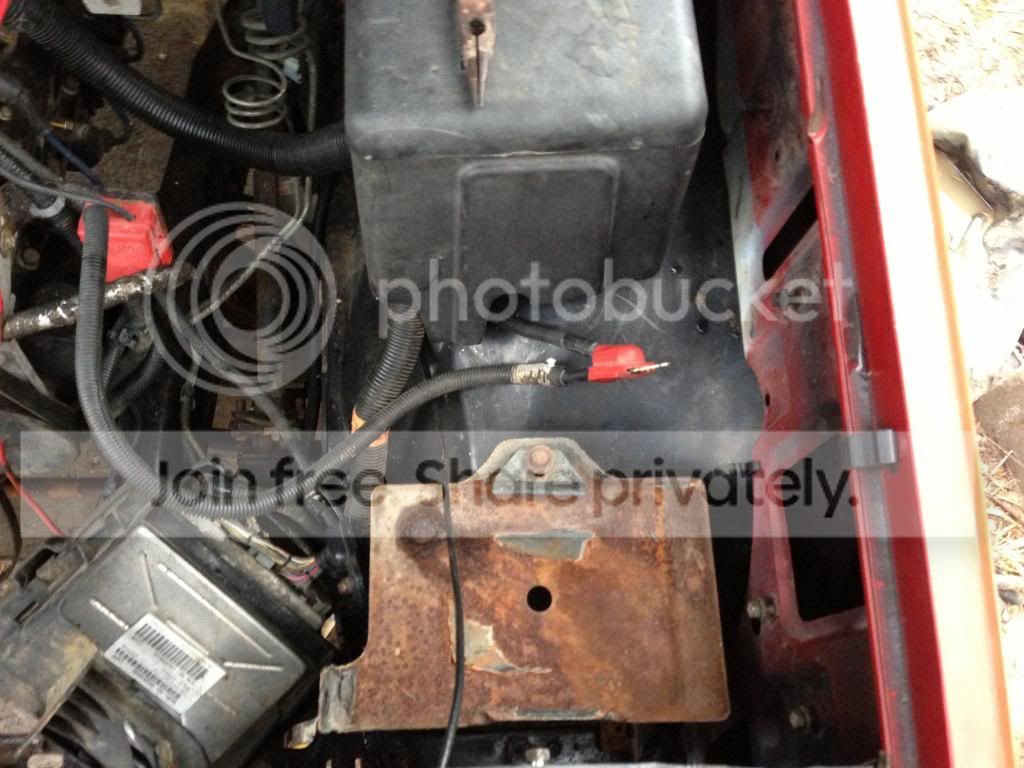

I didn't get much done today just fitting a battery tray in and roughly mounting the computer. Also got my core support in again
I'll prolly mount it alittle bit more solid than that lol

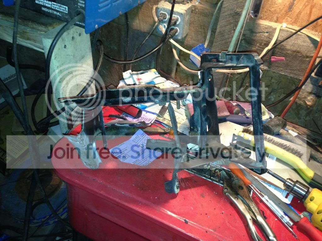

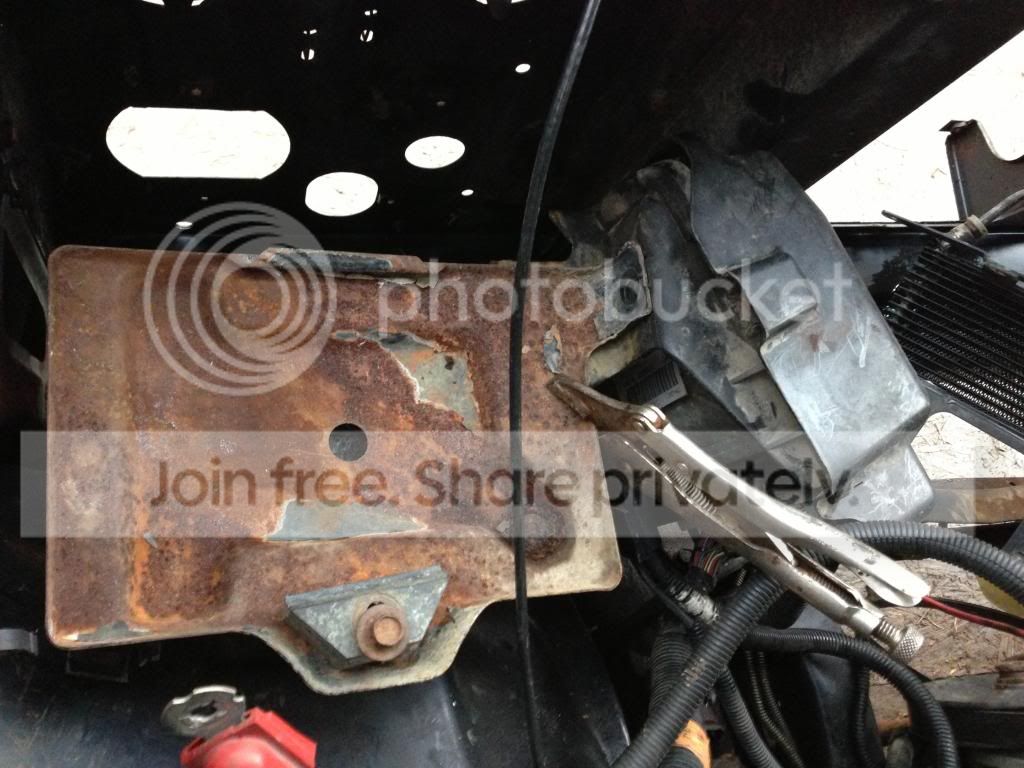

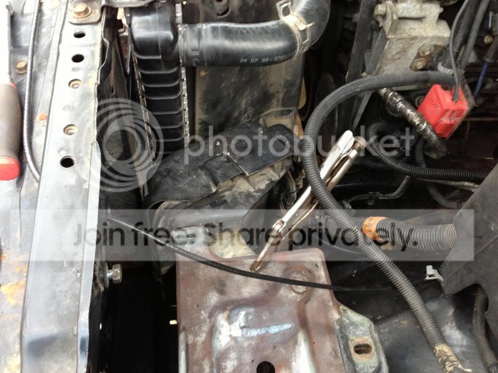

Well I just spent more time making my battery tray more solid using original parts so it looks factory than I did actually sitting the engine and trans in.
So for a factory look here's what I did, I took a 95 1500 battery tray, cut the bottom half of it off except for the top two fender bolt holes, then welded the support off a 79 battery tray to the bottom of the 95 after some trimming bending and multiple fitments.
So now I have a factory looking driver side battery tray that looks like it came out of a new body style Chevy.

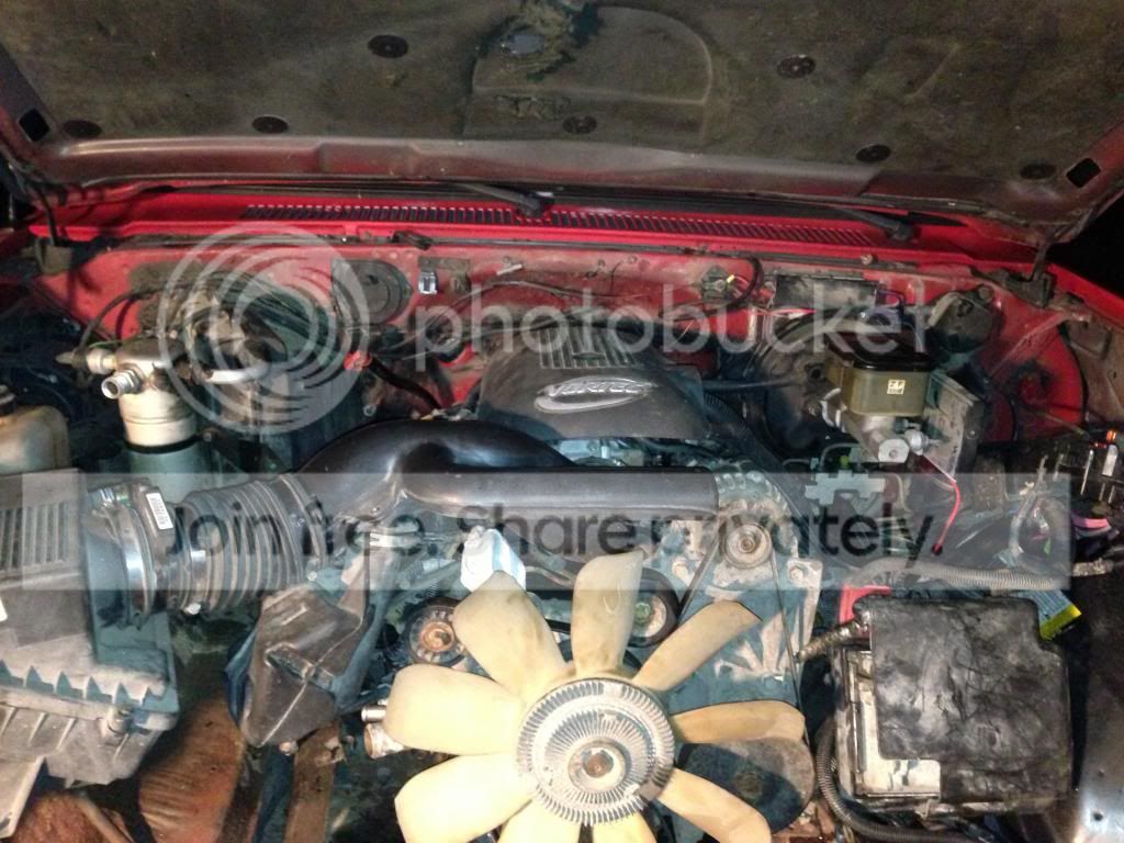

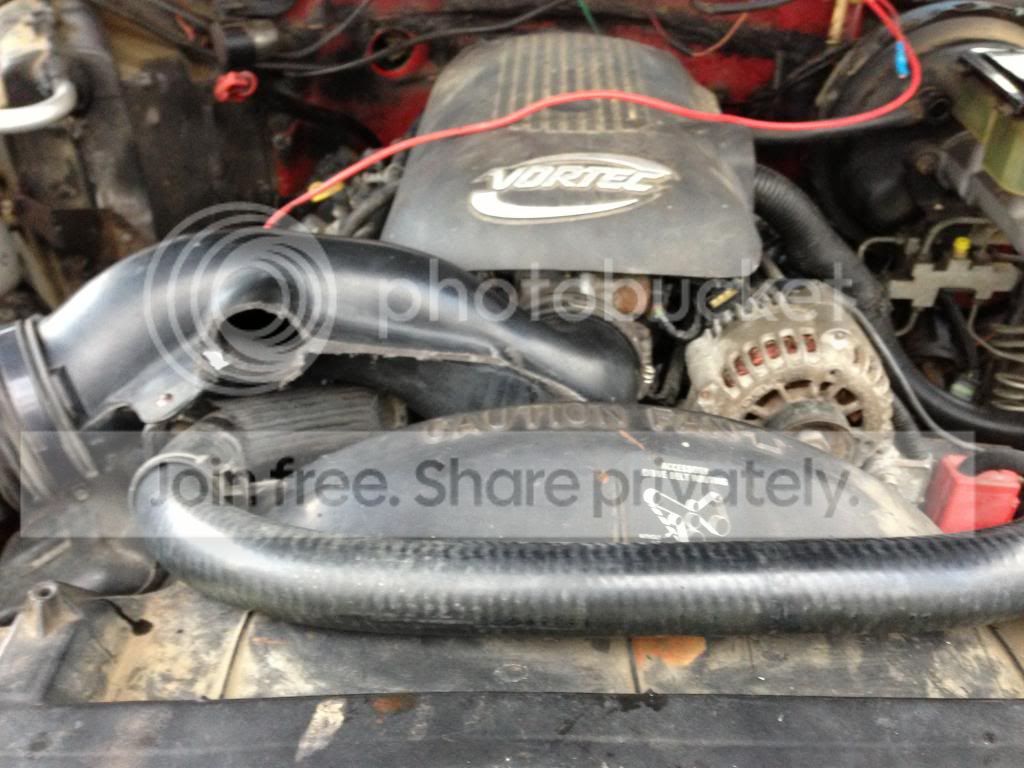

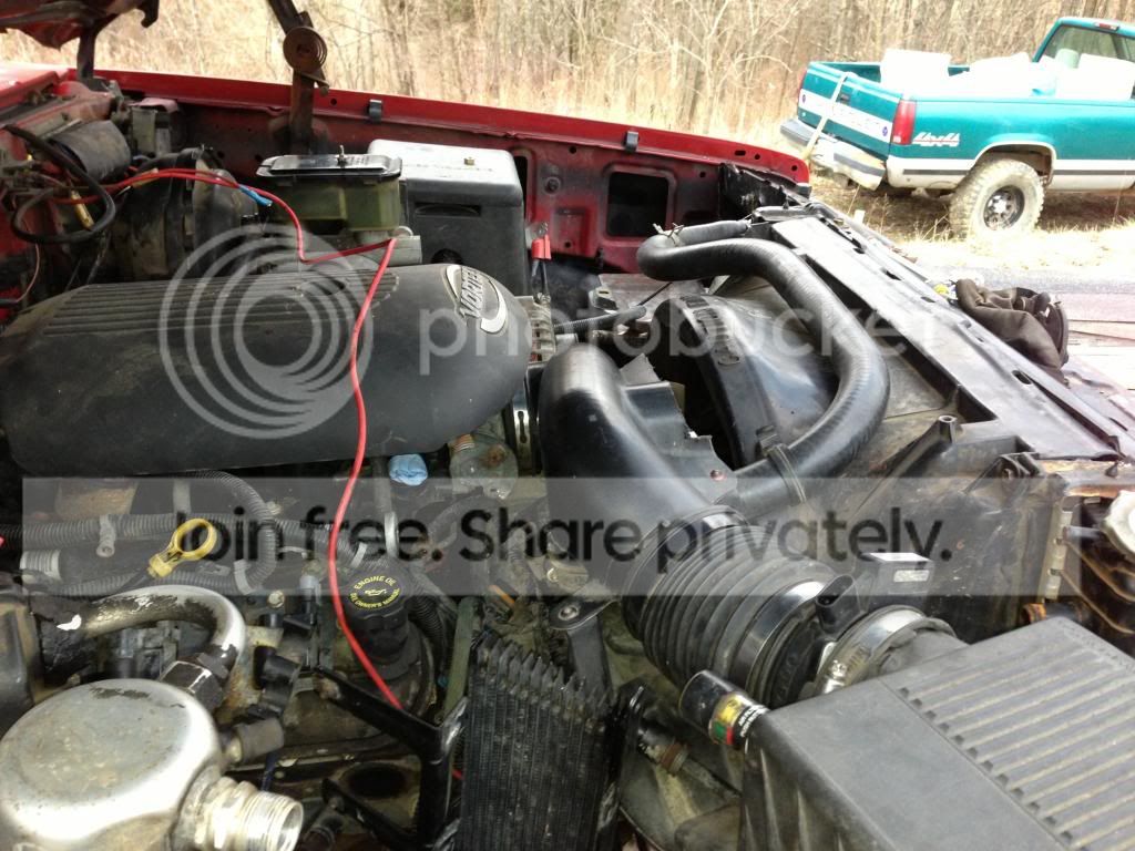

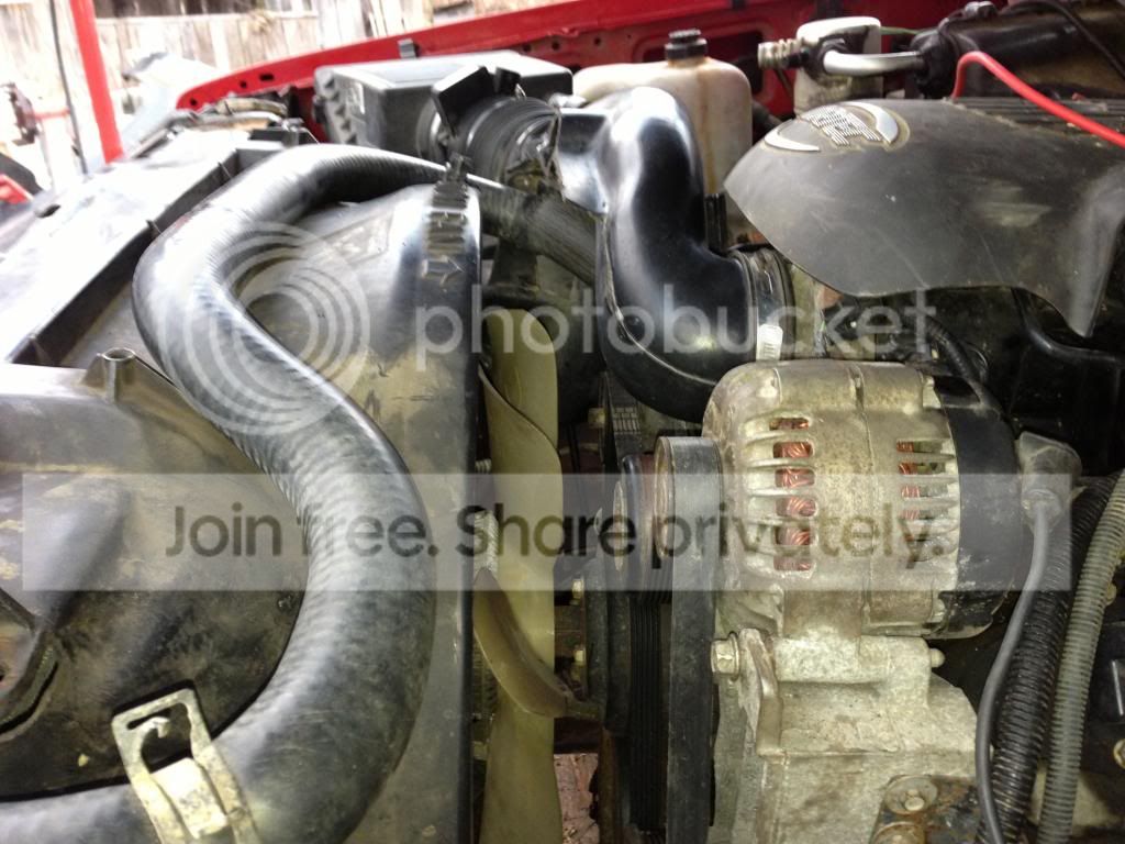

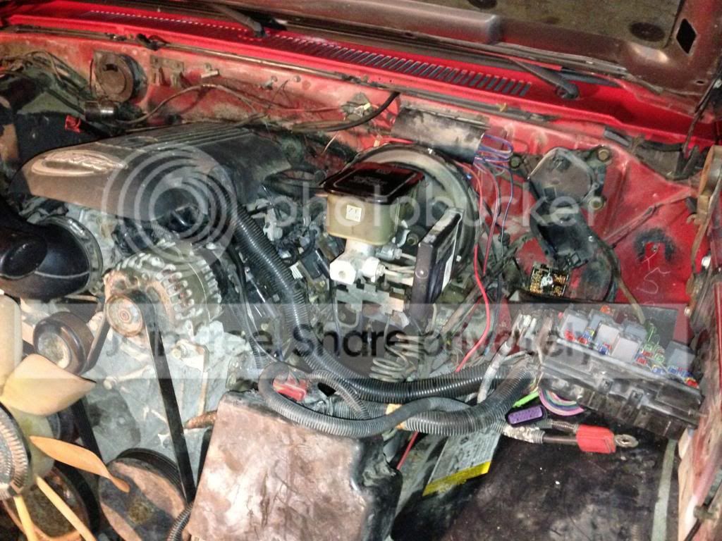

Okay not much of an update just checking the fitment of the fan shroud and computer mount etc...
Idk if this will help anyone with their swap but that's how everything fits together. There's hundreds of different way to do this swap but I did mine trying to keep it as factory looking as possible.

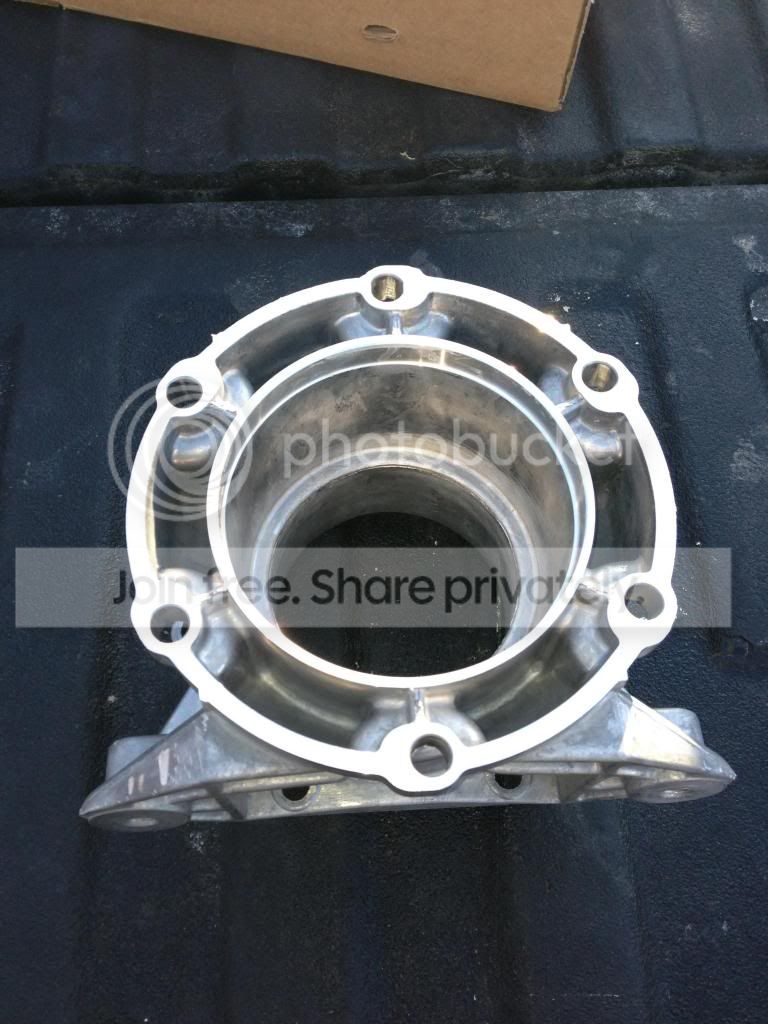

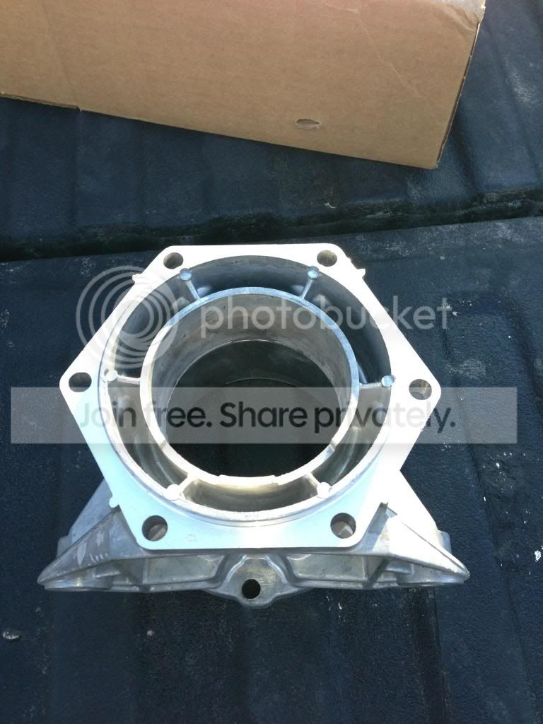

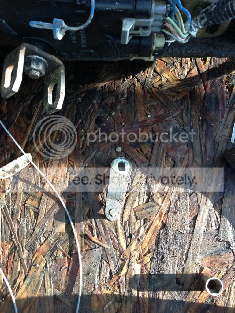

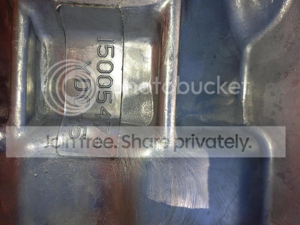

Thanks guys, I didn't get too much done today but I did go pick up my transmission to transfer case adapter. If anyone wants to do the swap its super easy with minimal wiring for a Ls swap. If your lucky like me and had a 91 K5 with a np241 in it the adapter part number it 15005474.
Here's a couple pics
As you can see the np241 is a 6 bolt bolt pattern and the transmission is a 6 bolt pattern. I think the adapter comes factory in late 90's trucks with a factory 4l60e np241 combo.
Here's my battery tray / computer mounting. Don't look at my welds to close. I'm welding with a really junky flux core welder with rusty flux core wire. They look like junk but do penetrate lol

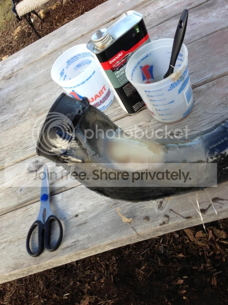

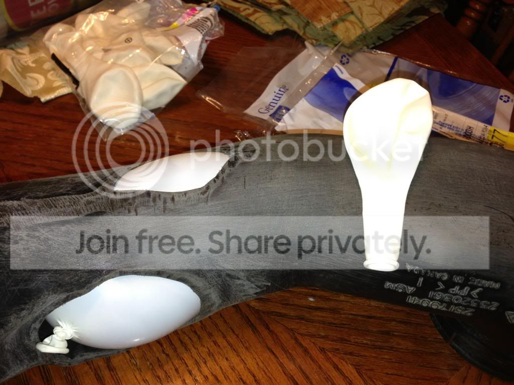

Well here's my intake tube repair
The easiest way I found to fill the holes with something to build on is to just blow a balloon up inside of it.
And yea I got it pretty messy but I'd rather go overboard than skimp on it so what the heck lol
