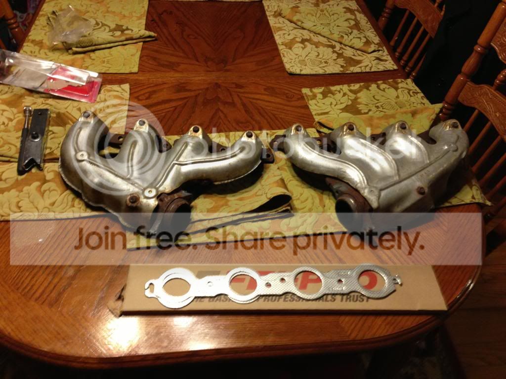

Well I'm picking up some 04 gto manifolds because I can't seem to find any trailblazer SS manifolds anywhere. Plus the gto manifolds are a pretty good deal. Only 50 bucks.

I like the manifolds, but when my wife walked past the computer and saw the pic of them on, what I assume is your dining room table, my wife shot me a look and warned me that if I ever decided to follow your lead, I would be sleeping with the fishes. :haha:

Haha yea well I'm single and never use the dining room table for anything soi figure it works good for showing off parts and mock up on smaller things lol also a prime wiring location if you have a bunch of soldering to do.

2004 GTO LS1 exhaust manifolds I picked up for 50 bucks on Craigslist. Should fit pretty good.
How did the GTO manifolds work out? I've seen a lot of people needing to notch the frame to fit the truck manifolds and am looking around for other alternatives...
Mine wouldn't clear the factory engine crossmember. You can run stock 5.3L manifolds, it's just a tight squeeze.
I have a ord high clearance crossmember now but I haven't tried them out yet, I'd say they'd fit no problem with that
