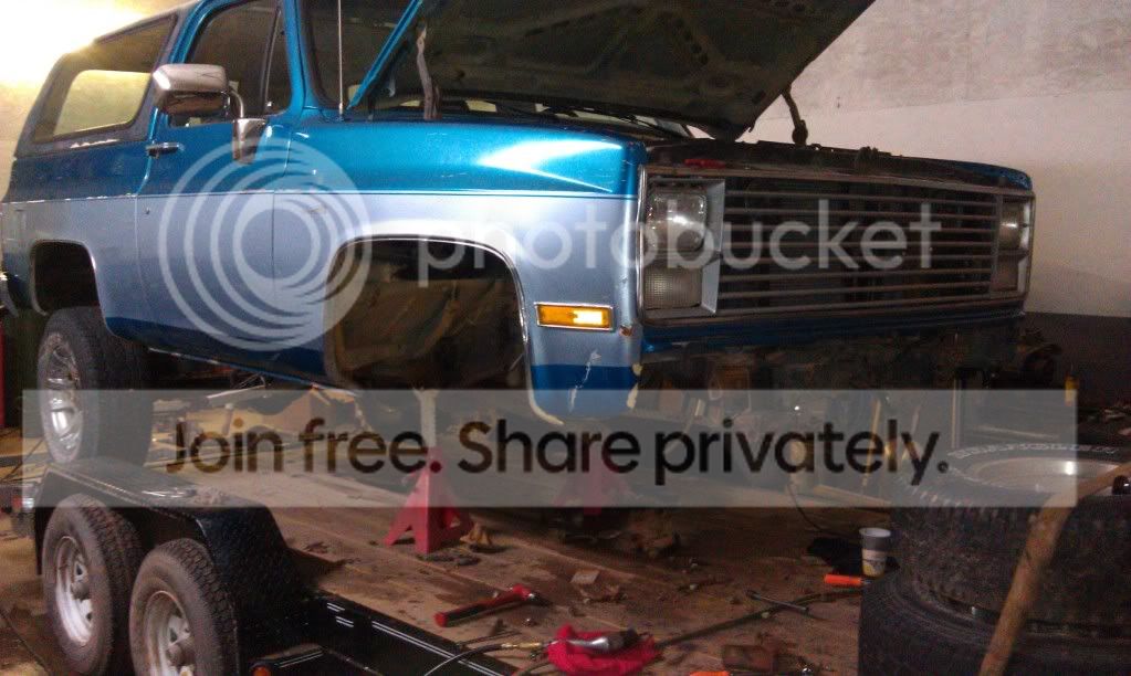

Then Loaded up the k5 on the trailer and backed it in the shop
THe old 52s were weak and sagged really bad. also leaned to the drivers side quite a bit.
Befor

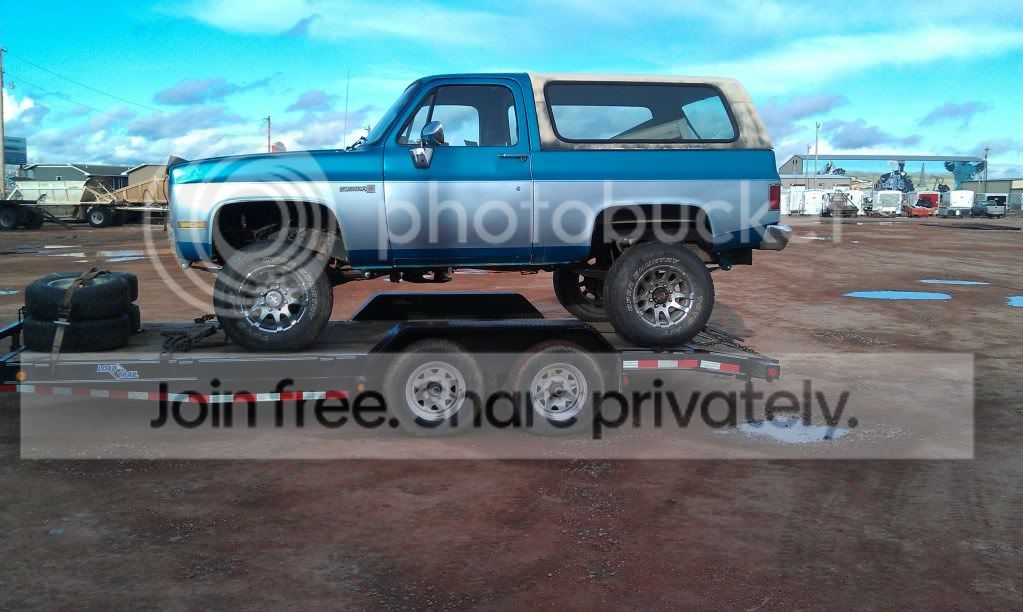

Installed the Shackle Flip, 56s and the 14b. Put some of my 285s with som blingin wheels on it for now.
Axle now 4"s farther back.
Here is the HOT ROD pic

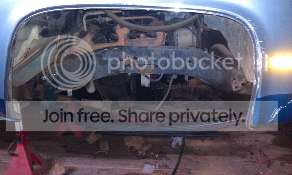

Got the front end stripped tonight, suspension all out inner fenders bumper n steering box all out. Moved the front spring hangers forward and installed the DIY shackle hanger. got the springs hanging there just need to get some 9/16 bolts tomorrow n it will be ready for the 60.
