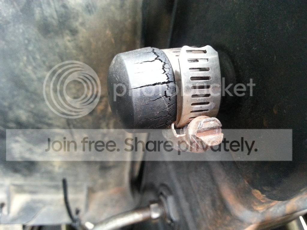

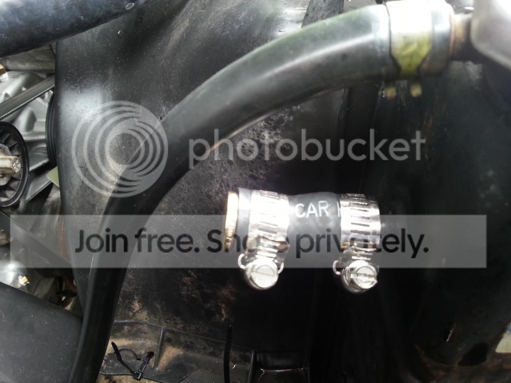

Today was a good progress day! Finally got a temp sender for the gauge so I can know how hot it's running without reading the computers sensor. Replaced my radiator heater hose cap with a plug (not as clean but much more secure), put the stereo in, and finally drilled the rest of the holes for the aux battery tray. Wasn't a fuzy feeling when I would hitbumps knowing the battery was only asupposed by two bolts in the fender sheet metal. Now it's solid!
Here is the old cap that cracked out hard in only a year.
And the new setup. It's a brass pex plug from Lowe's.

I had the exact same BS plug and did the same fix :thumb:
I had one of those type caps on my steering reservoir and it never made it out of the driveway.
Good motivation for the rest of us to see your 'burb come out so nice and clean. Great job!
I dont trust those rubber "caps",they aren't made of good rubber,no cords in them and they split & crack like that and fail in no time..I trust a hunk of heater hose and a bolt shoved in it a lot more,even if its not as pretty!..
I've seen some nice engines ruined because one of those caps failed and they overheated...
