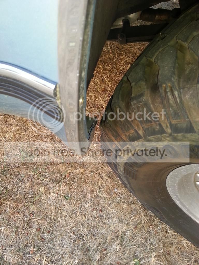

Could you post some pictures of the front wheel wells? As referenced in Muddysub's thread, I'm interested to see how much clearance the 285/75R16 tires have on stock springs.

For tire clearance, there basically isn't any! It rubs on the passenger side pulling into driveways. That would be cool to cross paths!

So this is the passenger side rear of the front fender with the tires turned i guess about 30*. You can see, it gives the fender a little kiss some times.

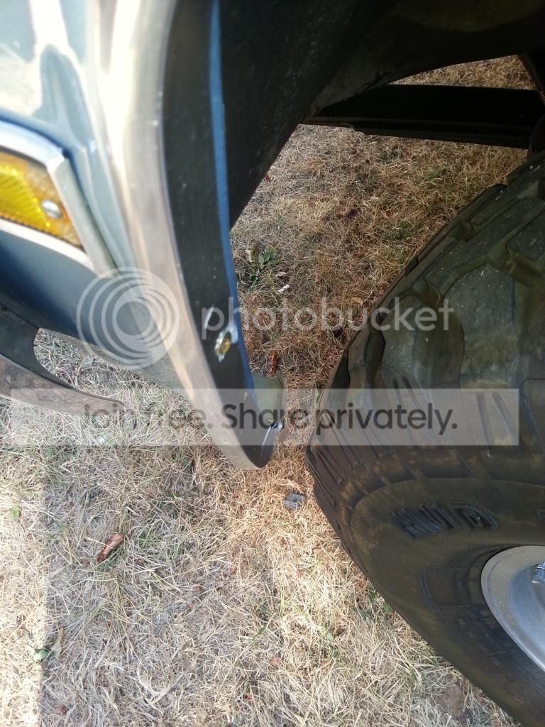

This is the front of the driver fender with the tires turned the same amount. Still close but doesnt rub.
No plans. It really just kisses it enough to make noise. It's done since I bought these tires years ago.

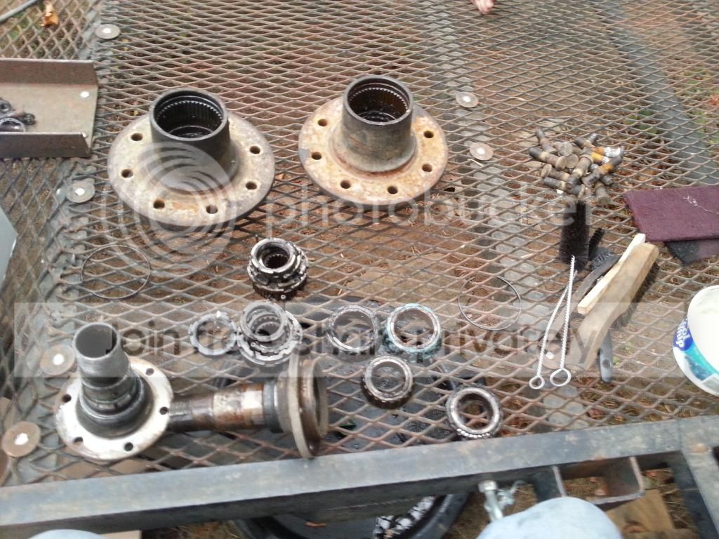

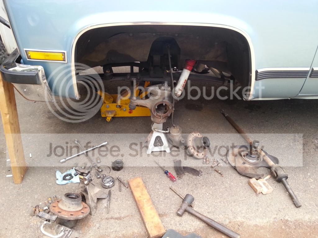

Finally getting around to the front brakes! One rotor was crazy warped and the other was going to be right at the low limit after turning so I just got two new rotors. Doing pads, seals, and re packing the bearings along with new u joints in the axle shafts.
My cleaning station. Makes it super easy to just let the nasty drip through the expanded metal and into my drip pan!
