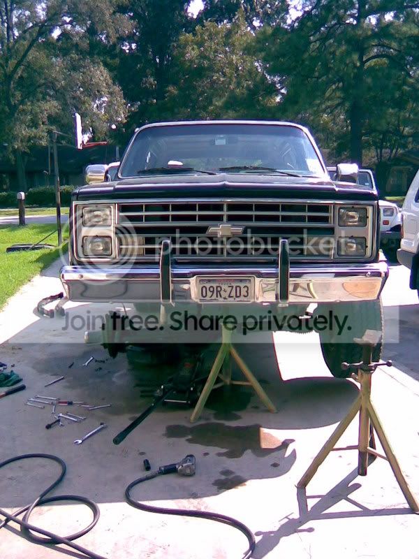

Well i purchased a 6inch procomp lift for my truck, to replace the 2 inch tuff country lift. I took as many pics as i could. They were taking with my phone so not real good pics.

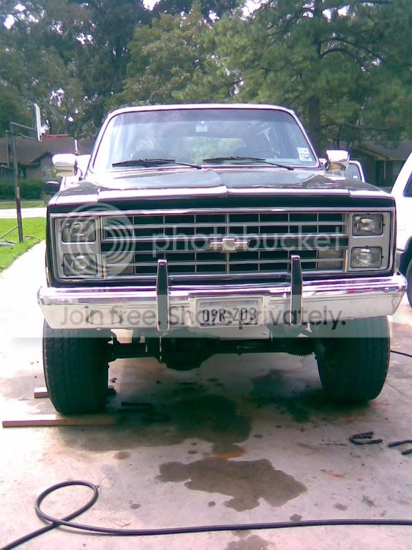

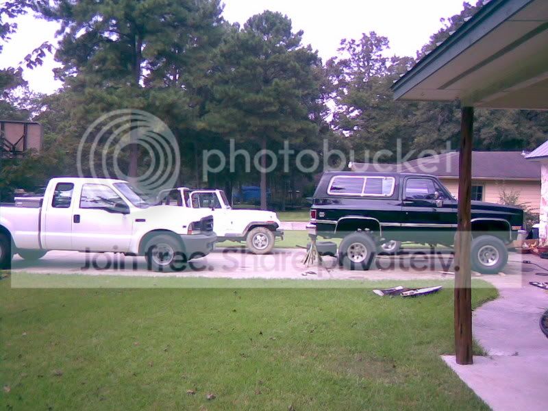

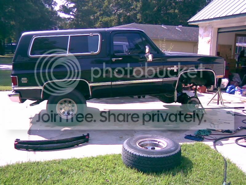

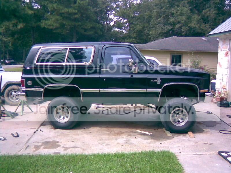

Here is the truck before the lift about 2 years ago. looks the same but with a couple scatchs now.
And now the work begins

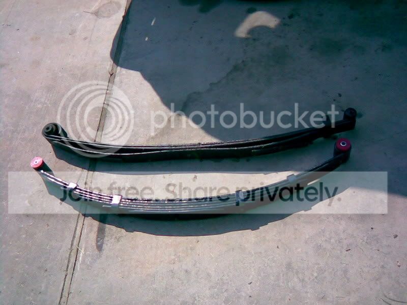

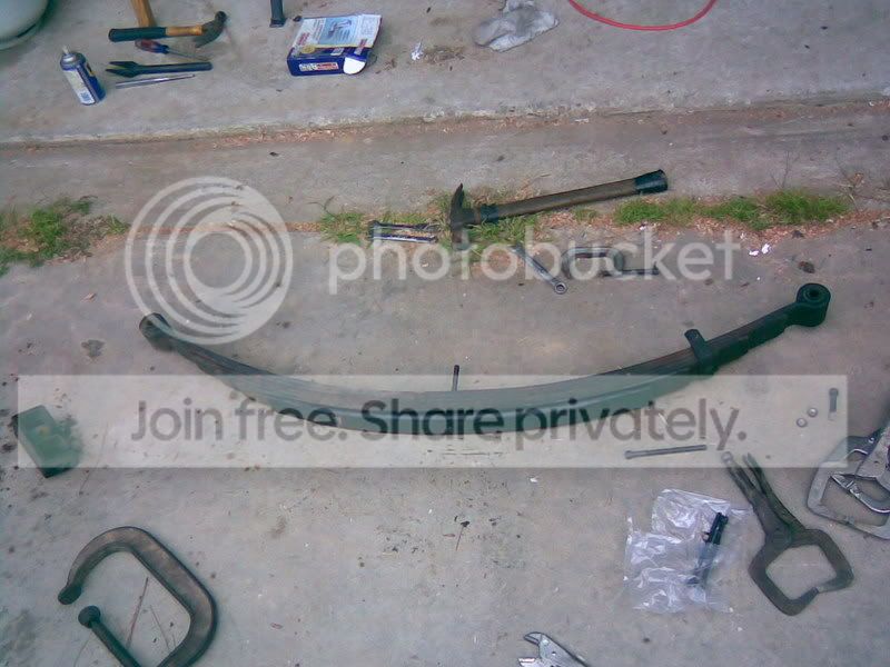

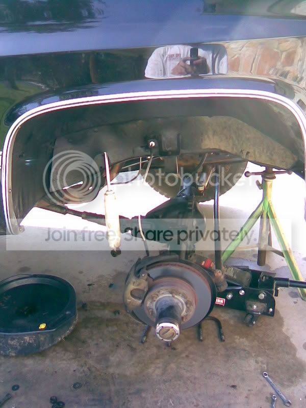

the differnce in the front springs

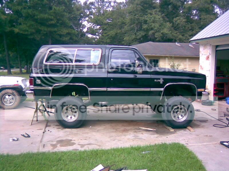

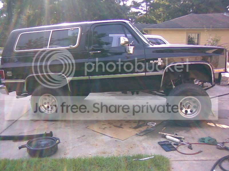

One side done

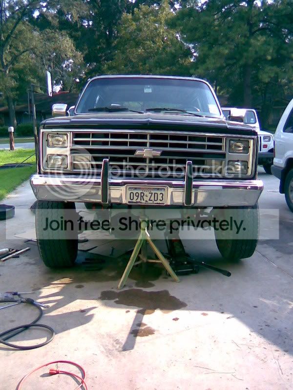

front done

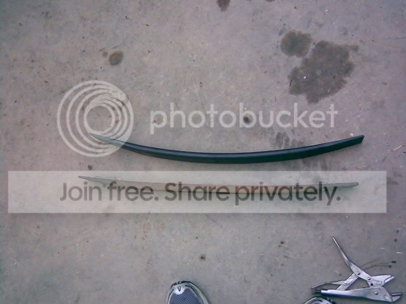

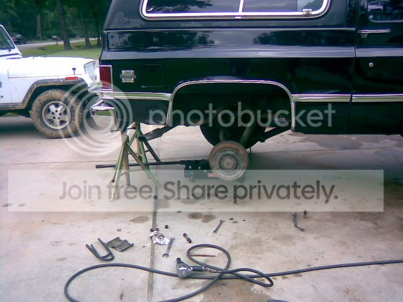

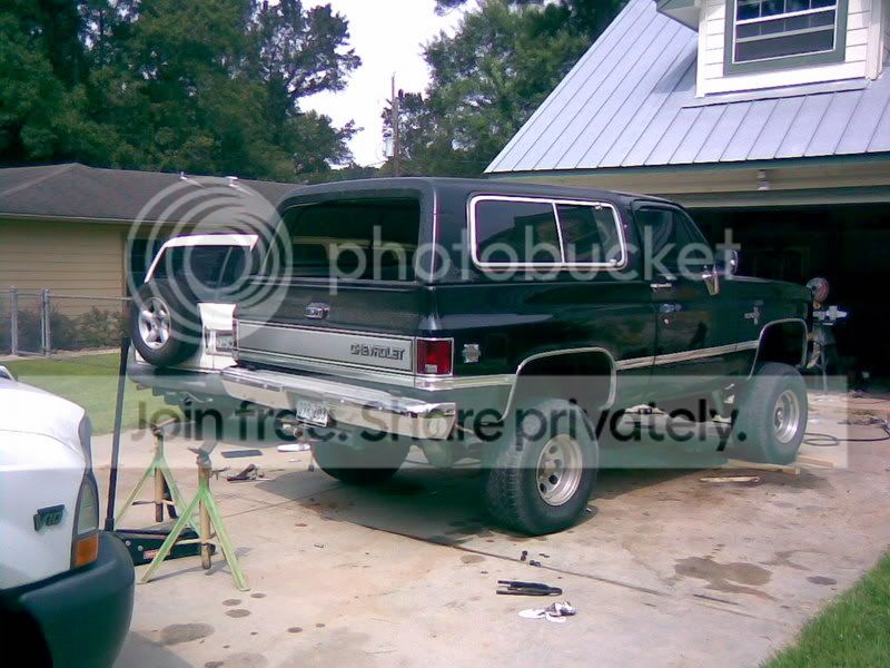

Difference in the back add-aleafs
Add-aleaf installed

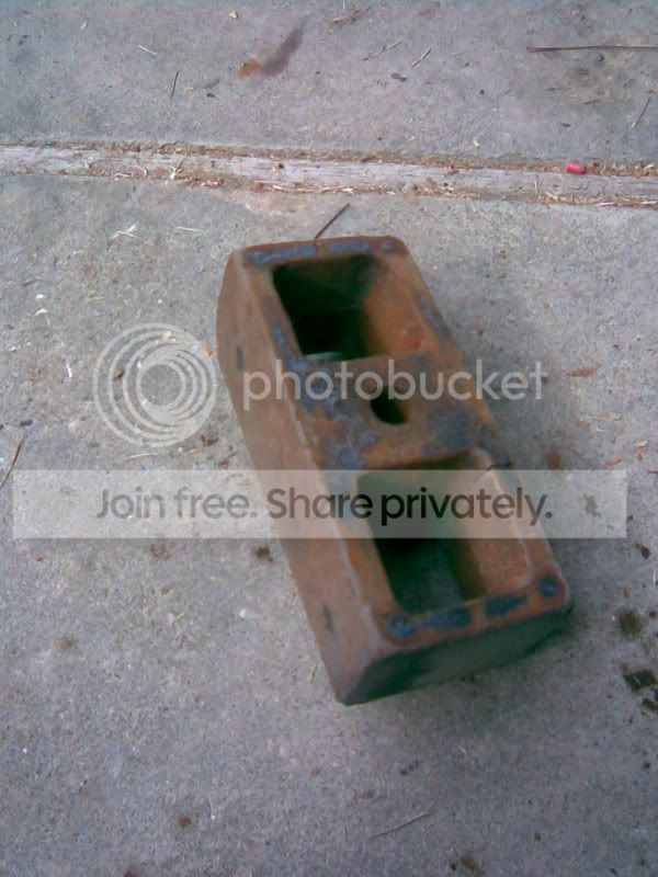

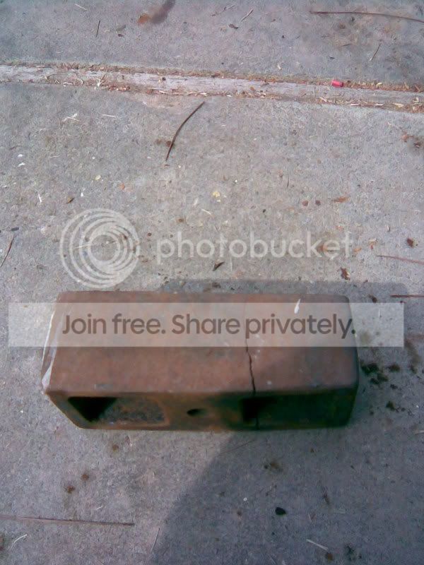

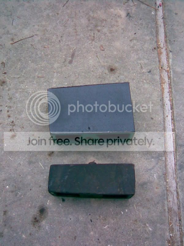

Diference in blocks

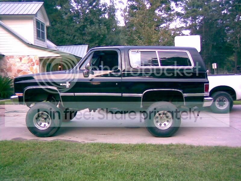

JohnDeere said:
This is one of the damn prettiest K5's I've ever seen.
I'm normally anti-chrome on trucks, but against black (my fave color combo) this is just badass.
Makes me reconsider my plans...

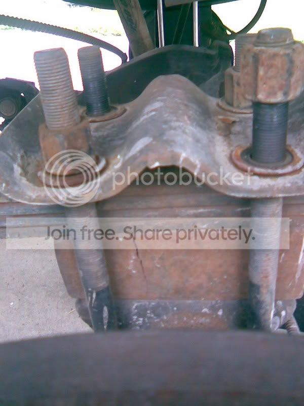

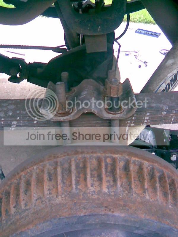

Whats wrong in this picture besides the ubolts being lose
closer picture
and closer
and done
Took 2 day cause i was havin a hard time trying to get the steering arm off. finnally gave up and am going to get the guys at the drive shaft shop to take it off when they extend my drive shaft. Now to got some new tires. Im thinkng of 36/12.5/15 TLS.
Woah, very clean truck. Don't see very many around here nearly that clean :o
I got a quick question. I just got done reading the instruction to putting the lift on (i know your spose to read them first) and it said to tighten the u-bolts to 55-65lbs and i tighten them to 125lbs. Is this going to cause premature failure?
Wow, you need some bigger meats on that thing now. That's a super clean K5. Nice truck.

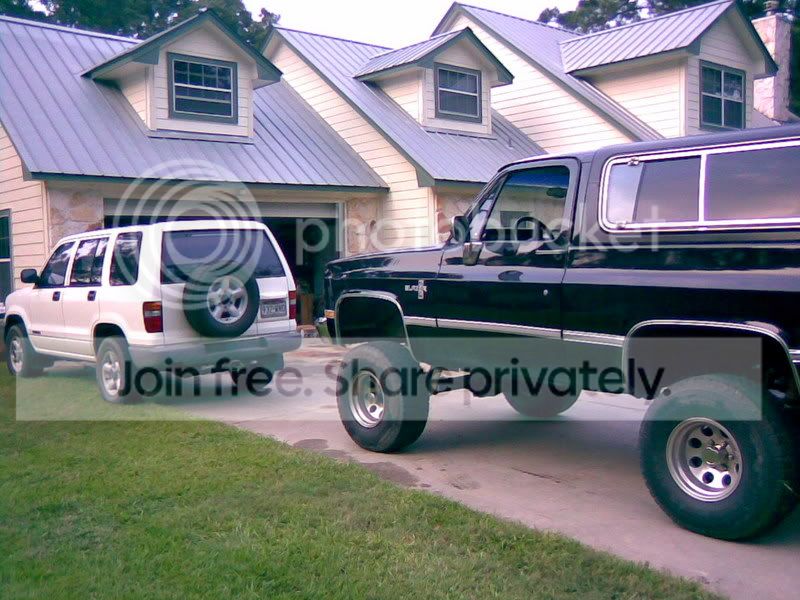

I went with the Procomp 6inch lift. Front is 6inch springs. Rear is 4inch block and 2 inch add-leaf, but it more like 5inchs of lift for the back. I dont really like the way it sit cause its got saggy butt. In November I`m going to put in 3inch rear springs and use the 4inch block. Hopefully it will level it out or make the rear sit up alittle higher.

triple torque them ubolts!! 150+ft/lbs i have my procomp front springs and i like them, they actually flex allright.

Second get rid of the blocks & get a shackle flip.
The old blocks were cracked, think about it ,could happen again.:doah:
I want to get rid of the blocks, but if i get a shackle flip it will enterfear with my exhaust and i like the way it is now.
