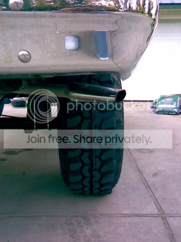

Got my Tires to day.
But they look to narrow. So im going to take them back and get the 14.5 instead.

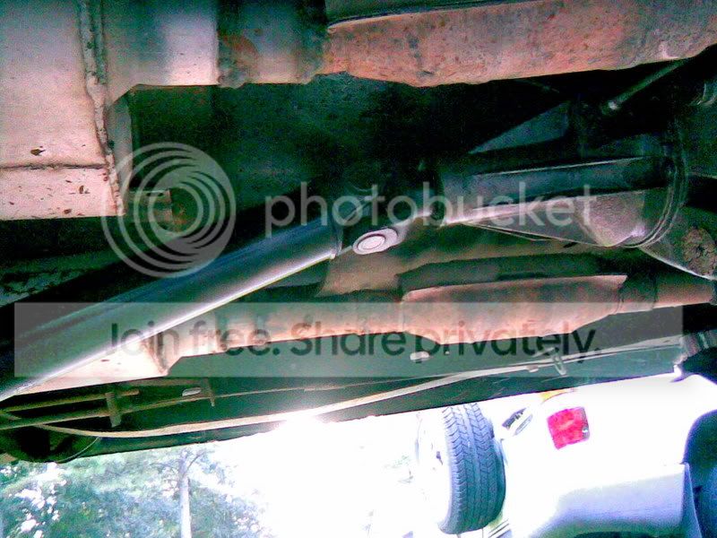

I fixed my ujiont problem by lowering the transfer case but ran into another problem.
The drive shaft is to long. Im going to take it back to the drive shaft shop to get them to shorten it. I told him not to make it to long cause i was going to lower the transfer case. So will see if i can get it done for free.
nice lookin rig now man, and definatley get that shaft taken care of. did you tell him a measurement or did they take them? but dont lower the tc if you dont have to. and it looks like you dont.
I took the truck to them and they took the measurments but the TC wasnt lowered. I told them that i was going to lower it. So they should fix it for free I hope. If not I think its $20 bucks.
looks like it already is lowered, look on the right side of the pic
Yeah I lowered it. It was making a draging noise when there was no load on the driveshaft because of the drive angel.

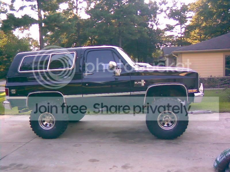

And thanks for the complaments guys. In about 2 years I'm going to get it repainted and the whole interior redone and make it a show truck.
I hope in 2 to 4 years to have everything replaced or rebuilt. except the drivetrain just finished that.
make it look like this??
Lol thats almost what I want it to look like but black. The only thing i dont like on that one is it has to much gap between the tire and fender and the side molding. Plus I love my 85 grill.
