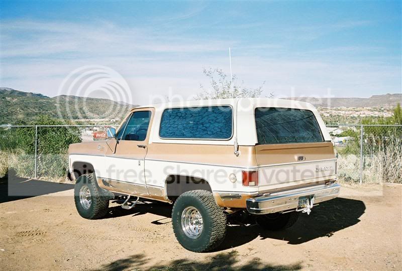

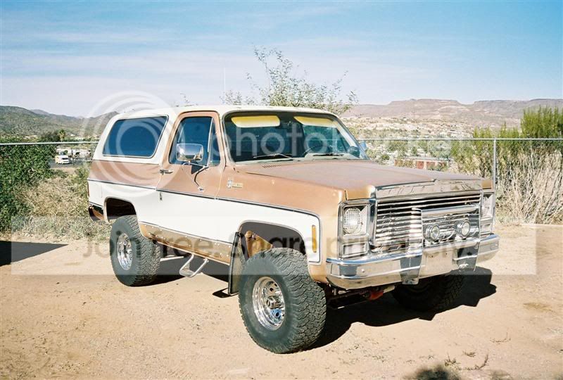

Edit: 05/25/2008 - This is the Blazer as it sat when I bought it:

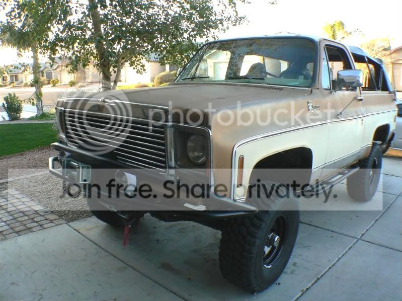

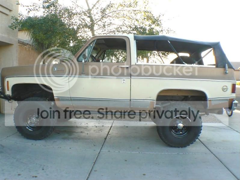

This is what it looks like now, well at least close to it - This is before I built the rear bumper:
