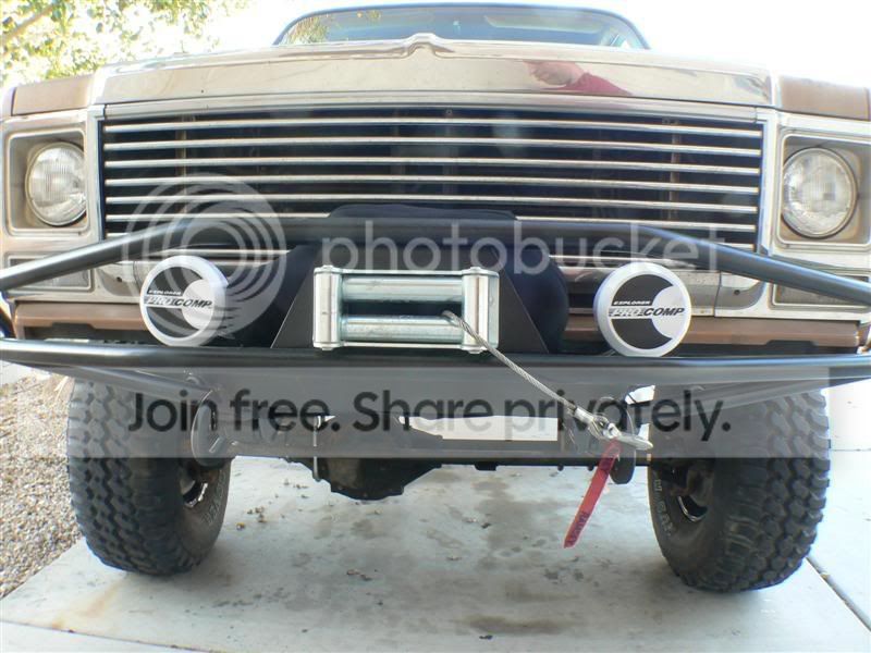

I know this sounds like something you should not have to do, but fill the allen heads or at least put a good tack weld on there.
we used star point bolts on my friends toyota when he replaced the winch after his fisrt one got ripped off..well someone stole the new one too:mad:
if someone sees the allen heads, they will just come back with the right tools, you dont remove the winch that often I hope, so having to bust out a grinder should not be that big of a deal if its keeps your winch yours.
I love tack welding things, the sleave on my stereo and the cae on my amp are not moving anytime soon:D
Thanks - That's a good idea. I will tack them in tomorrow while I'm working on things.

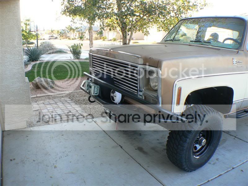

Here's a pic of the bumper with the plate in place - I'll post a better one tomorrow (in daylight). I welded up a couple of the bolts. (Supersize - Thanks for the advice.) Anyone wanting this will need to have a grinder:
the blazer looks like a nice project, its a bummer I cant be in a relationship with a blazer and keep the sheetmetal on it:( we just dont agree about it:D
the bumper should stay put as long as you and your nieghbors are not heavy sleepers:thumb:
I want that bumper!! And I have a grinder ;) :hack::grind:
J/K, but that thing is sweet. Wish I had the skills and equipment to make a bumper like that.
Thanks
Here a couple of pics in daylight with the thing all done and mounted.

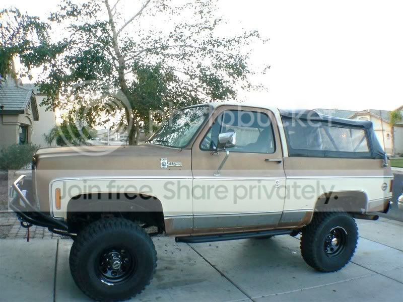

:saweet:I picked up a soft top. Its looks brand new. A STC fast track for $200.00. :cool1:
Now I only need the instructions to install it.
hey the build is looking great - nice work, but remember - all work and no play... Hit the trails and test out the new parts and take some pics. I am hurting for some warm weather and to see the dirt again. Snow is nice but it gets old.
You have no idea how right you are. I'm going to go out next weekend to hit some trails. I am taking a few days off in 2 weeks for the same thing.
I got my soft top on today. It was missing the four brackets that mount the bows. Thanks to ryoken for providing the dimensions.
