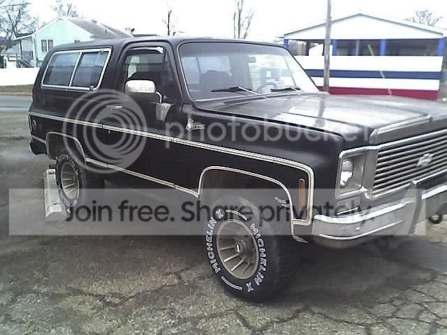

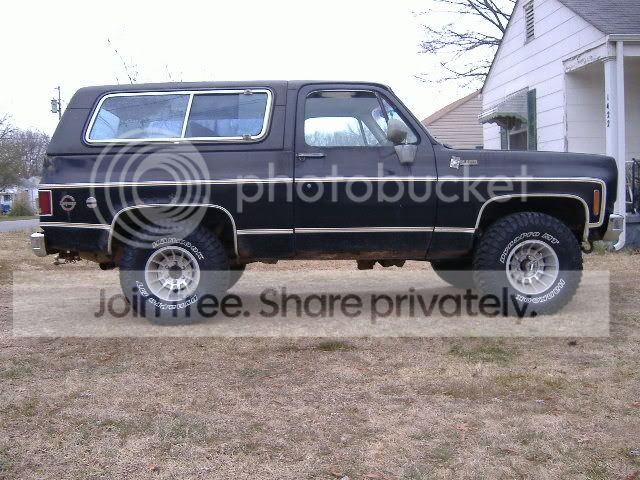

started out with this K5 i bought last March...heres how it looked when i got it
bought it for $1200(down from the $2000 asking price) it had a few issues mainly 2 spun rod bearings and a busted tranny(bellhousing had been welded at some point from one side to the other)...didnt know the tranny was bad when i got it just thought it had "sluggish" shifts
put new tires on it the day after i got it and drove it like that for a month(no louod knocking and had great oil pressure)

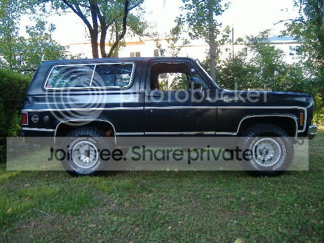

starting to look better:

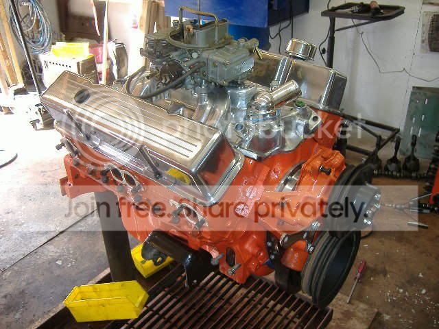

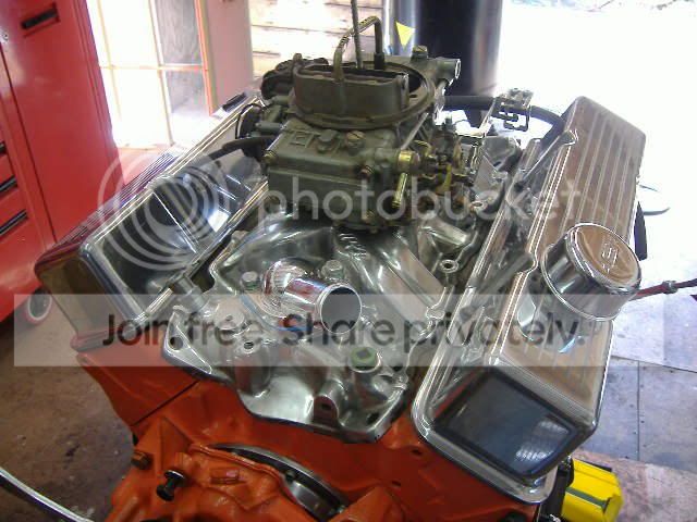

got the motor together and cleaned up and installed
went to fill it with antifreeze while my buddy was hooking up the exhaust, he said he heard something dripping into the oil pan......yep you guessed it...block was junk
come to find out my "stroker race car" engine was actually a 68 327 bored .040 with a 307 crank turned .030 on rods and mains....after heated discussion my money was refunded
this is what a big gash in a cylinder wall looks like

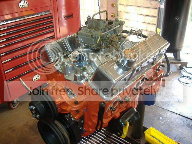

so a replacement engine was located and for a measly $100 i got a bone stock 350 4 bolt main with standard bore and standard sized rods and mains with only about 60K on it.....after cleaning every single little nook and cranny it was assembled last night and installed tonight...all thats left is hooking up exhaust, torque convertor bolts, adjusting the valves, and running one final wire for my Windstar fans

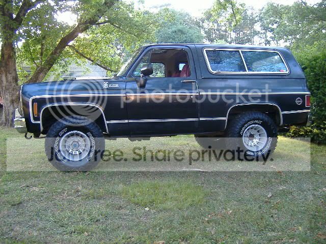

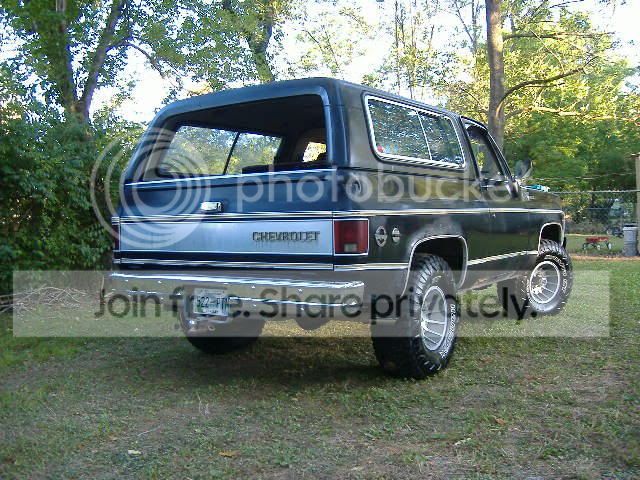

here are the pics of the final product after a month of one bad luck problem after the other
sorry for the long post....ill keep it updated as i go(which will be as money allows) future plans call for a shackle flip in the back, 4 inch springs in front, new gears(3.08's suck with 33's) detroit locker in the rear, winch, bumpers, and maybe a few other items.....i just want something the whole family can pile in and spend the day riding thru the mountains and not worry about breaking down
I think your missing a few bolts in that intake manifold?

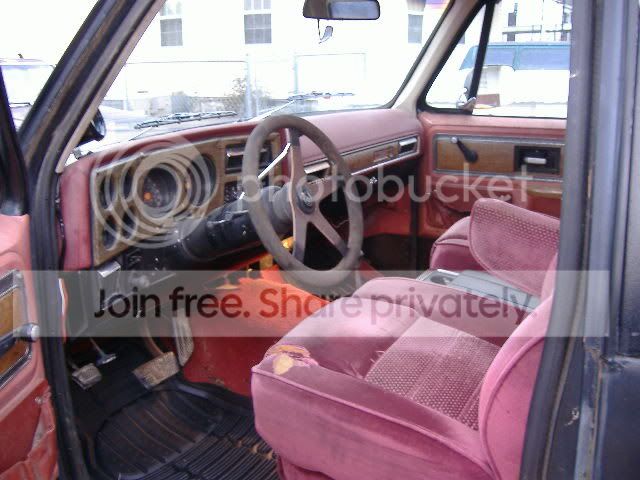

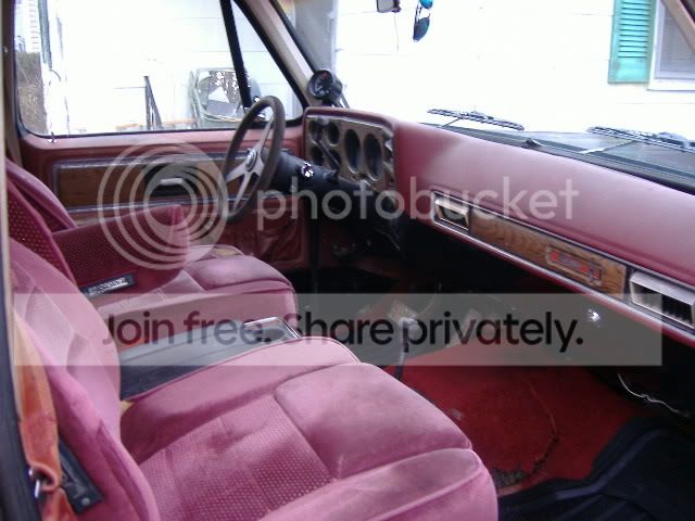

interior shots...carpet has been removed since these pics...getting ready for herculiner this spring
That's one heck of a nice lookin rig;) I'm a sucker for anything (well, about anything GM) painted black, and when you toss in a red interior and hurricane wheels, that's just icing on the cake. What was involved in mounting those conversion van seats? Did you leave the motor basically stock?
the seats were in it when i got it...it looks like they are mounted on a flat piece of steel with bolts going thru the floor and pretty good sized washers on top and bottom
motor is basically stock except for the intake, carb, cam, headers, MSD box, and the heads have had a little port work and new valve springs

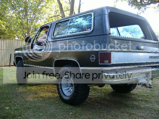

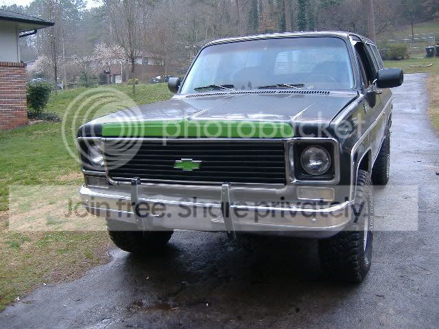

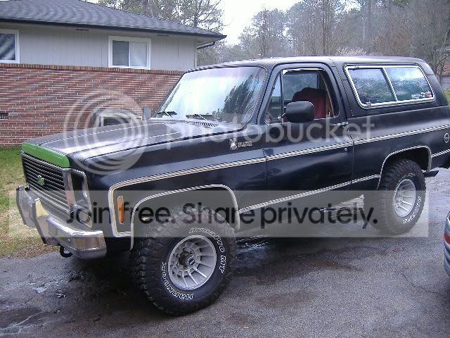

got it home today...heres some pics of it before i left my buddys house...still have some minor tuning to do(mostly off ilde stumble in carb...670 Truck Avengers are notorious for it)
whats up with the green?
The engine sounds good, but whats with the screw driver in the choke?
thats the color i painted the first replacement engine...just because i wanted to be different....planned to paint the whole truck that color too
that was before i hooked up the wire for the choke...was using the screwdriver to hold it open while we set timing

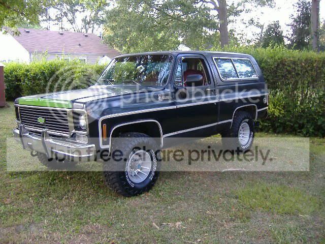

not much has changed on it since it came home other than driving it every day and getting about 13 mpg...still having issues with carb(holley sent me a brand new one no charge)

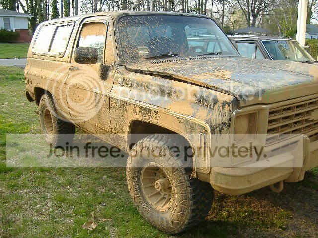

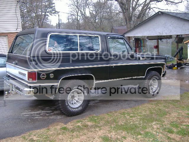

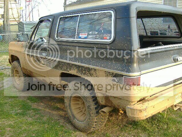

heres some after shots of its inaugural(sp?) trip offroad
replaced the rare optional "fold in half" hood with another used one(with welded on bracing) and cleaned it up some

i removed the captains chairs and swapped them for a set of late model buckets from a pontiac sunfire...they bolted right up to a set of factory brackets...ill take pics tomorrow
