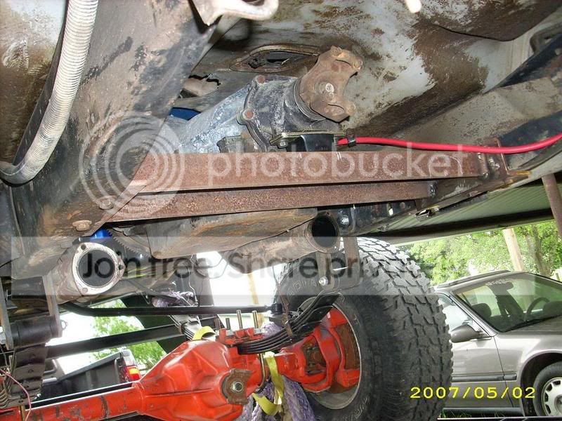

Are you just going to move the rear hanger back an inch to straigten out the shackle angle or what?

The rear shackles, I will probley move them about 3" back, I think i am going to have the shackle sitting at a slight angle maybe around 20 degrees or so, but I have to wait till I am off work again. (I just got on the tug, so I have 28 days to go)
I kinda like your shackle angle the way it is. That is the way I had mine set up. I wanted it to sit lower and I got some crazy droop out of it. not a lot of compression but as low as it was sitting I didnt want too much.

Now with the bed and front end on, engine fired up and so on I need to install the transfer case when I get off of work. (remember I work offshore, and will be getting off at the end of the month) #1 I could go ahead and fab up a crossmember for the divorced 205, drive shafts will have to be made costing $$$$$ and probley not going to find a way to run a doubler later with a divorced setup or #2 install a 400/203 i have and use factory drive shafts for a little while, plus installing doulber will be easy when its time. (i already have the 400/203, and have (2) 205's that can be machined for the 32 spline input shaft) :thinking: I know that running a 203/205 divorced set up would be some serious eye candy is it worth the money. OK now for the easy part, help me out
I have already installed a 2 WD 400 with a bolt in yoke but it wouldn't take long to change the output shaft.
this is as far as i got the last time i had time to work on it....
the only update I have is I put in another T-400 with a 203, but didn't have a X-member. No idea on wheels and tires yet. I figured I would use the 203 till i install a 203/205 doubler later, this way its a little easier to get it moving around. The other 14B is going in as soon as I get off of work in 3 1/2 weeks with the disc brakes working (i hope).
