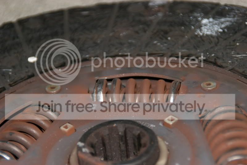

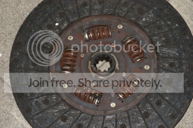

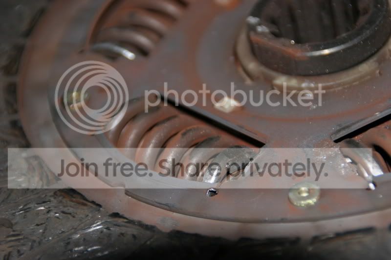

ok, so i pulled my engine yesterday, i'm doing some maintinence.
i knew that i needed a new clutch, which pisses me off b/c i bought this one last august. anyway, pulled the engine out 24 hours ago, clutch hadn't been bothered for 24 hours before being pulled. when i pulled it, about 1/3 of the fingers on the clutch looked to be permanently forced downward! :eek1: that would explain all the chatter, i suppose! the springs in the clutch disk are messed up too, as they've been riding on the flywheel! :mad:
so, i just went out and got these parts from the car and was going to take pics for y'all. come to find out, the fingers pretty much came back to normal since last nite. :mad: that'll make getting the warranty harder, i suppose. :doah:anyway, the pics show a bit:
first 3 pics show messed up springs in the clutch disk (what do those do, btw?)

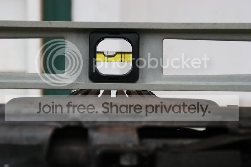

this pic shows that the fingers are still not perfect, even tho they came back enough to where you can't tell w/ the naked eye.

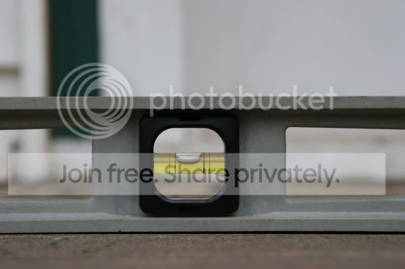

this pic shows the level on the ground directly below where i tested the fingers to prove that my surface is flat.
thoughts?

please take a pic of your flywheel bolts to crank flange. i think you might have the wrong bolts in it. i just removed a clutch as the dumby who installed it used store bout bolts and the heads were to thick. the disk rubbed just like the one you posted on the springs and inner hub area.
interesting. i don't have the bolts here at the house, so i'll pick them up at the shop i'm working at today. they are the ones which i had used to install my flexplate when i had the manual tranny - and they came with the truck when i bought it. however, i know the PO did a terrible half assed job of rebuilding the engine when he did it, so you never know. :) i'll look into new bolts at the parts store today. :)

Colby, the clutch disc is actually 2 pieces. The inner piece sits on the input, the outer piece engages the flywheel. Those springs provdie some give so that when you have sudden jerk to the drivetrain it eases the damage to the clutch...
new bolts would be good idea. but also there is flex plate= auto tranny ones and flywheel=stickshift ones. this is cause the flywheel is thicker than a flex plate.
ok, i'll pick up some flywheel bolts then. the springs were rubbing on the flywheel - it's getting resurfaced today, so i won't post a pic of that. :)

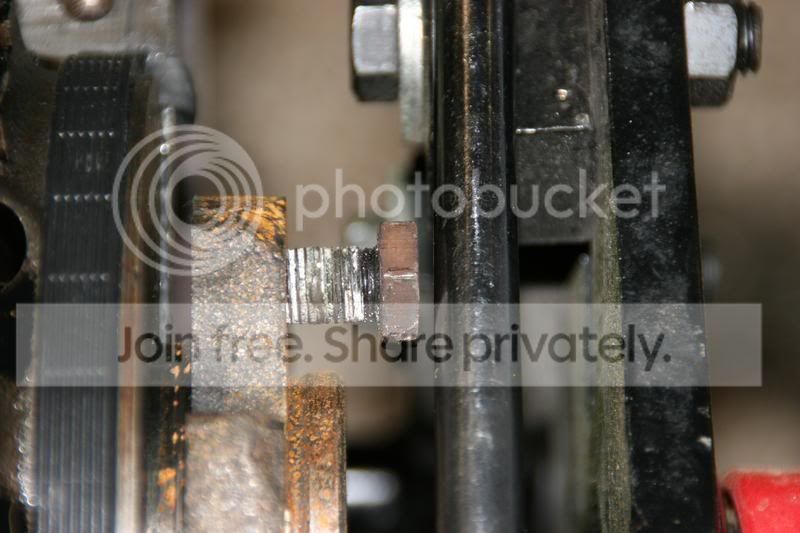

here's a pic of my flywheel bolts compared to a 3/8 drive extension... but i'm replacing them anyway b/c of sweetk30's comment...
