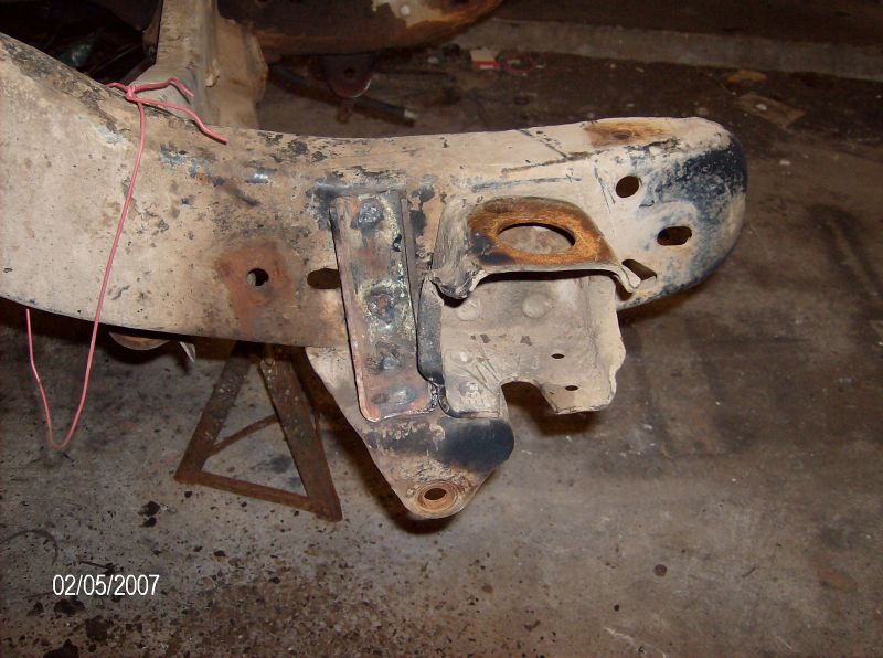

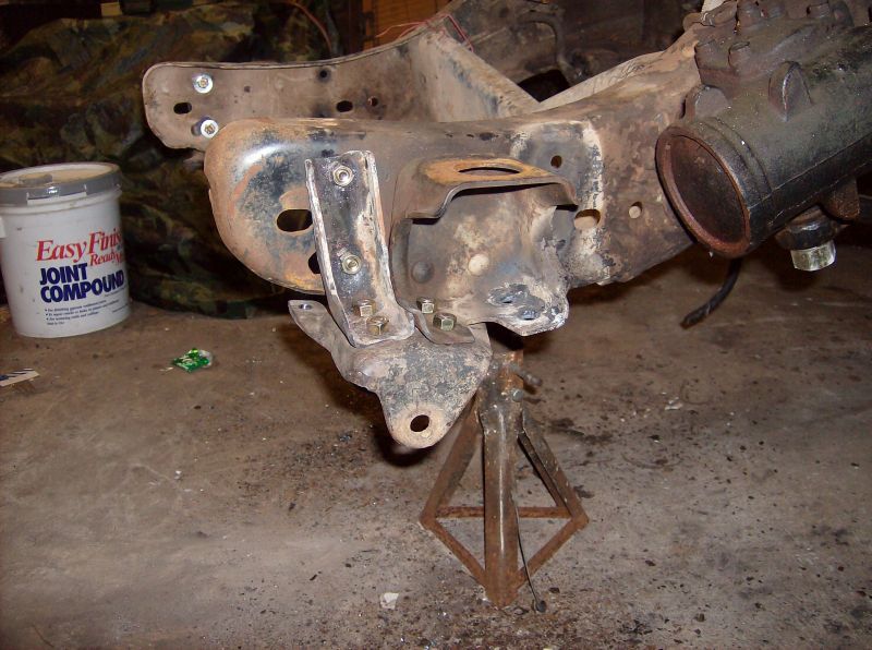

Finally got around to torching through all 16 rivets to make this happen. This is the first part of the truck to actually get put together in months. I've been working on taking all my various donors apart until today. This is just mocked together to facilitate drilling the new holes. will come apart when everything gets painted, washers, lockwashers, all that good stuff. I did find one piece of tech I never saw highlighted before. 3/4" long bolts are just long enough to get the nut on, but if you're using washers under the bolt heads, lock washers, or even just lock nuts, theres not quite enough shank. It really requires 1" long bolts.
before
after

I have thought about the same thing as to how exaclty I am going to do a bumper, I know I will build a tubular front but I am not sure I like the amount of frame there is available to attach to. I am almost considering taking the bracket off and incorporating the bumper brackets between the spring hangers and the frame. Then I can have that plate to attach my bumper to, that way if I ever needed to pull the bumper I wouldnt have to pull the hangers as well.
BTW, dont mind the half assed bolt washer stack thing I got going on, jsut for purposes of moving the truck.
jekquistk5 said:
How much lower is that then stock??? It looks like you got an extra 2 inches or so in there
I think on mine I gained about 1.75". My next step is going to be making the rear hangers to length so that caster angle will be correct.
