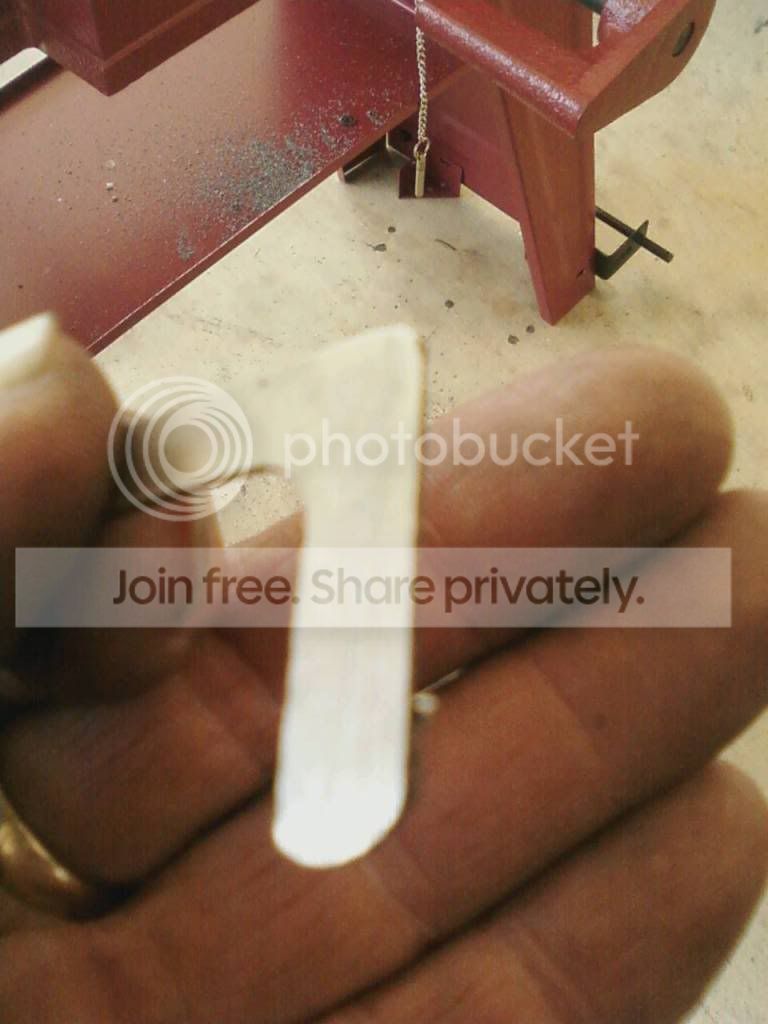

I havnt got a chance to use it yet (still have mods to do to the saw) but a guy posted this on pirate. This was done with the same saw and mods.
