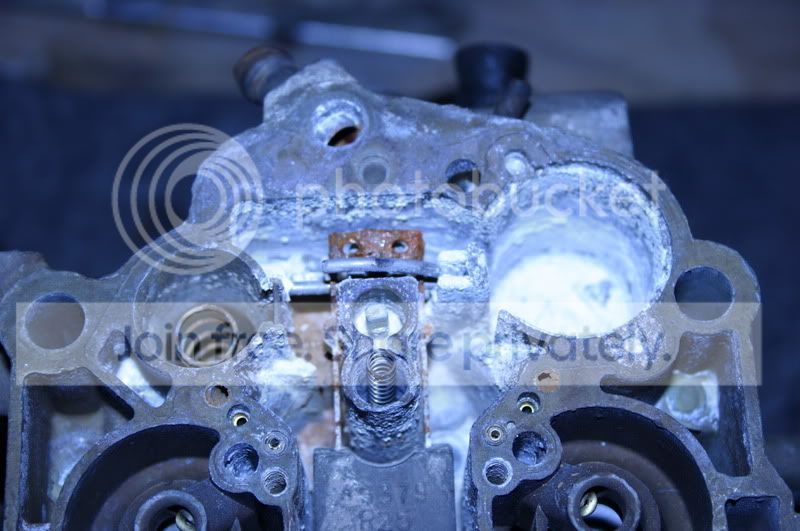

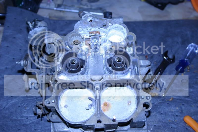

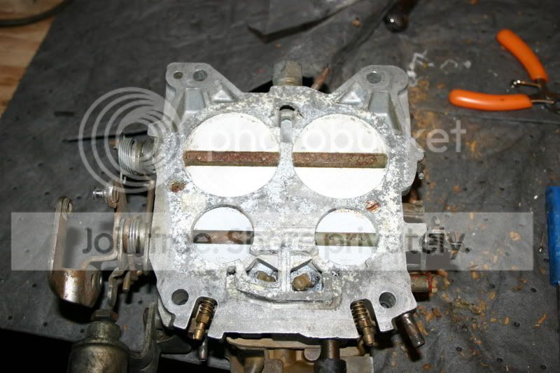

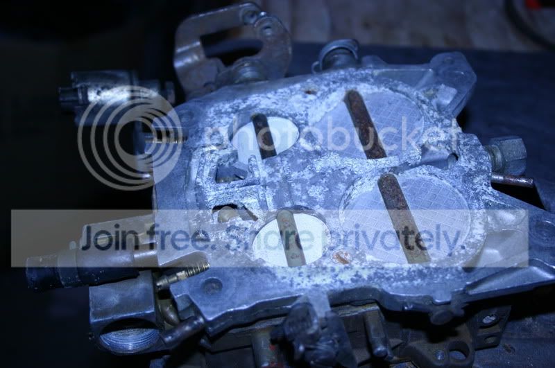

Ok, I have been mentioning the carb that came with the car, and although I have it partially torn down I did grab some pics.
Throttle body looking at the base:
Float bowl and internal passages:
As you can see, it was pretty much just a junk carb. I can't imagine that much water got into the carb while it sat in the back of the Camaro, without having any water stains on the carpet or rear seat. Either way, I now have a carb that came off a 79 Vette, that ought to be good for 100 hp easily.:rolleyes: In all seriousness, I got the choke adjusted today and the car will start from cold without any pumping of the gas. The idle is a bit high at cold, running around 1500 RPM, but I don't want to change it until I get the distributor in and timing set.
congrats... :D
haha, looks like a marine carb! :haha:
I'll have to take a pic of these 2 carters at work... things actually ran and they are HUGE piles of corrosion...
I was blown away with how bad that looked, and I just don't know how long it would have taken to do that. I do know that the carb I put on sat on a shelf for at least 6-7 years before I picked it up. Aside from some bugs, that's the brownish stuff next to the carb in the pics, it showed no corrosion at all. I know the shed it was in is not watertight, so how long did this take to really corrode that far? This carb would have been on the car prior to the ethanol mandate, so it would never have been exposed to ethanol fuel, so it is just baffling.
