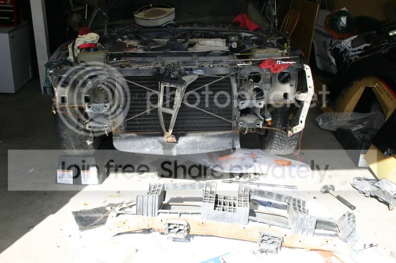

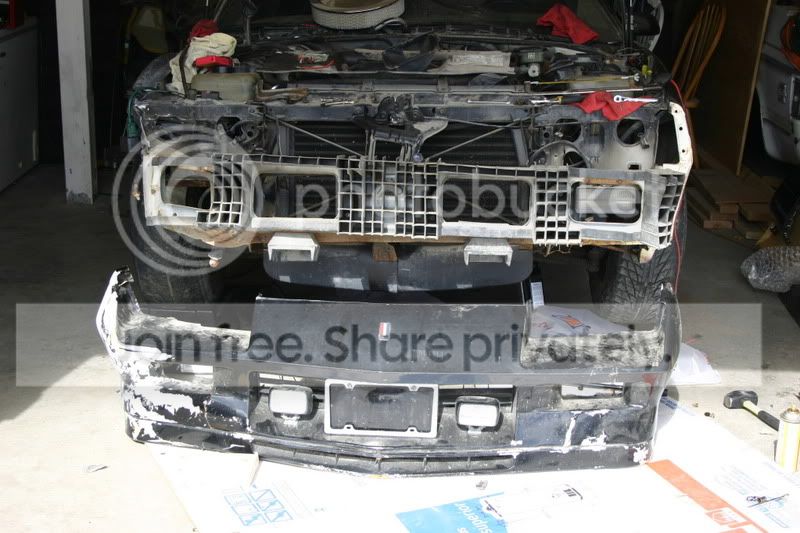

Going to finish stripping computer harness and change oil, as well as remove the old bumper cover and headlight header. I will probably make a stop at the wrecking yard later today to grab a headlight bucket and turn signal lens. May also see if I can find a horn button that is intact to swap with mine.

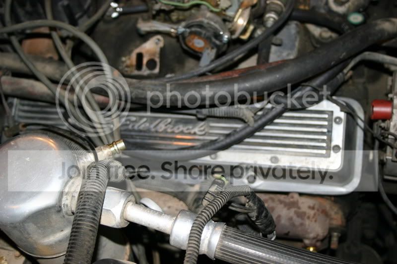

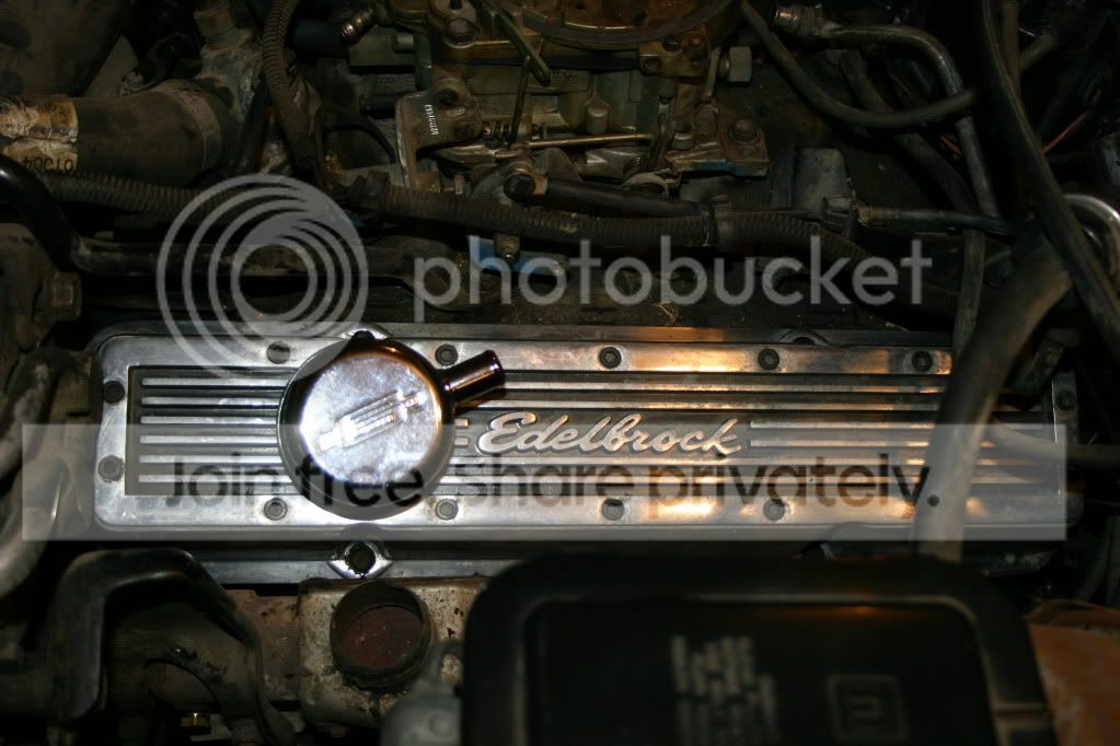

No horn button at wrecking yard, but I did get the headlight bucket and turn signal assembly. Installed the Edelbrock valve covers, but realized I have another issue. The stock air snorkel sits directly above the opening I was going to use for oil fill. I guess I will just locate an nice open element filter housing to install.

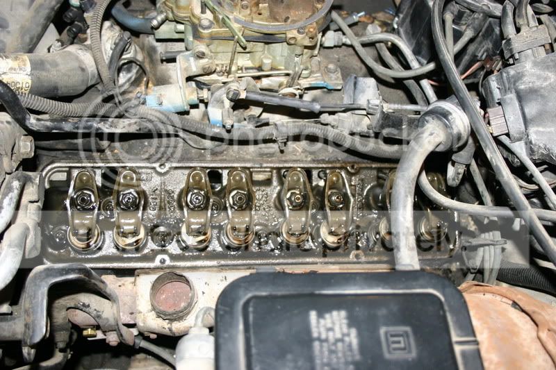

Happy to report that while I had the valve covers off I saw that there is no sludge built up in the engine. A couple pics:

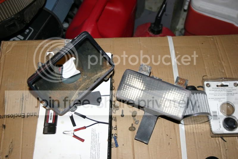

New headlight bucket and turn signal assembly:
The oil cap that is there now will be getting replaced with one that doesn't have PCV in it, but this will work for now. It is internally baffled which should help prevent any oil leaking.

Still haven't gotten around to removing the bumper cover, I just have like 4-5 nuts on the driver's side to remove, but they are a pain to get to. I will get it done soon.

That is just a vent in the oil cap just goes to the air cleaner.

Yeah, the new air cleaner housing I picked up has a provision for the breather, and I will be using it. I picked up an Edelbrock 14" chrome air cleaner housing, and it looks nice on there. Just wish I could have found one of the finned versions to match the valve covers, but that's the way it goes sometimes.

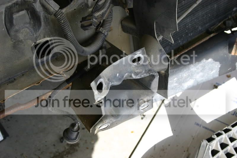

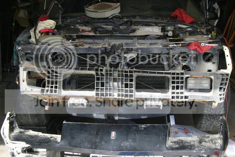

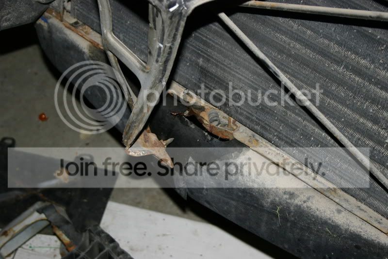

Busy morning already, got most of the front end torn down. Just need to finish removing the old computer harness and I can get the fender mounted up. There ended up being some other damage I hadn't noticed, the PO had clearly hooked up to the hood latch support for towing. It ripped it out of the bottom of the radiator support as well as twisting it. Going to have to replace it and find a way to repair the radiator support.
More work forthcoming, I really want to finish the computer harness today and get that fender mounted up. Going to take a bit of massaging, but I have some big hammers.:grin:
A little, but it is a lot of stuff that just bolts up. A bit of pounding on the frame horn to get it straighter, and probably weld a small patch in on the bottom of the radiator support. Beyond that it is just bolting stuff up, well and actually finding the stuff and paying for it.

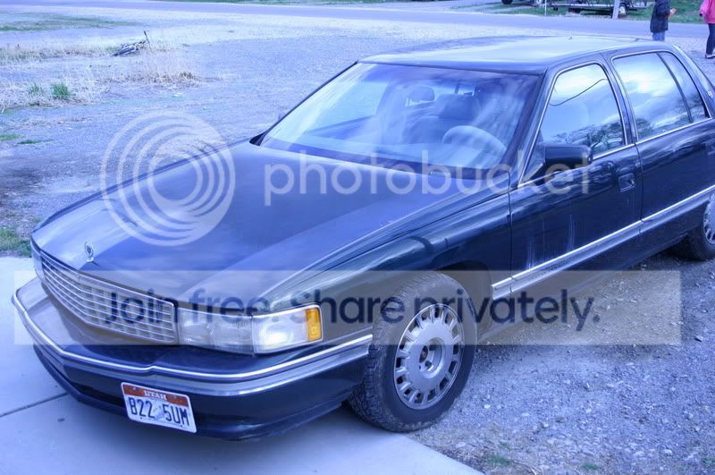

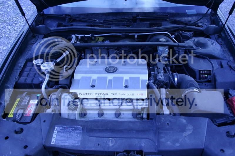

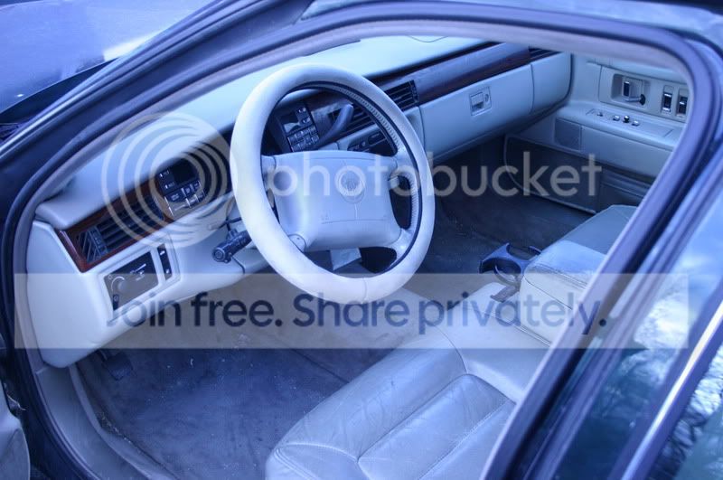

My little brother gave me the latest addition to my fleet, a 96 Cadillac Deville. It isn't in the best condition, but isn't nearly as bad as some vehicles I have had. It has a decent leather interior, 32 valve 4.6l Northstar V8 that is getting 24 MPG right now, power everything, steering wheel mounted stereo and AC controls, remote keyless entry, traction control and a 6 disc changer in the trunk. It doesn't have any keyfobs for the keyless, but I can order them at some point. It has had some issues, hence my brother choosing to get rid of it after buying it for 2k and spending 3-4k on repairs, but should be a decent driver. Pretty impressive to think about having 275 HP under the hood and still get 20+ MPG. My wife likes it, and that is really saying something, so I guess I will just have to get used to it. I took some pics of it yesterday, but got busy and forgot to bring my camera in, I will upload some pics later today.

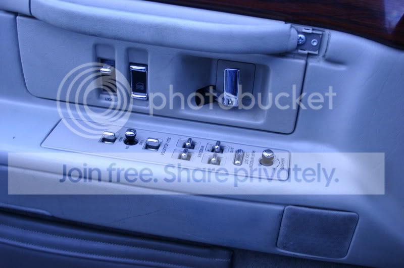

If you need a keyfob I bought one for $11 off ebay when I needed one. Just make sure it has the correct buttons etc that you need (trunk, Driver #1 and #2, etc). Then there is a procedure you can do with pressing the lock buttons in a certain order and during key-on to program the vehicle to accept the keyfob. If you need it let me know I can dig it up. If that vehicle has seat memory pay special attention to get a number 1 and a number 2 keyfob, they are different part numbers.
Yeah I found a couple that have the right buttons, luckily this one doesn't have the seat memory. Just needs to have lock/unlock and fuel and trunk release.
