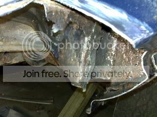

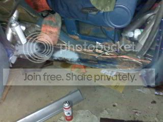

Man, I've been so lazy, and busy... but here are some shots from last week. Of course, its an ever learning experience for me, so here are some news shots
I really should have trimmed more the first time around- I was trying to preserve as much metal as possible, not realizing that a lot of areas were extremely thin already. So out goes the whole damn section.
Treating the damn rust in the upper areas which are a bitch to get to. I sanded as much as I could, cleaned it with brake cleaner, and treated it with rust converter. SEems to hold, Im going to top it with POR15.

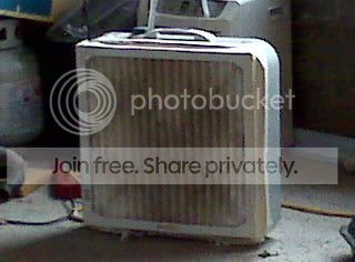

Finally, a pic to show you why you should always wear a dust mask of some sort. I use a n95 particulate mask, You can use something more advanced if you want, but it works for me.
I was cutting and grinding away, and noticed it was a bit "cloudy" in my garage. I thought it was just dust on my glasses.
I had made a poor man's air filter. Especially in winter, its hard to keep the air circulating and clean and still stay warm. I keep this nearby when Im grinding/cutting to keep the dust down. I turned this on AFTER (which Im usually good about, but).. and in 5 minutes, this is what it looks like. Notice the edges.
I never added the inner rocker pieces when I first repaired the rust on my Jimmy. Also never noticed any strength issues. About two years later I cut the whole works out and replaced it all with 3x3 box tubing.
There are no short cuts with rust repair...to do it right takes a lot of time which is why body shops don't want anything to do with it for the most part.
Rene
I wish there was a short cut. There isnt. Just patient cutting, grinding, and welding. I might get to the welding part today I hope. We'll see..
